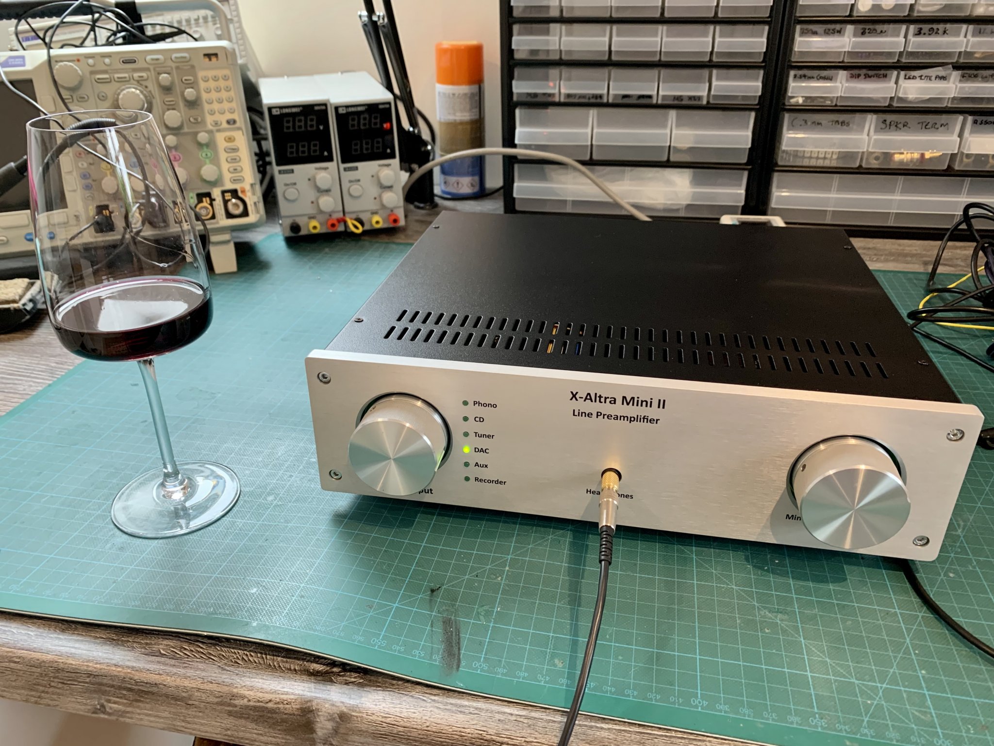

Quick update on the X-Altra Mini II.
The MC/MM phono amp is tested and working very well with tight RIAA EQ as measured on the QA401. Its also very quiet - the MC only stage is under 400 pV/rt Hz (sim).
In general, I still have some work to do on the overall noise. I have mains harmonic peaks on the line inputs fitted with -15 dB attenuators at around -115 dBV giving a measured S/N of -103 to -106 dB (20 kHz BW). On the non attenuated inputs, the mains harmonics are at -130 dBV giving better than -110 dB . I’m shooting for all mains harmonics peaks to be better than -125 dBV at any volume control setting and on any line input.
On line level inputs, the thermal spot noise is -140 dBV with the volume control set to 0 and the same at max with the selected input shorted.
I‘m away until the end of the month, but will pick things up again in May, when hopefully I can crack the problem.

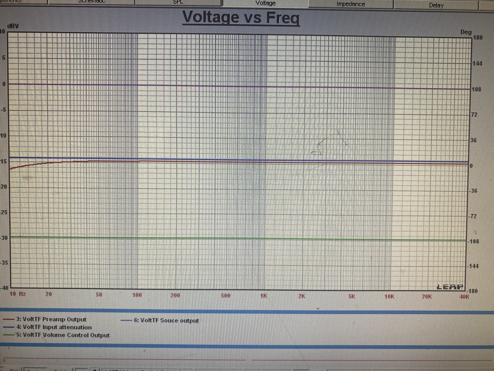

Attached is a simple simulation of the gain structure.
The top purple line is the source input which we can refer to as 0 db.
The blue curve is the output of the fixed input pad on the cd input. The attenuation is - 14.3 db.
The green curve is the output level of the Log 20k pot at 50% rotation and attenuates the input signal overall by - 29.8 db. The resistance is about 9k at 50% rotation.
The blue curve is the discrete line output level -14.7 db at 50% rotation of the volume pot.
ln the case of the un attenuated inputs at a nominal 300mv the discrete line output is of course 15db above the source input level. The level is about 1.7 volts ref an input of 300mv. Perfect for driving a power amp with an input sensitivity of 1.7 volts .

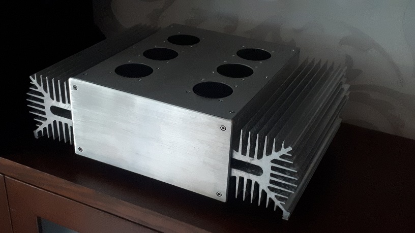

The KX2 housing is just built from recycled materials, of importance is sq and it sounds lovley. Thanks for excellent design and clear instructions. I trust the preamp will be of the same high class.
