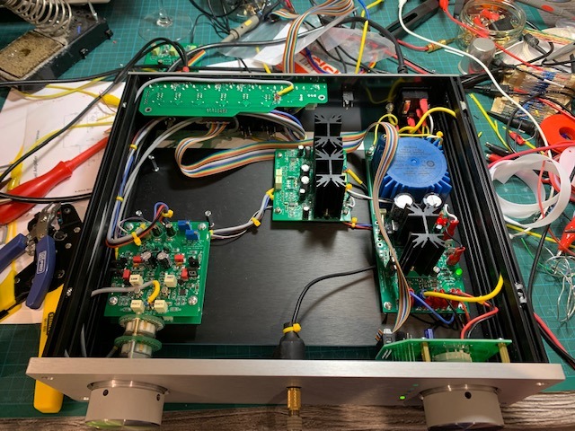

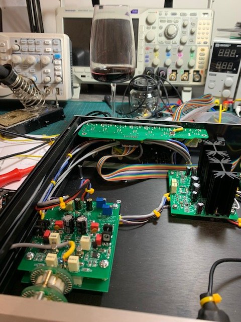

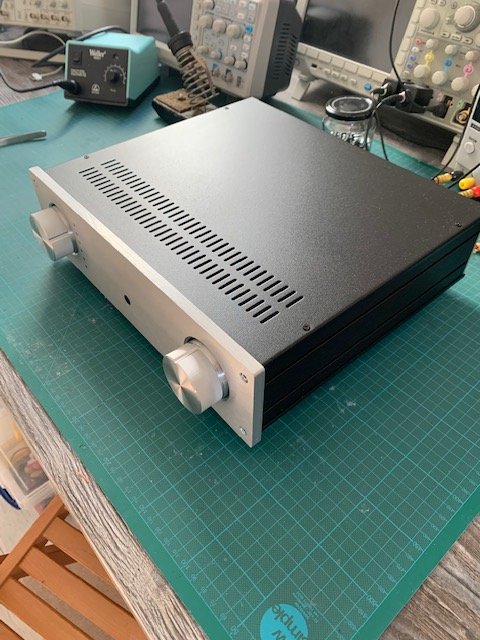

Yes, and a BOM, PCB’s and I’m going to ask Gianluca as Modushop to provide a housing kit with milled/printed f/plate so builders can order if they want. But, I still have a few weeks of work and measurements ahead.Will you be supplying a detailed schematic?
Some updates and the module circuit diagrams posted here https://hifisonix.com/x-altra-mini-ii-line-preamplifier/

(I’ve been otherwise occupied the last week or so, so progress has been a bit slow - hopefully next week I can get back to it. I’ll be ordering a new front panel with printed lettering etc from Modushop as well to finish the whole thing off)
