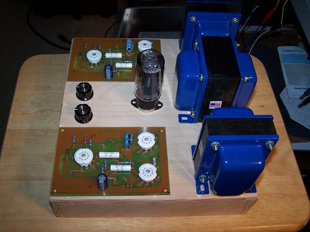

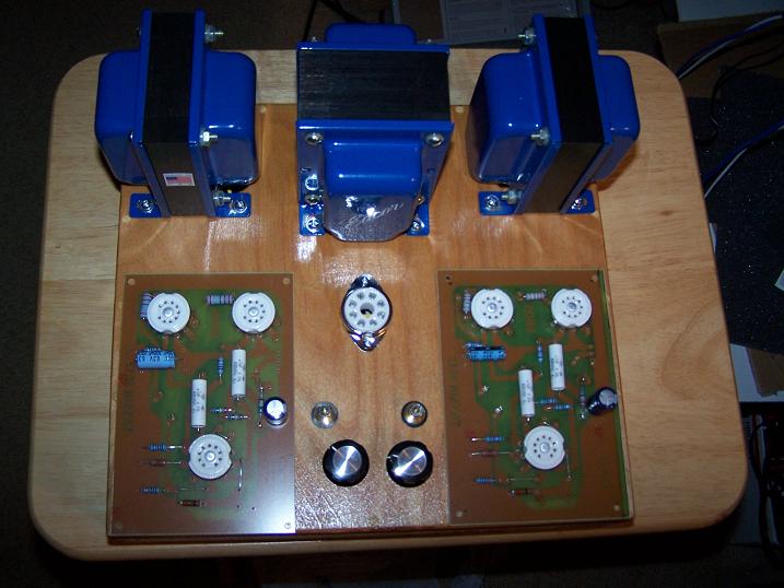

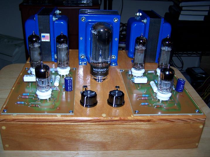

OK people..
Back to reality. I got the amp fired (pun intented) up today and was I surprised at how quiet it was. I had to stick my ear right up to the speaker
to hear a very faint amount of hum. One foot away and the hum is gone. This is the best sounding amp I have! I can now recommend a wooden chassis.

I must admit,
I thought there was going to be three holes with the tubes sticking through on each side and a nice shiny wood grain surface with perhaps a few holes for the heat, the boards mounted on stand offs under the chassis..
Ok the tubes would not stick through as much ... all that nice wood covered up...
Great its working though...

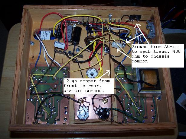

Here's the underside. I changed my mind about using the sheet metal. I'm kinda lazy like that. I ran some test with another PC board amp I have. (Stereo RH-84) that's not mounted on anything yet and got good results.
So I took the easy way out. About exposed wiring on the PC boards. If Dynaco, Heathkit and many others got away with it, I can too. And any way, how else can I get rid of some of the pesky grandkids!

What's your speaker's efficiency?One foot away and the hum is gone.
Are you trying to say that the sound quality is due to wooden chassis?This is the best sounding amp I have! I can now recommend a wooden chassis.
<snip> About exposed wiring on the PC boards. If Dynaco, Heathkit and many others got away with it, I can too. And any way, how else can I get rid of some of the pesky grandkids!
Those amplifiers all had cages for safety and it was a different era, cars without seatbelts, ungrounded metal cased appliances, and radios and TVs with hot chassis. In today's world they would be quickly sanctioned for such dangerous practices. Statistics indicate that the legislated fixes for these issues have some merit.
I understand grandkids can be annoying It only takes a moment for a very unfortunate accident to happen, and even being aware of the hazards doesn't mean it couldn't happen to you as well.
Please do something to address this issue or keep it locked out of reach..
Hi evenharmonics,
Firstly, I have no clue what the effeciency of the speakers is, I got them at A Goodwill thrift store (Kenwood 12" 3 way). If a wood acoustic guitar sounds good, then would it not follow that a wood chassis amp sound good also. {only kidding} The reason this one sound so good, it because I used quality power and output transformers. Also a choke in the power supply.
Lack of shielding was not a problem.

The wood chassis looks great, very nicely done. I've used wood for chassis, both with and without foil lining. Both ways, they're quiet so I'm not sure what the answer is. I line pre s just as an extra in case it might help.
