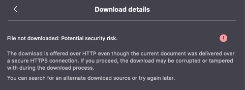

I get a notification that the file is not safe.You can download it from here:
http://files.sure-electronics.com/d...00023.11.2ae5xkvSxkvS6y&file=BDM&BRU_PCUI.zip
@zek So did I. However the file, when unzipped, will run from a USB stick - it does NOT install in the normal Windows manner, so does not write anything to hard disc (unless you want it to). So unzip to a memory stick and run your anti-virus over it for peace of mind.
Better still...I'm now running this on Linux and the security on that is better than government so that's another way to do it. Similarly it may be persuadable to run on a Mac - or set up a small VM on a Windows machine just to run the software.
It's problems like this that persuaded me to jump ship from MS WIndows almost entirely. The only Windows machine I now have connects on to our network but is prohibited from contacting the internet in any way.
