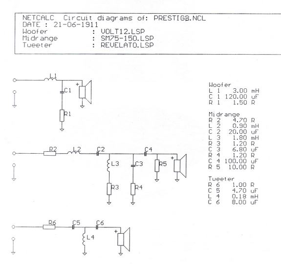

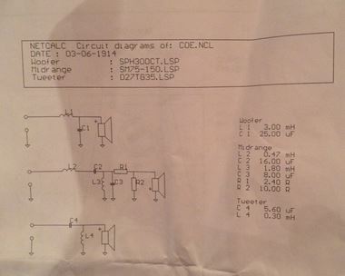

AFAIK, what you SHOULD have is a crossover like below, with a swap on mid and tweeter polarity if we have come to any sort of conclusion.
But capacitor voltage rating is entirely a matter of taste. A 0.5mH aircoil will scarcely sound different from any other sort of 0.47 coil. Now a 1mH coil in place of a 0.47mH coil might be slightly worrying, but measure it. Wilmslow may simply have unwound a 1mH coil to suit.

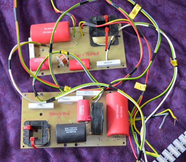

-a cap change to Jantzens cross caps (themselves half the price of Wilmslow ones) has given me the missing bass and a major boost in quality. My speakers now sound sublime and worth every penny invested in them so I have now solved 95% of my problem with more to come with some decent low DCR inductors
-caps should be the same working voltage /type to give equal performance /best imaging
-the inductors are very thin wire /poor quality and are marked with different inductances. I never stated 0.47 to 0.5 was an issue but if their design states 0.47 why not use that value?
-1mh instead of 0.47 is an issue. I didn't bore you with the fact that the value is handwritten on the tape after they have unwound or however they've achieved the value so on the balance of probability it is an error. Dealing with Wilmslow was a litany of Faulty Towers type events that removed any confidence I ever had in them.
I am still using their circuit included in your post. You have never stated on what basis you consider it to be right but FYI it sounds best with all drivers in phase.
As other posters have said, all of this 'boring thread' results from people gettig lousy performance from something that was sold as a fully sorted well designed kit. Whilst I design, build and upgrade valve amps I didn't want to learn the whole new skillset of crossover design /optimisation
So, please peddle off and read some threads you find interesting if you have nothing positive to bring to this one

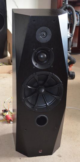

The original complaint from KatieandDad on the speaker was:
Then the active option didn't get anywhere. Bushmeister seems to be doing swimmingly well with that however.
So we are left with crossover and wiring polarity issues for anyone who is still interested in getting the best out of this ATC SM75-150 dome mid design in its various versions. KatieandDad's speaker seemed to have some slope issues in the mid filter, suggesting 0.47mH might work better than 0.9mH to fix a hole around 4kHz. I also suggested that a second order tweeter might work better. This is what Wilmslow did in your version of the speaker. They also threw out that rather uneccessary 100uF capacitor and adjusted the 20uF down to 16uF to compensate. This is the filter with the white background.
Your different speaker (the filter with the brown background) seemed to have a polarity issue between the bass and the mid. The mid to tweeter polarity would be select on test with the different filters and drivers. Very hard to judge by ear and depends on the time alignment. But ++- looked not unreasonable to me.
To your credit, you are now actually rolling your sleeves up and delving. About time. But I'm hard pressed to see how changing a polypropylene capacitor can improve the bass.

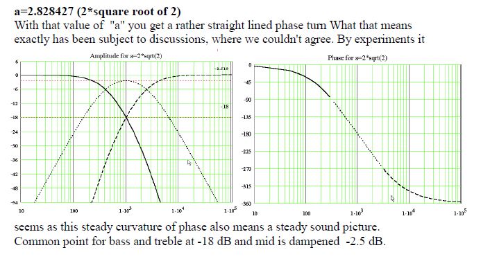

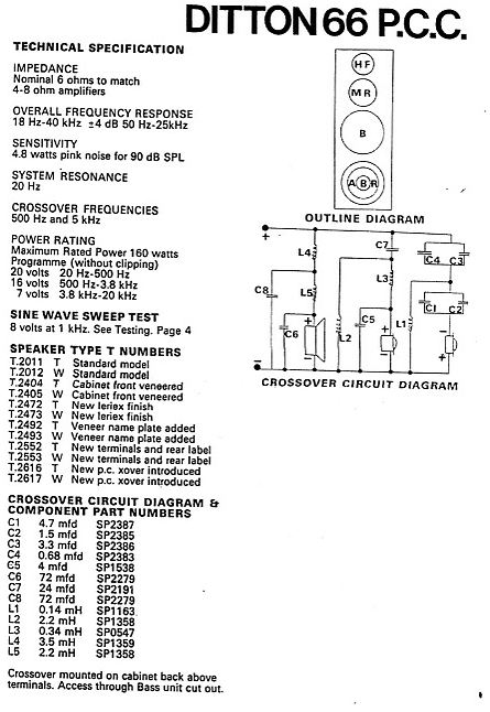

Usual images for clarity. Those filters are actually not wildly different. I think the Ditton 66 is an interesting comparison.

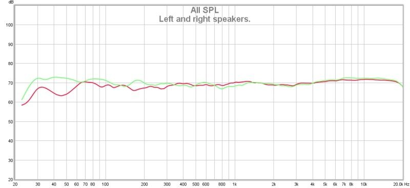

Essentially I have a UMIK-1 which using REW, I moved one of the speakers into the middle of a large room, raised them up and did near field measurements of the tweeter and volt mid, which I then gated to give me as accurate a freq response as possible (these matched pretty well with the published ones).
I then used the minidsp software to EQ them flat, well beyond their pass-bands, so I knew I could try shallower and steeper acoustic slopes with some accuracy. I also measured the bass volt drivers in room, at the listening position so I could EQ out the worse room modes and problems - providing a very even bass.
REW does have a rather cool auto EQ function - where it will generate a set of filters for the minidsp automatically directly from the measurements, but I actually found it more accurate and pleasing to do it manually with as few filters as possible - lots of change/measure/change/measure cycles!
Here is an example of an 'in position' speaker response (so lots of reflections!) just to show the reverse nulls with LR24 crossovers at 550 and 3900Hz. Note the scale too - 5dB, so this isn't bad given it is in-room.
I have since improved on this quite a bit with more tinkering.

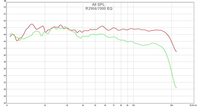

I think the sweep I ran on that previous graph started at 50 hz. Here are some more measurements:
Volt mid range dome (VM752) before (red) and after (green) EQ:
Scanspeak R2904/7000, before (green) and after (red) EQ:
Both speakers at 1M distance in their final resting places in the listening room:
