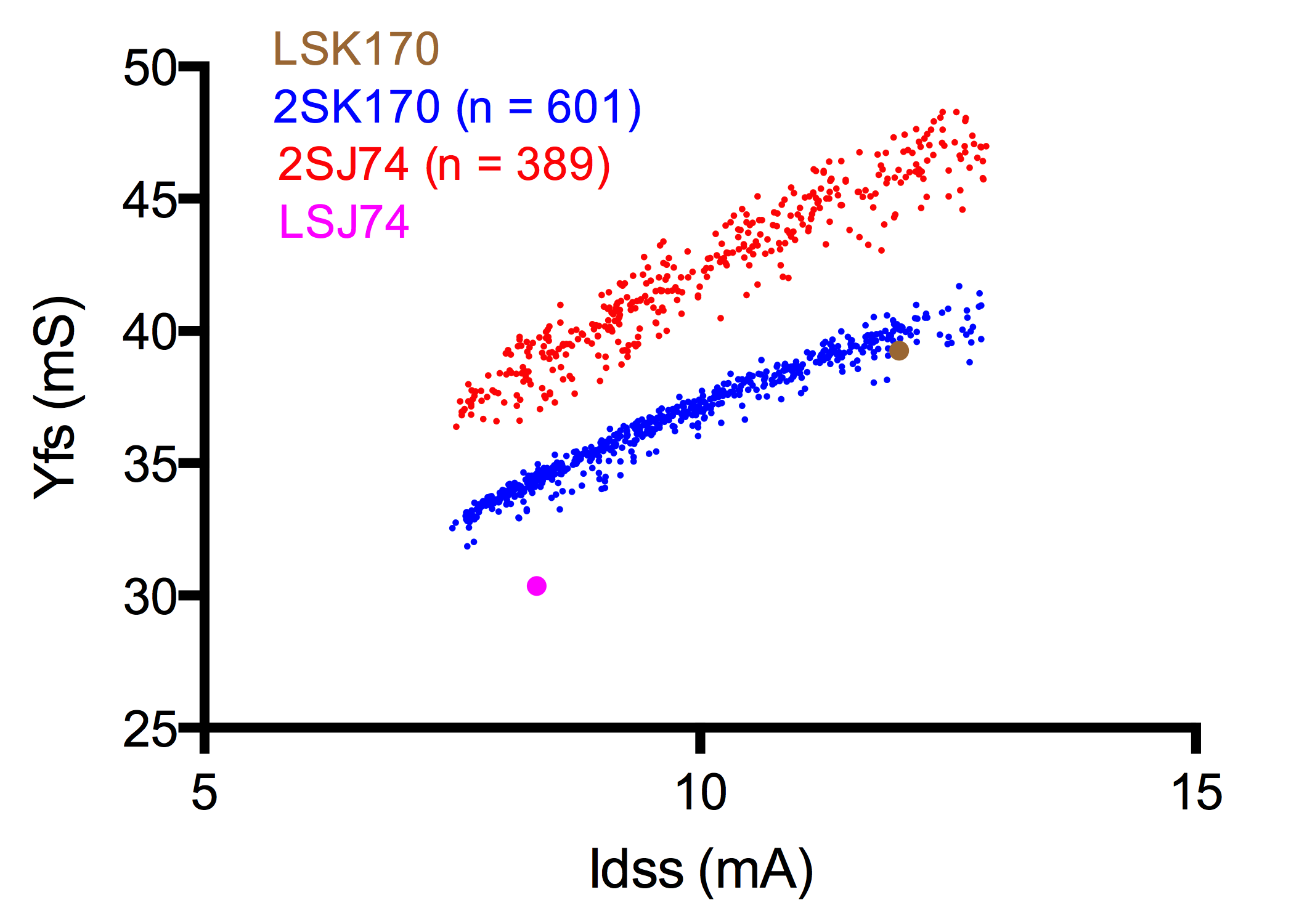

I got the LA issue and FETs today.
LSK170: Idss = 12 mA, Yfs = 39 mS
LSJ74: Idss = 8.4 mA, Yfs = 30 mS

The (one) LSK170 I got is similar to my 2SK170's in terms of Idss/Yfs, but I did not look at the actual traces yet.
The (one) LSJ74 I have is very different from my 2SJ74 having about half the transconductance.
Maybe degeneration of the LSK170 (or 2SK170) will result in better complementarity with the LSJ74.
Difficult to say with one of each of the LTs
IMO the "average" device is of little interest as one of the (few) advantages of DIY is that we don't have to worry about the average and can go for the perfect match
Yes - later.
I have attached a graph showing how they compare to my stash of Toshibas in terms of Idss and Yfs.
Great, this is the way to present the data. Notice how tight the N distribution is compared to the P.
Thanks. Quite interesting. It appears to someone relatively ignorant such as I, that if creating, for example, a LTP with Toshiba's N channel SK170s, that a match for Idss alone would result in a close match to Yfs in the linear range of performance. But not so much with the p channel device. Again, a great plot of data.
Here's a few more samples, from a figure to be used in an upcoming Linear Audio article. 10 of them from a lot sent to me by LS (date code 1213) and 10 sent to me by Jan (no date)- there's really no difference between them, so Jan's lot is probably the same.

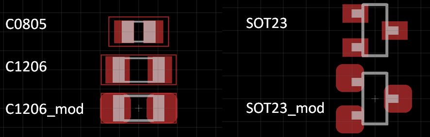

I like to optimize/modify the package footprints in availble libraries for easier hand soldering. I don't have any issues with relatively big, e.g. 1206 packages, but bigger pads are more forgiving against lifting after several solder/desolder steps. Also, 1206 footprints that additionally supports 0805 is often handy.

I'm a fan of the combined 0805/1206 footprints where the available PWB acreage isn't forcing 0805 packages. The downside is "you can't route a trace under the part between the pads". This practice is often already against the "house rules" in many places so little is lost by enlarging the 1206 pads.I like to optimize/modify the package footprints in availble libraries for easier hand soldering. I don't have any issues with relatively big, e.g. 1206 packages, but bigger pads are more forgiving against lifting after several solder/desolder steps. Also, 1206 footprints that additionally supports 0805 is often handy.
Enlarging the SOT-23 pads as shown looks like a reasonable modification. Leave enough space between the two pads so a trace can be run between them.

Yes I agree, about altering pads for the solder process/application, same as wave (back-side) vs re-flow pads. I usually run the pad exit at the same or larger (neck up/down) than the pad. It is all in the libraries. Stock libraries do not know process? I remember back at HP, they had auto pad/geom generation, based on the smt process selection, lots of ample code overlaying the Mentor Board Station core. The RF/lab/mfg teams knew what they were doing. Not sure where HPDL ended up esp. after the Agilent break.I like to optimize/modify the package footprints in availble libraries for easier hand soldering.
The beauty of hand soldering, is that I can break this rule, "no phone call from the process police" since every solder joint is inspected"you can't route a trace under the part between the pads". This practice is often already against the "house rules"

I know how you feel about the "process police". In many cases they seem to aggressively enforce rules that have lost their original justification. But this is one rule (no traces running under the parts, between the pads of 1206, 0805, and 0603 packages) that I'm in favor of, even though the basis for the rule is much weaker for hand-soldered boards than for automated SMT assembly.The beauty of hand soldering, is that I can break this rule, "no phone call from the process police" since every solder joint is inspected"you can't route a trace under the part between the pads". This practice is often already against the "house rules"
