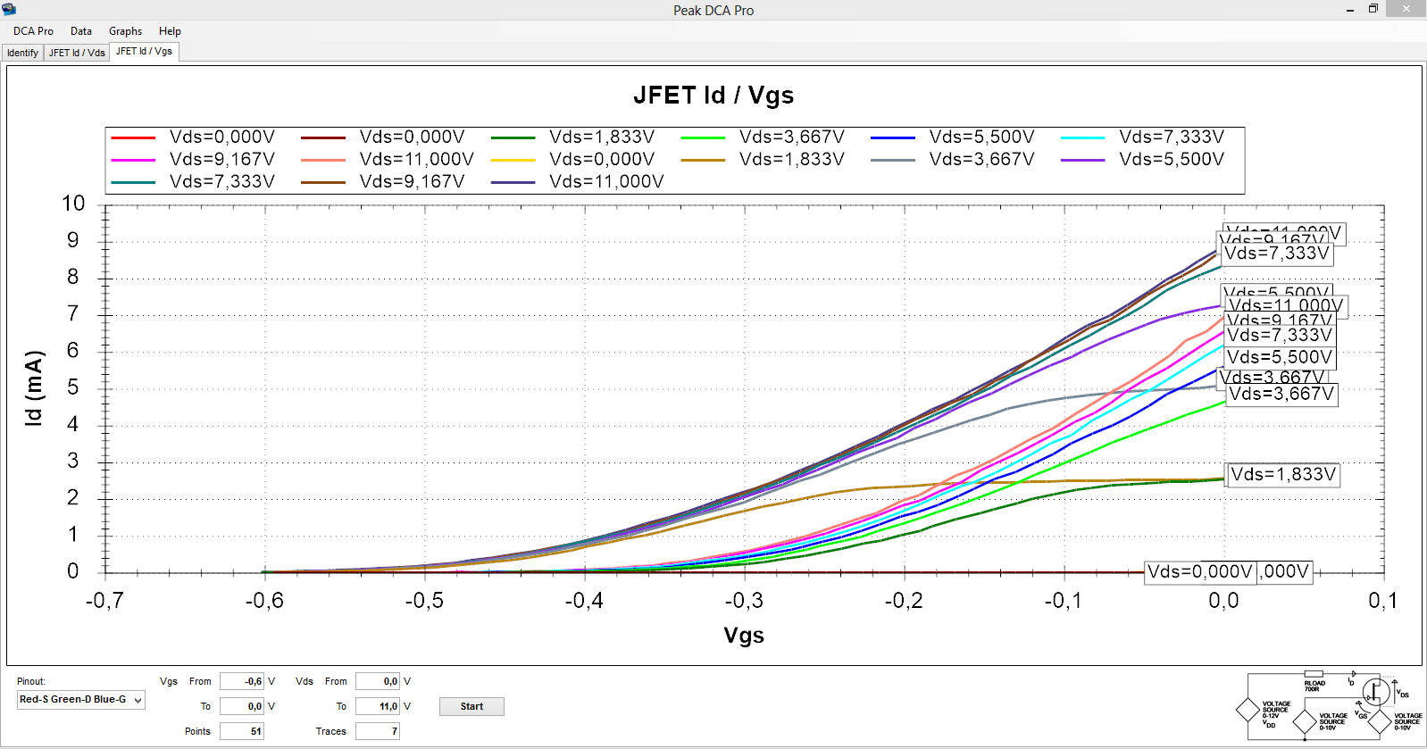

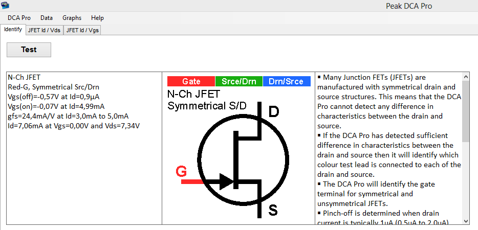

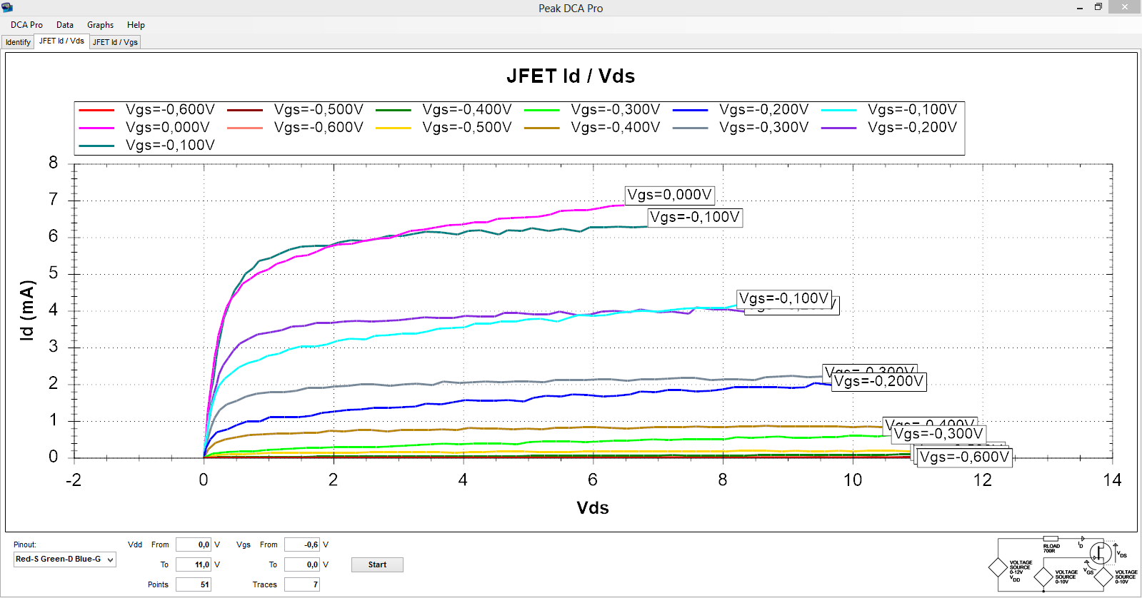

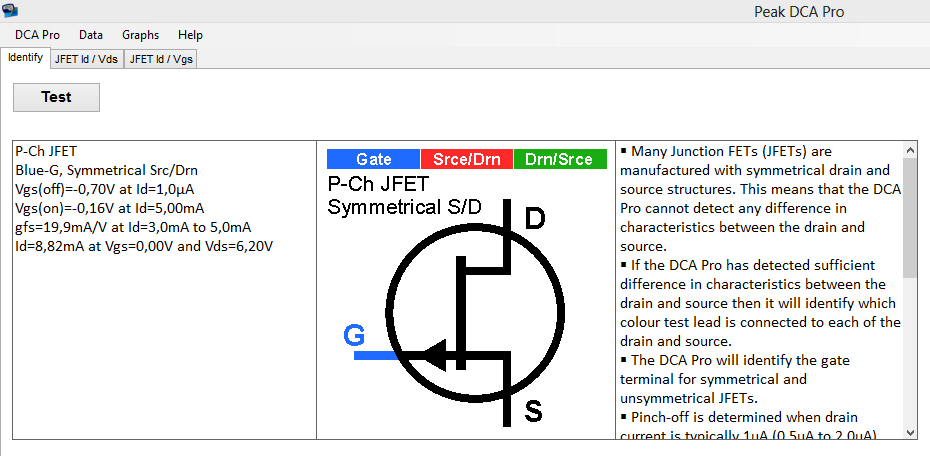

So what does all this mean in terms of performance and sound?
Hard to say without knowing in which circuit they will be applied.
jan
So my tested example is actually 20% above average.
AND according to my database, the typical Yfs of 2SJ74BL is around 38~40mS.
A typical 2SK170BL is about 30~33mS.
Patrick
John Hall gave me a small bag of each grade of LSJ74's so maybe I could get numbers for you. I mostly design for a given drain current and the gm variation is quite small across grades at say 1 or 2 mA Id. I would find a conformance to square law comparison more interesting.

A little bird told me that the typical Yfs for the LSJ74B is 22mS.
