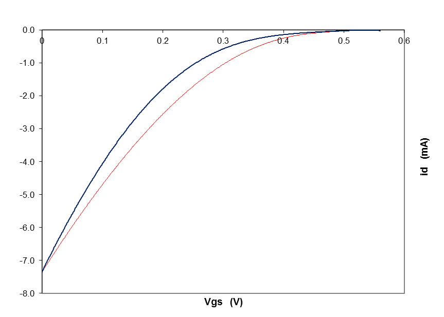

Here is the first measurement of the LSJ74, as promised.
The sample came from Jan Didden of Linear Audio, and has an Idss of 7.34mA.
A 2SJ74BL was pulled from our data base and plotted side by side for direct comparison.
Test Vds was 9V, at room temperature.
Blue line is Toshiba, red is Linear Systems.
As you can see, Toshiba's have significantly higher Yfs (38mS compared to 27mS at Idss).
Also curve fitting reviews quite a bit higher (normalised) 3rd harmonics.
A pair of LSJ74s are on their way to more accurate THD analysis using a R&S UPV.
So, close but not quite the same.
But the characteristics displayed by the LS jfet are still very, very good, and will work quite nicely in the Nelson Pass and similar circuits. Essentially no other devices will do that.
My understanding is that noise performance of the LS parts is very good.
You see my point we now have 4 variables 2 74s 2 170 and 4 curves . Patrick has shown that the 2sj74 and 170 are not totally matching curves I now wonder how the LS curves compare to they . they are different but are they closer to each other than are the orginals ? Or does a mix and match produce better matched pair curve wise ? Then again it mater more in some applications than others as 6L6 has noted .But the characteristics displayed by the LS jfet are still very, very good, and will work quite nicely in the Nelson Pass and similar circuits. Essentially no other devices will do that.

Hello Patrick,
While I don't want to doubt your results, I note that this is one Toshiba compared to one LIS. Maybe another Toshiba with another LIS would show a quite differnt picture.
We should compare an 'avarage' Tosh against an 'average 'LIS in my view.

My record of Toshiba's does not show a Yfs variation of 25% between devices of similar Idss. 10% maybe.
So while your argument is correct, I do not believe that the Yfs are comparable even if I have a bunch of LSJ74s to measure.
And you were (past tense) the few person who had a large bunch of those.
Perhaps we should just wait till Linear Systems put up a proper datasheet.
And then we shall see.
