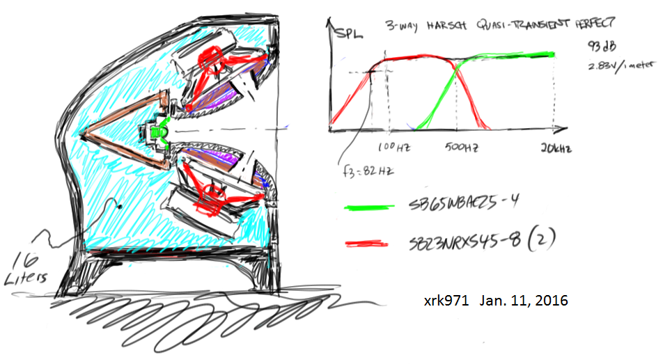

This is the current progression of the design for the bookshelf point source horn:
Simulation with SB65WBAC25-4 for mid/tweet and SB23NRXS45-8 (qnty 2) is giving this at 2.83v:
524495d1452600291-bookshelf-multi-way-point-source-horn-xbush-01-sb23nrxs45-8-spl-sensitivity-2.83v-50mm-12mm-thick-65hz-hpf.png
Max predicted SPL based on *thermal* limit of woofers is about 110dB at 22.8v for woofers.
More info here: http://www.diyaudio.com/forums/mult...lti-way-point-source-horn-10.html#post4579092
At 2.83v it's at about 93 or 94 dB - pretty loud. But the horn loading is so good, the little 82dB sensitive SB65 is only moving 100 microns on the diaphragm. Given xmax is 2.5mm, this is only a small fraction of linear travel so expect low HD. For the woofer, it is moving only 0.75mm and with 6.25mm xmax, we should also expect low HD as well.
Here is predicted cone motion at 2.83v:
524497d1452601364-bookshelf-multi-way-point-source-horn-xbush-01-sb23nrxs45-8-spl-displacement-2.83v-50mm-12mm-thick-65hz-hpf.png

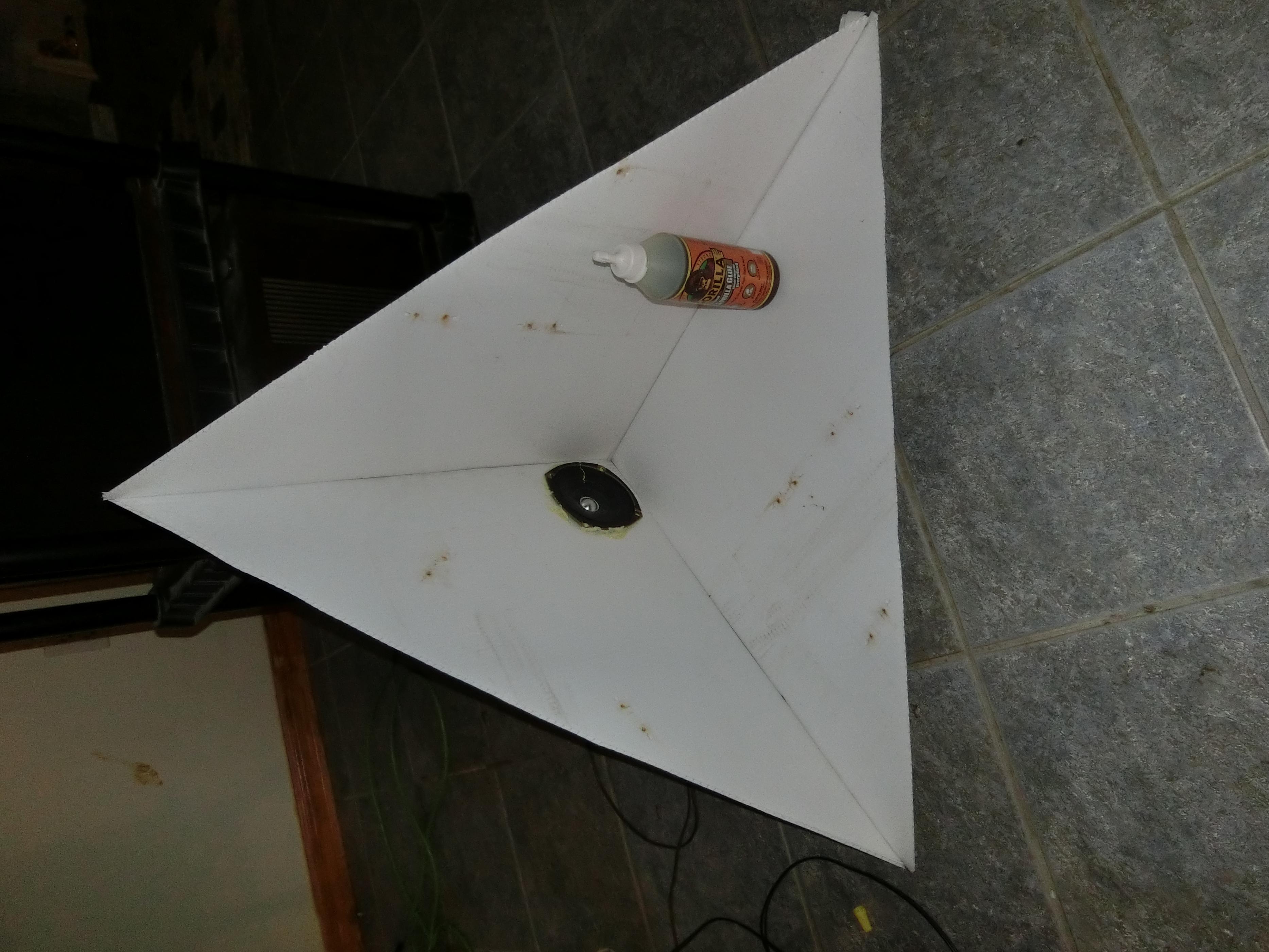

Meanwhile I could not wait for no stinkin' plans so I did my usual prototype with pilfered coroplast (two signs worth), some tape, the two above mentioned $3 drivers and some Gorilla glue. Models like crap on Hornresp, sounds ok. No bass. As installed in the photo I "claim" (darn patent language!) a $6 pair of speakers that is some mongrel of dipole, prism (concial) horn and full range :) A touch of bass is there because (?) floor boundary. More refined product shall have to wait.
Here's your waveguide :
