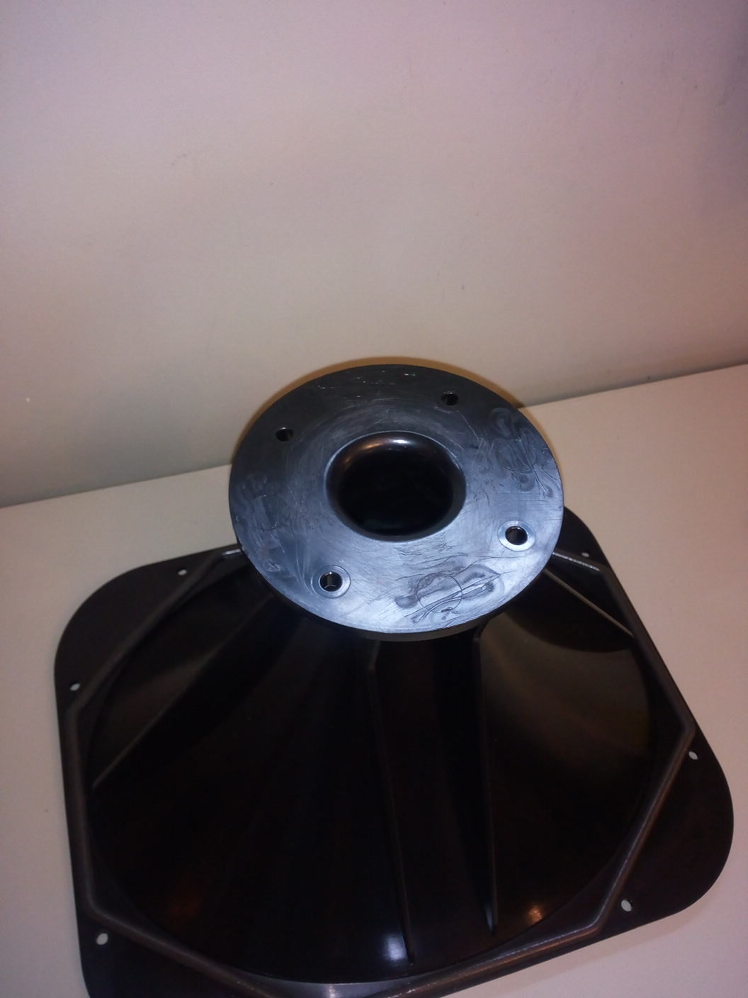

Just received my horns in the post - looking at the exterior - I am thinking 4 x 4 inch woofers would fit nicely between the ribs on the exterior. My plan is to use two part epoxy putty to connect the woofer to the curved outer horn surface.
I am very impressed with the build quality of these. Very solid.

I'm not trying to be condescending, but you keep asking the same questions about how to build a not-quite-synergy in synergy threads and the answers haven't changed. I think xrk hit the nail on the head. The ports make the apparent mid source much smaller than the cone, along with the other benefits that myself, Patrick, and xrk have mentioned. I'd think with the mids exposed the fr would be worse with greater inconsistencies off axis.I thought there was more to it than that. Sorry. If that's all of it, I can achieve a 2nd order LP with two passive components. Using a 1" fullrange, I could also meet the minimum spacing requirements as well.
Why not try it? Should be easy enough to knock up a prototype. Who knows......maybe it will work really well.
4 inch isn't exactly a "woofer"
I would highly discourage epoxying a driver directly to WG. You need to be able to move and redo. The glue is one time and ruins the driver.
Try using tools to remove the ribs. Then use industrial adhesive like Liquid Nails to glue a plywood plate to each wall to form basis for woofer mount. If clever you can get a larger woofer than the WG mouth as injection hole is maybe 20% of Sd.
Basically enshrine your plastic waveguide in a four side plywood pyramid as basis of your synergy.
Make sure you use VOC compliant LN. The other stuff might melt your WG.
Then you can properly cut a ring groove for the surround to clear and cut a nice port with a Dremel tool after all the LN dries.

I'm going to try it with this one:
0005 XT1464 - Coaxials XT1464 : Eighteen Sound - professional loudspeakers
Do you have any tips for transitioning the 2.5" driver into the 1.4" throat?
I was going to use modelling putty to gently flare the 1.4 inch opening out to the size required over a cm or so of depth...

For throat you want to remove any sharp corners. I would start with a file and sand paper/Dremel tool to put a 0.2in or so radius smooth lip on the WG throat. Then take a disc of ply or plastic or whatever that is deeper than the half roll surround at xmax but keep as thin as possible. I am guessing 5mm thick is good and cut a circle exactly larger than outer dia of rubber surround. Lay this spacer and center on WG flange that has now been filed smooth. Drill holes and mount driver. Use thin rubber or Eva foam gasket to seal it. This is where foam core is handy. I used it as the spacer and gasket in one. Important to make sure surround doesn't bump. That adds distortion.
Now the fun. Test the WG and SB65WBAC24-4 in waveguide. Put a thick blanket on back to prevent reflections from back messing with measurement.
You may see a pretty nice curve. In all likely hood you will get +10dB gain up to about 3kHz. Will start to see dips and roughness and typical power falloff of -12dB from there to 20kHz.
Now wherever you see a sharp edge or roughness in horn profile at driver interface you can sand and file smoother or use a dab of putty and stick it in and re measure.
Once you are happy with HF then move onto adding woofer ports. You also have reference now of before and after injection holes. Really they don't impact HF much if done right.

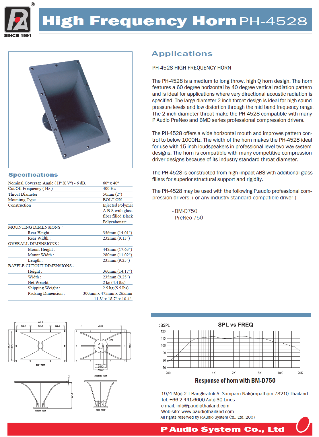

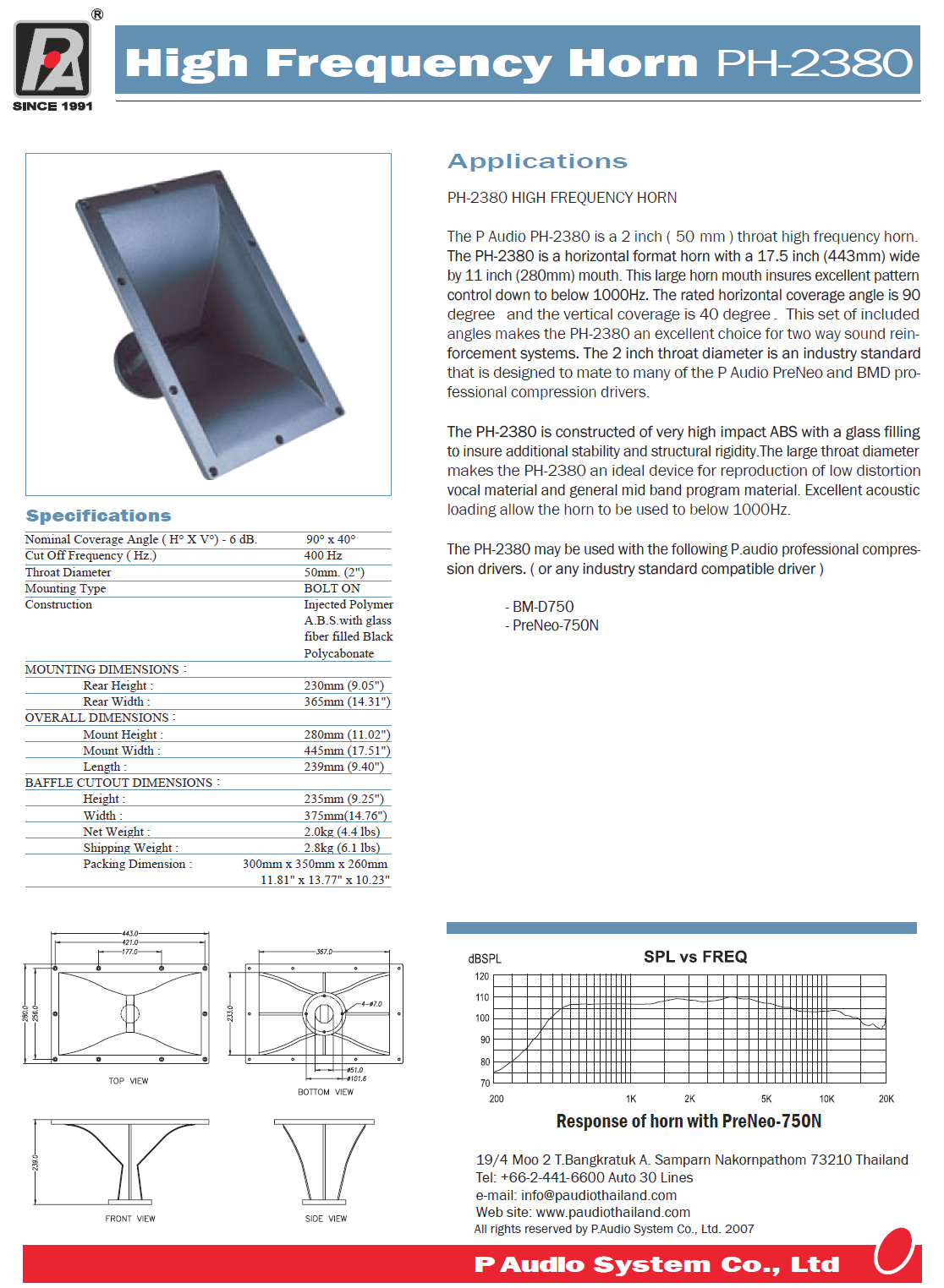

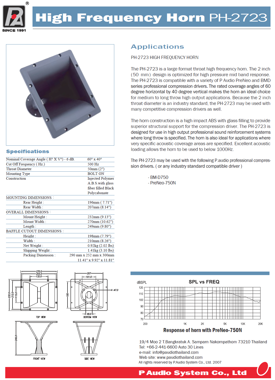

If you want to look at 2" throat in future there is below three possibilities at low cost in UK, if I had the time would like a pair of the first or second one as trial for 10F or TC9FD.
P-Audio PH-2723 2" Horn Flare 60 x 40 Dispersion 24.95 IN STOCK (9 Jan 2016)
P-Audio PH-4528 2" Throat Horn Flare 60 x 40 Dispersion 31.75 IN STOCK (9 Jan 2016)
P-Audio :: P-Audio PH-2380 2" Throat Horn Flare 90 x 40 Dispersion ONLY 22.68 IN STOCK (9 Jan 2016)
Byrtt,
Thanks for the excellent info!
I decided on the SB65, as I felt the larger 10F may be a bit of a squeeze into the 1.4inch throat of the horn I have chosen.
I also chose the 18 sound one as it has a fair amount of measurements documented online and appears to be a really nice CD horn.
I have now routed out a nice 1/2 inch curve on the throat entrys and then sanded and polished the throats to get a smooth transition. I have measured the start of the throat transition as 55mm (2.2 inches) which - should put me just at the edge of the cone and therefore be a snug fit (excluding the surround)
Just awaiting arrival of the SB65s then I will cut a gasket and get measuring!
bushmeister,
You right 18 sound have good documentation and good chance it will shine combined SB65WBAC25-4.
Both 5th element and xrk971 have had good experience that full ranger so look forward follow your build progress and nice idea.
Wow picture with modification for throat transition looks super pro tooled as it was ab fabric.
