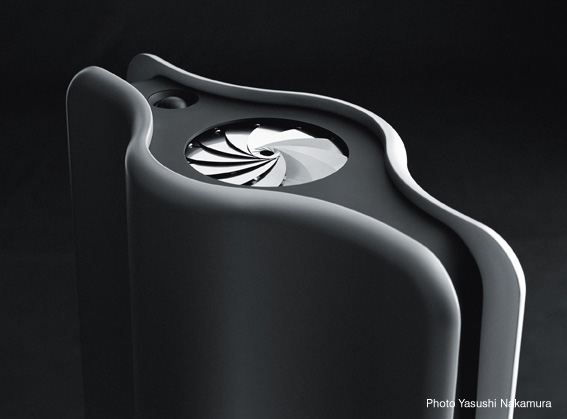

Also I wonder how the small BMR's would perform in a small side and top vented enclosure (complete with wedge shape lens) for dipole operation for open baffle speakers or omni hybrid in a similar manner to the new Steinway Lyngdorf tweeters in their new cheap 'n' cheerful mini monitors.
Steinway Lyngdorf - AER (Ambience Enhancing Radiation)
