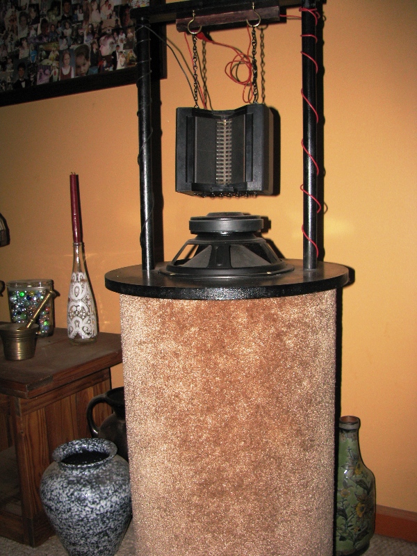

Rightfully so. A rear facing tweeter is a misconception for Pluto. It does not work and what should it do anyway ?Linkwitz completely skipped possibility of Pluto with rear facing tweeter.
If you want even wider dispersion you need a smaller tweeter like the one I have used.
If you really want even wider dispersion, much higher power handling, and much lower distortion skip the smaller tweeter, you need a design like the one I have used:
Ahhhhh - another fan of the Sonotube!!!
If you haven't finished the speaker and if there is room an idea is that you raise the distance to the middle somewhat such that you can invert one of the bass drivers to reduce distortion.
