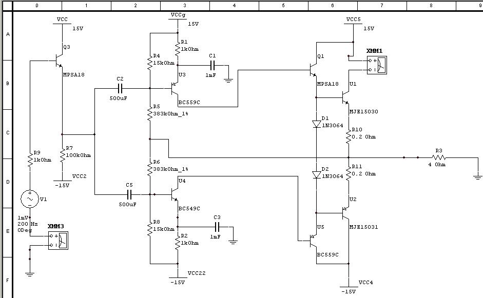

AC input impedance depends entirely on R7 and the input impedance of the gain stage, biassing of your gain stage. In effect the latter is hie of Q1 in parallel with Hie of Q2, hie is approximately 0.025/Ib, Ib assuming equal beta of Q1 and Q2 is roughly (((15V * 330)/(330 + 200))-0.6)/((beta + 1)*1k). Depending on beta it comes out on the order of 150-450 ohms. R5, 6, 12 and 13 end up being far larger than that regardless of feedback and can safely be disregarded. Once you multiply this with (beta+1) of Q3 and add hie of Q3, you get about 15-135k(depending on all the betas) in parallel with R7. It comes out as 9.7 to 18.9k, for beta is between 100 and 300.
Are you saying I can reduce the values of 330k and 200k resistors?
another question: my book is saying I can remove R7 (on the input state) and C6. This should cause a dc offset at the signal source, witch is no good for the source right?

if you replace by the T model, neglecting Early effect, you can see that the input impedance depends also on Re = Vt/Ie ~ 8.6Ohm. This is very low. However, we'll have: Rin = Rb // (Bf+1)(RL+Re) ~ (Bf+1)*RL, because Rb is very large.
Really? Rb in your case is 22k (R7), and Re is very small, but what is RL, which is in series with Re? You conveniently skipped that one in the equation. RL equals the input impedance of the next stage, in parallel with impedance of current source, the latter is infinite, hence RL = Rin of the gain stage. And that would be on the order of 200 ohms. Multiply this by (B + 1) - roughly 250 for your transistor - and you get ~50k. Obviously 22k is not at all large compared to 50k! 22k || 40k ~= 14k or so. (B = 200 is assumed).
You get 250 ohms for the gain stage as (B+1)Re1 || (B+1)Re2 || (resistances). This is quite approaximate as Q1 and Q2 are not going to be working in small signal conditions, but as the signal changes you get increase of the first term and decrease of the second, and vice versa, and also, the feedback resistors would be seen as Av times smaller. They are quite large, though, so even for large Av they are still on the order of hie. So ROUGHLY we can assume it's on the order of 250 ohms +- 6dB :)
The exact value can be calculated by calculating the approximate imput impedance of the output stage (in order to calculate Av of the gain stage) but this will be quite inaccurate, as small signal conditions are not going to be how these stages are used.
Still, this little exercise is enough to see what the approximate input impedances are. This is needed to calculate the proper values of the capacitors, and I also used it as an argument to demonstrate that your feedback resistor a couple of drawings back, was not well chosen.

If you look at my equations, input impedance between B and E, known as hie in the pi model, of the BJT is given as Vt/Ib, which is precisely equal Re(B+1) because Ie = Ib(B+1). Only that depends solely on biassing and temperature, you cannot neglect all the other components.
Removing R7 and C6 would pass the DC bias current through the source, which would create a DC offset across it. How bad that is depends on the source. For a dynamic microphone, it is NOT a good idea.
Values of the 200k and 330k resistors and resistors in emitters of Q1 and Q2 dictate DC bias, and to an extent, AC input impedance of the gain stage. 200k and 330k form a voltage divider. The voltage at the bases of Q1 and Q2 defines the saturation limit of the gain stage, hence it's maximum output swing. In other words, voltage on the emmiter resistors of Q1 and Q2 is subtracted from the power supply, what is left is your maximum output swing for that stage. In order to increase it, but leaving all other things the same, you need to lower the voltage lost on these resistors at DC, but keep the current through them the same. In other words, the resistors need to be lower. Still, to maintain good thermal stability, you still need ~ Vbe on each. This Vbe / Ie will give you their value.
In order to maintain ~Vbe on each resistor, given large B of Q1 and Q2, you need ~~2*Vbe between the base and emitter of Q1 and Q2 respectively. Since you know that Ib = Ie / (B+1), you now have enough data to calculate the replacements for the 200 and 330k resistors. However, because B has high tolerances, you are better advised to keep the voltage on bases of Q1 and Q2 approximately constant. This you can do by making the current through the resistors much larger than Ib, say 10x. This will in turn mean smaller resistors. However, the resistor between B and E you can reduce quite freely given it is in parallel to hie of the transistor, which is on the order of 1k or less. The resistor between output and base is best kept large, because it will be seen as Av times smaller due to feedback. Reducing the voltage drop on the emitter resistors to an acceptable minimum also means that the feedback resistor will be much larger than the resistor across B-e of Q1 (or Q2), which makes the condition that the feedback resistor be high, easyer to satisfy.

PS: things are getting clearer now, your last post really helped a lot. I'm planning to remove all capacitors on this circ and make another bias on the high gain state using one diode. Also, I'm planning to put emitter-followers between gain and output states, to minimize loading effects of the output state on the gain state. I think the main problem will be the DC offset at the output, but I'll think about later.
I've made the changes you said. But I think the DC bias current at U3/U4 got too low (1uA!), so the gain is about 100times. What do you think about it?

If you place a Vbe multiplier between the collector of U3 & U4, this might solve that problem and allow you to adjust the bias current through the outputs via a pot. As it is any more than a tiny amount of current through U3 & U4 will produce too much bias across your outputs. (providing the forward bias voltage of the diodes is higher than the Vbe of the output transistors) Of course you would be adding another transistor.:rolleyes: Then you could replace the diodes with a resistor.;)

I think that your biasing is wrong because you now have less than the Vbe threshold voltage on the 15k resistors, hence both U3 and U4 are in cut-off. Time to review conditions for a BJT to be biassed into the active region? Also your 1k resistors in the emitters of U3 and U4 must be changed in accordance to the bias voltage on the bases to keep the same bias conditions, which I think I have written about 4 times already.

'That' problem is due to wrong biassing of U3 and U4. 4 diodes could be put between U3 and U4 collectors and the two diodes present in the schematic now could be replaced by one resistor.
Still, given 6 transistors to work with, it would be a better idea to have the gain stage drive the output stage directly (without followers) as it did before, but put a decent follower (it comes down to replacing both U3 and U4 with a darlington pair each) in front, to get usable input impedance while being able to increase the gain stage bias current, in order to get better gain. Gain will still be limited by the feedback arrangement, but that could be separated into DC and AC paths to help this some.

DC Potential at u3 emitter: 14.998V; DC Potential at U3 base: 14.472;DC potential at u3 collector: 3.23 (not stable). Isn't it active mode??? For U4 the values are almost the same. Also, if they were in cuttoff, they wouldnt amplify the input signal about 100 times...
About the emitter followers, why do you think it's not good putting them between gain and output stages? I've read in a book they're good to minimize the load effects of the output on the gain stage...

It is BARELY active mode. 14.998V at emitter means 0.002V across the 1k resistor, means Ie ~= 2uA! I'm sure one of your books also mentiones somewhere that for minimal thermal stability you need about Vt on the emitter resistor for this sort of biassing, preferably much more (about one Vbe)? You also need some sort of current to properly bias your output stage out of class B (however, given the noonlinearity of gain close to the Vbe threshold, you could alsmot call it class C). In order to get good distortion characteristics, it would be advisable to get at least half of the maximum Ib of the output transistors to be the bias current of the gain stage. For class A operation of the gain stage under all conditions, it would be advisable to have a bit more than maximum Ib of the output stage as the bias current. You also have to keep in mind that you need to calculate all that using minimum B for the outputs. Given a 4 ohm load, and assuming full output swing, you need 3.75A peak output current (of course, the output will never be able to swing that high due to Vbe losses and biassing losses in the gain stage, but better to be safe), assuming minimum B of 50 of the outputs, you get maximum Ib of the output as 75mA. If you let that much through the gain stage as DC bias, The transistors will dissipate too much (1.125W each) so we have to lower that. 200mW is at the edge of reliability for small transistors such as you are using, this limits the bias current to about 13mA. Assuming 1 x Vbe drop on the emitter resistors, for that current these resistors need to be 45 ohms - use 47 ohms as the closest standard value.
From 13mA bias current we calculate the required Ib, which is (assuming B=200) about 65uA. I will leave it to you to calculate the proper resistors from B to Vcc and from output to B, given 65uA base current and 2 x Vbe on the resistor between base and Vcc.
From 65uA we can calculate hie of the transistor as 384.6 ohms. Since you have two effectively in parallel, your input impedance will be AT MOST half that, ~192 ohms. In reality, you also get the feedback resistors divided by gain in parallel, making it even lower. That would definitely qualify as low input impedance, so your use of an input follower is waranted, but it needs a bit of developement.

I did not say it was not good. Just that given a limited number of parts, you may want to better utilize the transistors elsewhere.
Still, the approach is valid, with some modifications. For one, diodes used to get a 'thermaly variable' voltage drop to bias and thermally track the output stage, need to be moved in front of the additional follower stage, but something has to be in their place in order to help turn off the output transistors (for simplified models, this is not apparent, but would very quickly be obvious in a real amp with a reactive load such as a speaker). So, the diodes still need to be between the collectors of the gain stage transistors, except now you need to compensate 4xVbe so you need 4 diodes. This also means less output swing by an extra Vbe on each side (positive and negative). Using the above calculation for maximum base current of the output stage (now 4 transistors), you get a much lower bias currents for the gain stage, and much higher base and feedback resistors, and the input impedance will be much higher too. Unfortunately, you will have to deal with quite high impedances, which means that in the real world, you may have to deal with parasitic capacitances limiting HF response, and introducing phase shifts which could even lead to oscilations. Still, it may be worthwhile to try a simulation and see how the results compare.
I replaced the emitter resistors by diodes. Very good: Ie = 20mA for both transistors and the amplification got higher. The max swing of the gain stage also got higher. However, now I'm getting high instability due temperature variations. It was not a good idea right?
No it wasn't. Now the stage is doubly temperature dependant instead of temperature stable. You need emitter resistors. You could put a diode in series with the resistor between base of gain stage transistors and Vcc, You would get stable bias (you still need resistors in the emitters!) but much more distortion.

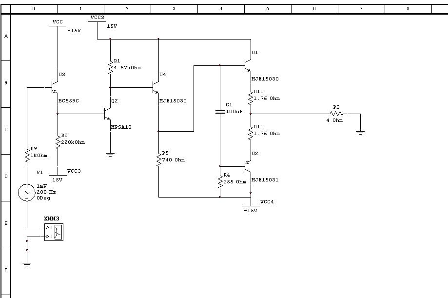

Ok, I think the way things are going I'm not gonna learn nothing. I think I'm going the wrong way. Because of this, I've built a new amp, much simpler than the last one, no diodes or caps, only simple stages present in my books. Please take a look and tell me what you think. I tryied to bias the output emitters at 3.75A, but no sucess, still lots of DC offset at the output (about 800mV). I'm trying to put collector of U2 at about 8.1V, because this will let the maximum swing to be safely between 15V .. 1.2V. Also, my doubt about datasheets continues... they use Vce = 2V for Hfe parameters, but in my circuit it'll be about 8.6V. Can I use the same values of I have to make a conversion??
Last question: if I plug a current mirror between collectors of U1 and U2, they will have always the same current and thus DC offset of the output will be zero????
