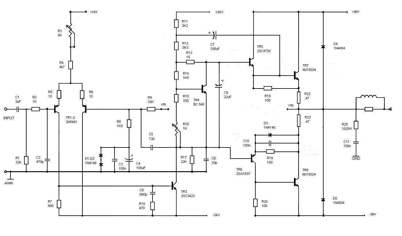

Hi all.
What is your opinion?
Guillermo

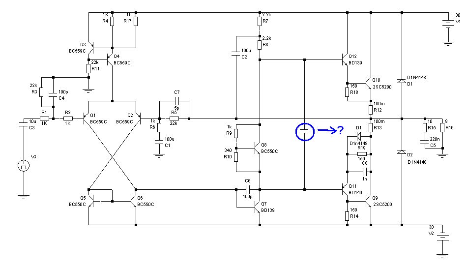

Q8 (the driver) sees as it's load :-
R10//Q9base
Q9base is just about equivalent to a diode//capacitance.
The effective load on Q8 is thus R//D//C
For good equivalency the complementary driver Q12 needs to see the same load on it's emitter. That R//D + R13 is an attempt to mimic the Q8 load, but the C has been omitted. The R is also in the wrong place. It is not in series with 0r1 (R13) The D//C only are in series with 0r1
To correct the partial schematic.
Remove the unlabeled resistor and replace it with a capacitor.
Now add a resistor (150r) from Q12 collector to the output (same connection as R10)
The three components now mimic the Q8 load. The difficult bit is finding the C value and picking a diode that is roughly similar to the "be" junction of Q9.
Both resistors are already defined in the upper half and the lower half matches them.
You still need R12 to define the current through the driver Q12.
Thanks AndrewT.
I think the diagram below is what you suggest.
The simulator shows no change in performance Except bias decrease. That can be fixed and with 100mA it's as it was before.
Any suggestions for the diode and the capacitor? Do the shown things seem good??
Thanks.
the resistor and diode should be connected to the collector of Q10 not the output. Baxandall is quite clear about this :)
I don't know about Baxendall but i'm in 100% agreement on this. If the network is connected to the output then there is nothing to stop Q10 from attempting to conduct horrendous amounts of current. I learn't by this mistake by blowing about £25 of TO3s :eek: With the network connected to the collector of Q10 so R13 is between it & the output there is local feedback which will prevent silly things happening :)
