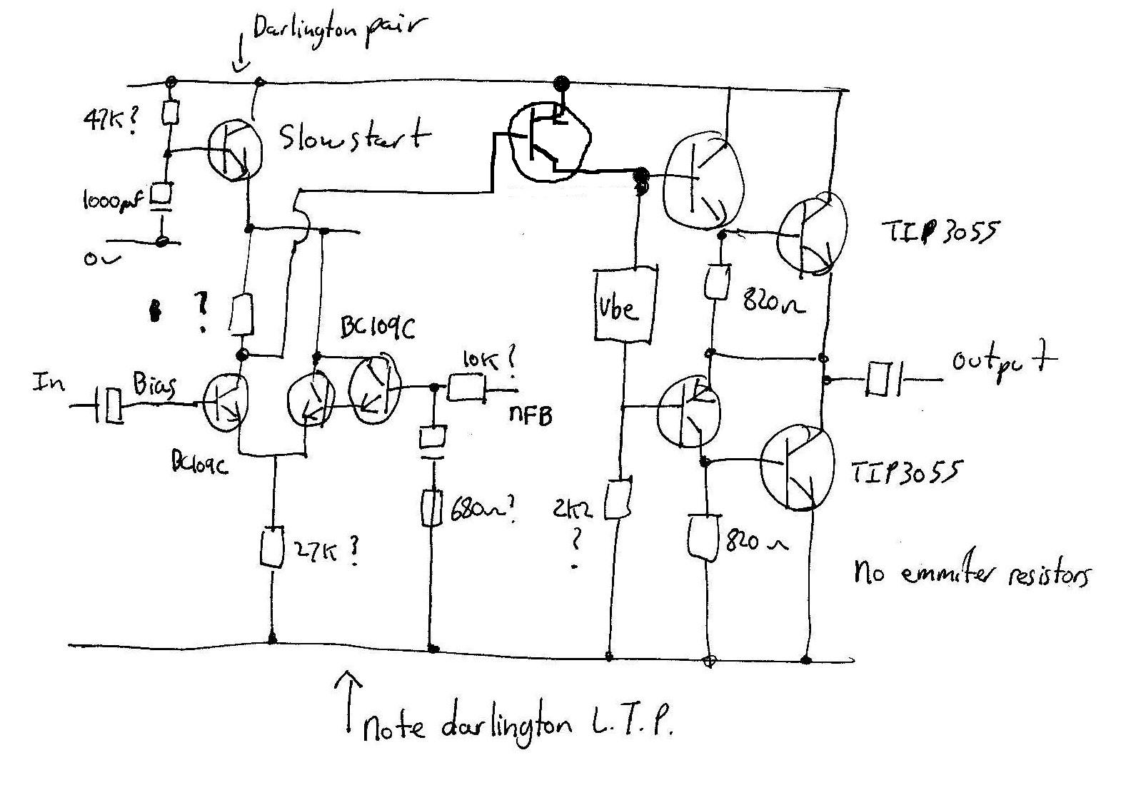

Mine for one, Doug Selfs designs for another. The caps across the vbe multiplier.
Are you thinking of the cap that links the emmiters of quasi drivers when they are cross coupled to allow for reverse biasing the outputs to increase speed ?
Disabled Account
Joined 2006
Yes I was thinking you meant the cap across the drivers emitter resistors, the cap across the vbe multiplier I agree, between 10 to 47 uf is good, rather to the higher side as this will prevent oscillations especialy if youre using a darlington or cfp type vbe multiplier.
Wow! Thanks for the good info people.
Regarding Oscillation...
I ran this sim with a 10kHz squarewave and the output really matches what you guys said. I'm impressed! :p I will install this cap in the next board as the current board doesn't have enough space even for such a small cap! Once I though of putting it in the solder side. But the Art would die if I did it!!!!! :D
BIG THANKS.
