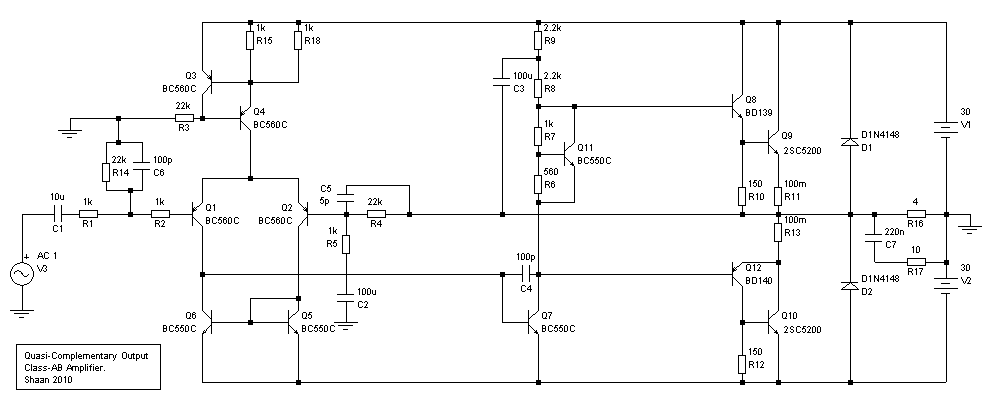

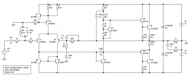

I have tried full Sziklai. It has a very clean sound. But not good for continuous long time listening. Darlington pair worked as good as Sziklai. But still the sound was not very catching. QC so far is my favorite config for natural and neutral sound. Neither screaming, nor murmuring. Plain flat response.
Just finished this QC amp. It sounds best among my class-AB amps and I would go as far as to say that it beats my LM3886 in sonic performance. With 200mA Iq it is thermally very stable and no Oscillation anywhere any time. Clipping performance is almost perfect.
Why do I upgrade? It's not broken. Not unstable. Not crappy sounding.
I added a 5pF in parallel with the feedback R to smooth out the square wave response. Now everything is SWEET.
People, please show your own version of QC config that you used/are using. I know you have better than mine.
Shaan, I'm thinking that you have reached the Black Belt of audio design now - when most of us are busy simulating and our egos are busy looking for something novel to publish in the Forum just for the sake of it - you have a simple design that sounds good and doesn't need to be messed with !
I'm still an Orange Belt :p

Thanks for the kind words. I am NOT a designer. I added some well-known spices into an existing amp schematic which lacked some robustness and simulated it purely out of curiosity. It seemed like a workable one. Off the table I assembled it. It worked. I already have my great chipamp for the sub. Comparing the sound output of both I thought this circuit sounds way better. What's left is reliability/ruggedness test. Yup I have plans to run it in full power initially into resistive load and then my sub.

I don't want praise. All I did was showing what I use. I never buy any pre-assembled audio gear thanks to you, bigun, event horizon and many other kind hearted experts in diyAudio. More fun from less bucks. I already said the circuit sounds wayyy better than 3886, to my ears. :)
Thanks for the second paragraph. I think the same. I have this thread subscribed and I sure will come back if there is a problem. I love QC. :D
Lastly, Apologies for the potentially rude words. I am learning and will continue to do so. Thanks for being nice with me.
