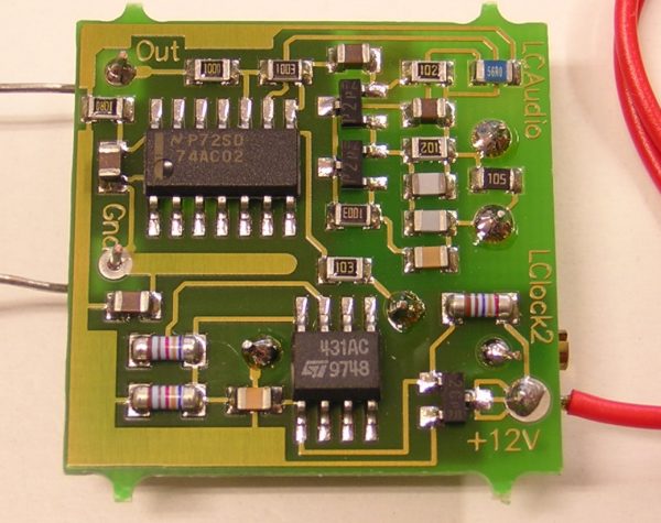

I am happy to see there are absolutely no similarities between the LClock XO 3 and KC 7.
However there are similarities with KC7 and our LClock 2, see photo. The TL431 based series regulator is on both clocks. Our design is from 1998. Who copied who? Today we use a voltage regulator with around 10 times lower noise than the TL431.
Also we use a 5 GHz (UHF tuner) bipolar transistor for our Collpitts oscillator, wheras KC7 uses a FET.
The comparator in the KC7 is also not the same. We use a single supply ground refencing type. And to minimize digital noise coming in from the CD / DVD layer, we also use a high speed logic buffer AFTER the comparator. Each stage of our clock has it's own separate power regulator. The power regulator is filtered with a Black gate NX Hi-Q capacitor, we all know those are good! Take a look at the photos of our XO 3 on www.lcaudio.com, you can see all of this.....
We have support circuits for the clock to be trouble free installed:
3 / 5 V setting, Fast Startup circuit, Output disable function, to avoid burning the control chip of a DVD player going into Standby.
Other clocks would continue to send a clock signal into the supply less chip, which will at some point burn it's input. An XO 3 also goes in standby with the DVD player.
We only use single supply as can be found in any CD / DVD player. No requirement for + and - supply. Lastly our 4 layer circuit board improves noise figures of the oscillator significantly.
So i guess nobody can rightfully claim that our XO 3 is a copy of the KC7. (And Jocko: i need not pay for anybody else's work )

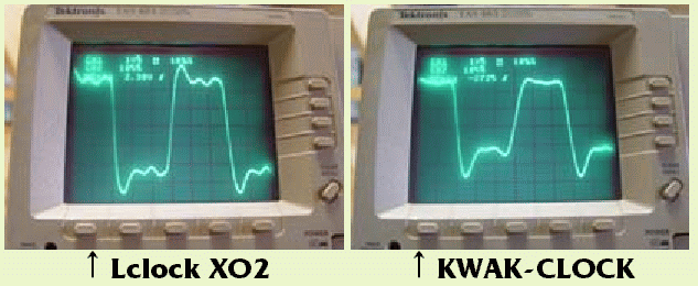

I found a Japanes web site that seems to be selling a cryoed Kwak Clock
soundden.com
Of interest might be the scope shots comparing the KC ver.? to the Lclock XO2
below is a screen capture.
hope this helps

Hi
This does only learn about rise time (assumed scope and probe are fast enough) and tells us the output impedance of LC is symmetrical and the KC not.
Jitter in the range of interest cannot be measured with an oscilloscope.
