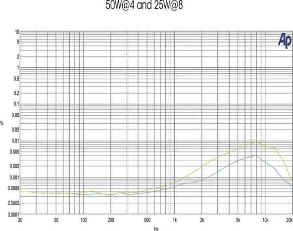

Hi to All,
Some measurements at R&D when I am playing with an improvement on the UcD......
Measurement is with 4 Ohm and 8 Ohm load and by 1kHz.
Green is 8 Ohm and yellow is 4 Ohm.
Jan-Peter
www.hypex.nl

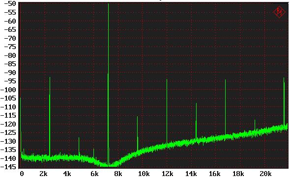

I don’t perform THD vs. Frequency sweeps as nothing annoys me more then seeing manufactures publishing THD sweeps to 20KHz with the AES17 filters enabled and the AP in 22KHz analyser Mode!!!
I perform 7.2KHz THD test (2nd & 3rd in audio band), but once again, the results are limited by the front-end reference modulator.
I do have 19KHz and 20KHz IMD results at 120W 8R – but these are limited by the R&S UPD05 having a near death experience. For dual tone IMD tests I cannot use the UPD’s “single frequency” notch filter, so what you see is the true resolution of the UPD’s ADC (i.e. without the benefit of the ~30dB dynamic range gain by using the internal notch filter) – the components you see at lower frequencies are the result of this near death encounter.
Despite this, the 3rd order IMD components of –115dB @ 120W 8ohms put most – if not all amplifiers to shame – the real level of these components could in reality be lower – who knows how much is due to the digitising ADC – and don’t forget that this is a total “replay” system result – ignoring speakers (i.e. no DAC or Pre-amp distortions to add).
In addition, although better then the AP1, the UPD has a real problem with “RF IMD”, unfortunately the UPD internal ADC’s sample at 48KHz, which “beat” with components of the 384KHz PWMFs (8fs).
The Amplifier is “TRUE” digital in the sense that the modulator is digital, continues time correction is applied around the OPS – which is not PEDEC.
John

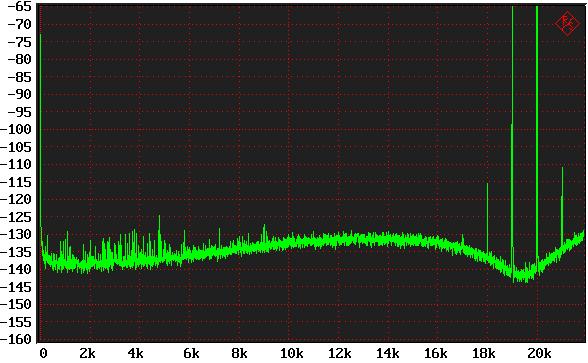

19KHz and 20KHz IMD results at 120W 8R – once again results are UPD / modulator limited. They are identical to the modulators PWM reference node.

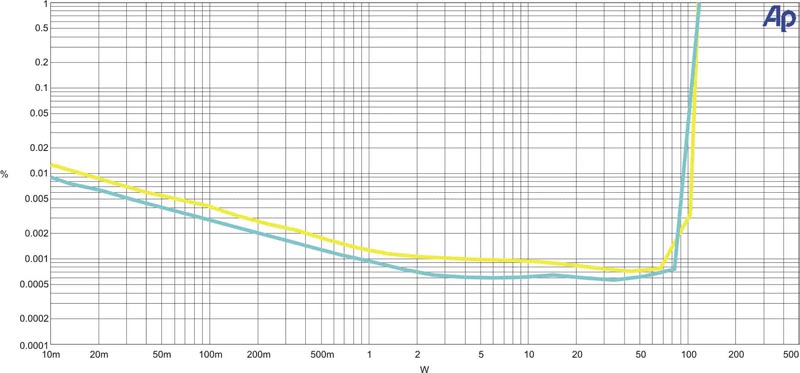

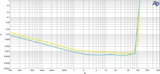

Again a measurement frequentie against THD in 4 and 8 Ohm with an outputvoltage of 13,5Vrms.
This are some mesaurements to see how shocking low a THD can be with a Class-D amplifier. Please notice this are really pre R&D measurements, where we only used some standard values for the Class-D modulator.......
I am really wondering how good will it be when the right components values are known ;-)
Jan-Peter
www.hypex.nl
If look at the above THD plot, you will notice the distortion drops off at higher frequencies, as increasingly less harmonics are in the measurement bandwidth - basically a meaningless graph above ~ 10KHz as even the second harmonic is now outside the 20Khz measurement bandwidth!
Pls. note that this is in no way a criticism of Jan-Peter, as 99% of manufactures perform & publish the same test!
But never the less, a very good result for such a simple design Bruno - how about calculating those optimised integrator component values for Jan?
John,
Ofcourse I agree with you. But measurement is also intepretating the graphs! You can increase the measurement bandwith of the AP, but the disadvantage will be the increasement of the noise.
So, In this case you woudn't see how good the amp performs at lower frequencies.
In a way you should measure with different bandwith settings of the AP.....
You have all the tools, can you show us your freq to thd graph?
BTW, I am VERY satisfied with AP Sys2 for R&D, we use the ATS2 for production (much cheaper).
Jan-Peter

The issue I have with THD vs. Freq plots is what are the curves showing above 10KHz when the AP is set to 22KHz mode and the AES17 filters enabled?
Above 6.6KHz, only the second harmonic is in the measurement bandwidth, and above 10KHz, all harmonics are now out of the measurement bandwidth – so again what are the curves showing above 10KHz? Well for sure it cannot be THD – so its wrong to represent them as such.

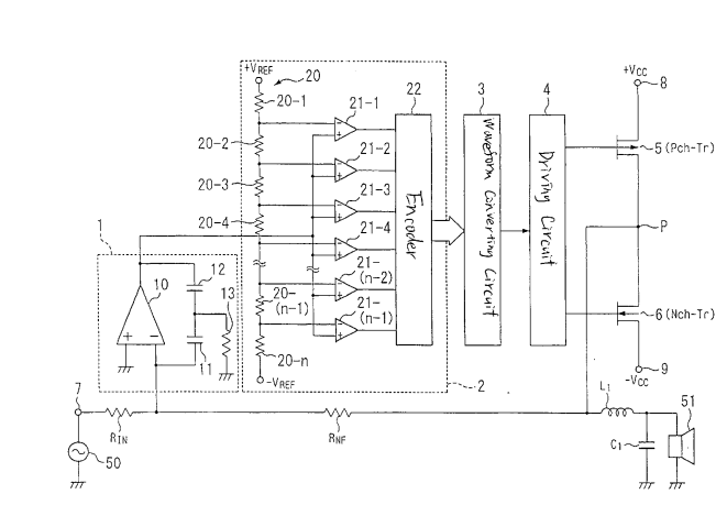

Hi Bruno,
from your description of PPA amplifier it seems that it is roughly similar to the concept of Yamaha Yamaha MX-D1 amplifier. The principle of modulation can be seen in US patent application 2003/0058038 and in attached picture. Although Yamaha uses dedicated chip modulator, I think something like that may also be DIYable in multiphase version?
John,
I remember that you use complementary pair in your output stage. Recently I had to develop a 2V/45A power supply. I used 3 phase synchronous buck converter running from 12V. All FETs were Nchannel SO-8 devices, compact layout and 4 layer PCB. I have noticed the same phenomenon for the second time. I had ringing on top of the low to high transition of the half bridge, that is when upper FET turned on. But the high to low transition was exceptionally clear, no ringing whatsoever. Now I don't know if that has anything to do with the fact that lower FET was operating in ZVS (zero voltage switching) regime, or that it was in common source configuration in contrast to source follower configuration of the upper FET. I had previously used complementary source follower configuration, but I had this 10V 10ns spike and some ringing on both transitions, regardless of supply voltage (from10 to100V). I noticed that Yamaha also uses complementary common source pair and it is said that newest Tripath modules use it also. How clean are your switching waveforms?
Best regards
Jaka Racman

Apparently the MXD1 uses a flash converter followed by a digital pulse width modulator. This is of course an unnecessary complication. The same result is obtained by an analogue PWM circuit.
It is a typically Japanese phenomenon to add circuitry for the sake of "more proprietary technology" without reaping any technical benefit. Usually the results are worse than what the simple solution would have done. Sometimes a large number of extra measures have to be taken in order to counteract the negative effects produced by the added technology.
That said, feeding the control output into an AD and digitally processing that signal for use by the power stage is also done by PPA. There, this is done because the power stage can reproduce a multitude of voltage levels. So, you need to quantise first. The digital processing is necessary in order to keep the currents in the output inductor network (center tapped chokes) around zero.
