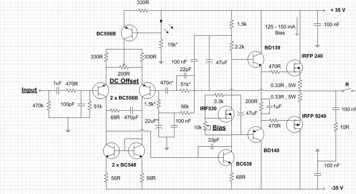

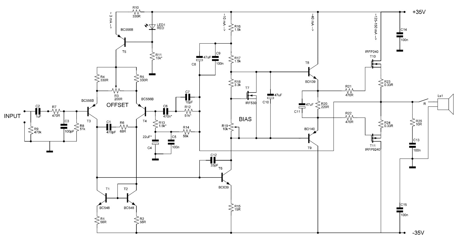

What you think about this schematic?
Help Please!

It increases Bass amplitude. It will increase the bass from speakers which ordinarily have less.
The effect can be controlled by placing a trimmer or potentiometer across the 470nF cap.
Values for C5 will vary depending on the bass response of the speaker, and so different speakers will respond the same. So it may not work best with all speakers without changing the value.
However this cap could also be used to compensate for the bass reduction caused by C10 and C1, in which case the effect is more independent of speaker parameters. For this one would have to measure the time constant of R7 and C1+C10, and match this with the time constant of R5 and C5. R18 is necessary to limit bass amplification so as to control DC offset.

Optimally for this feedback network:
C5*R5=R7*(C10+C1)
If this is not true, bass will be amplified or not relative to the input signal.
This does not take into account speaker bass response, so one might want to leave C5 too low, to increase bass. However breaking the above relationship may produce a product which will prefer certain speakers.

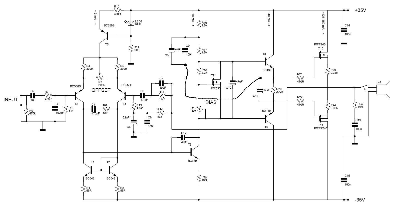

Hello again!
Hi guys again! I found a problem in my schematic.
After a loud play on a party amplifier burned the output devices. Amplifier was
hot and outputs were melt on the heatsink. So I replaced them and starting to play with multimeter attached to the amplifier. And now what I found - the source follower for thermal compensation does not work at all. Outputs have normal bias 100mA which can be adjusted with the trimmer but no thermal compensation - current start to rise after warm up. So my sourse follower didn't work. I replaced the gate to drain resistor to 3.3k and trimmer to 10k.
Now everithing works fine bias is very stable and amp works again.
If someone try to build that amp please be aware not to use the prevous schematic. There it is the corrected one.

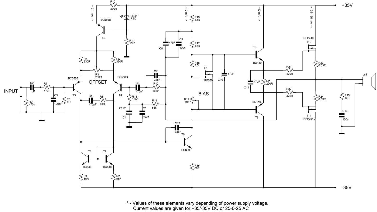

Update!!!
After careful listening tests i decide that amplifier sounds much better when VAS current is slightly increased. So I replaced bootstrap resistor 2.2k with 1.5k.
I think that will be the last update that I made to this amp.
And new schematic made with SPlan:
Best regards to everybody.

Your RF filter at the input is set very high (RC~0.05us).
Might be worth experimenting to find at which level it becomes audible? one octave lower, or two octaves lower, or three octaves lower, or a full decade lower, or four octaves lower?
Having reduced R17 from 2k2 to 1k5, it might be worth increasing C8 to >=100uF
What about Zener protection for the FET gates?
Tweaking....again???
Well a bit tweak to the VAS 68R is now down to 15R.
The more important is to reduce the compensation cap in the NFB from 22pF to 10pF or less if no oscillation in my case 10pF probably because no PCB everything is on a universal board and cables to drivers and outputs.
So I'm using the amp in this configuration over a month and no problem.
Sound improvement is amazing and I have many hours of enjoying it.
So till next tweak probably but when I don't know.
