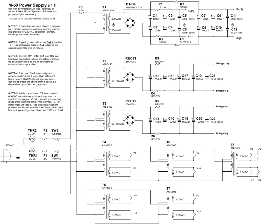

That 75V AC rating on the secondaries of the B+ supply for the output tubes seems a bit low to me. Typo?

Perhaps more to the point; would running with 75VAC secondaries for the output stage power-supplies be sub-optimal from a music reproduction standpoint? Those of on the thread are, of course, interested in maximizing the music reproduction capabilities of our DIY M-60's... :D
I see that we can get off-the-shelf 600VA-rated toroids with dual 50VAC@6A secondaries (Antek - AN-6450); if we were to use one of these transformers per "phase" of the Circlotronic output stage in a "stacked" secondary configuration, that would give us 140VDC@6A for each of the "floating" output stage power-supplies. It would double the number of power-transformers needed to provision the output stage, but the important question is, "Would this approach be better from a sound-quality viewpoint?". If so, I'm more than happy to revise our proposed power-supply design. :cool:
I've also submitted a price quote request to Toroid Corporation (I've used these folks for customer transformers) for a dual-secondary 99VAC@6A power-transformer (equipped with 117/230VAC reconfigurable, dual-primaries), just to see where the price range would fall. It's possible the price for a single custom-wound toroid might be less expensive than two of the off-the-shelf transformers that I just described.
M-60 OTL Power-Supply Schematic (v1.1)
OK, apparently I experienced a Homer-Simpson-esque "Doh!" moment when originally searching for appropriate off-the-shelf power-transformers for the M-60 mono-block project. At the heart of the matter, I failed to consider the use of stacked secondaries in order to more closely approximate the design center provided by the custom power-transformers used in the commercial M-60 project. Mea culpa... :rolleyes:
So, attached is the revised M-60 power-supply schematic (again, in both JPEG and PDF formats) that uses a pair of Antek AN-6450 (Antek - AN-6450) to power the M-60 "floating" output stage power-supplies. Each of these power-transformers provide a combined 100VAC (50+50VAC) output, resulting in a 140VDC@6A output. Obviously, I'll need to cook-up an updated parts-list, but I'll get that posted soon.
Everyone good with this change? Any rational objections? :D

Actually there's one thing that keep bothering me. Please explain this to me.
Reading the data sheet for a Svetlana 6AS7 it reads plate dissipation 13W max.
I assume that's for one channel and we have two per tube i.e 26W per tube.
8 tubes makes that 208W.
140VDC @ P=UI -> I=1.5A
AN-4450 is rated 2x50V | 4.0A
Why not go with the smaller cheaper transformer? What am I missing?
Maybe it's even possible to run the AN-3245? But then we're loosing voltage, only 2x45VAC | 3.3A.
If possible to go with the smaller transformers we'd be cutting the cost in a big way.

The M-60 output stage targets each 6AS7 triode section to run at an idle bias value of 60mA. Each "phase" of the output stage floating power-supplies places 140VDC across the 6AS7's. The result is that each 6AS7 triode section has a standing plate power-dissipation of 8.4-Watts (60mA x 140VDC). The 6AS7 is rated for a maximum plate power-dissipation of 13-Watts per triode section (26-Watts per 6AS7), so the M-60 output stage is only running the output tubes at about 65% of rated power-dissipation capacity. While my own background of conservative engineering would usually lead me to design to a somewhat lower percentage of power-dissipation, the 30+ year track history of the production M-60 power-amplifiers certainly demonstrates that the specified configuration does not impair long-term reliability (quite the opposite, in fact...). So far, so good... :D
The Circlotronic/bridged output stage is still a relatively new concept to me, so my understanding may be incomplete; caveat emptor... ;)
The Class-A2 mode of operation employed in the M-60 output stage requires that we consider a couple of non-intuitive (at least to me...) aspects of 6AS7 current-delivery to the loudspeakers. The M-60 output stage leverages the transient current-delivery capacity of the 6AS7, which is not specified in the datasheet. The total output-stage idle bias current is 480mA per "phase" of the output stage, so a push-pull Class-A output stage would only be able to deliver 960mA (peak), or about 3.7-watts (RMS) to the output. But, the "secret sauce" is the fact that the M-60 output stage makes use of grid-conduction on the 6AS7's (the "2" suffix in "Class-A2" indicates grid current flows for some part of the cycle). Driving the 6AS7's into grid-conduction allows us to "squeeze" a peak output current delivery of up to 300mA per triode section, all while each 6AS7 section remains in conduction throughout the output waveform cycle (the definition of Class-A operations). Therefore, the Class-A2 output stage of the M-60 can deliver up to 2.4A of current per "floating" power-supply, so each "phase" of the "floating" power-supplies much provision at least 2.4A's of current capacity.
My own engineering "best practices" lead me to specify components that are operated at less than 50% of their RMS-rated capacities. Designing power-supplies for a nominal Class-A output stage, the M-60's standing bias current of 60mA per 6AS7 triode section would lead us to believe that we only need to provision 240mA's of current capacity within each "floating" power-supply, so a power-transformer with a secondary rated for 500mA would be sufficient for conservative operation. Under these circumstances, the smaller power-transformers mentioned would be OK.
However, the Class-A2 mode of operation in the M-60 output stage alters some of the baseline power-supply configuration considerations. To ensure Class-A operation, the power-supply must provision sufficient current capacity to satisfy the peak current demands; the peak Class-A2 current need is 2.4A's, so to conservatively operation the M-60 output stage the power-transformer should be rated for at least 5A's of current delivery. Under the constraints just outlined, smaller power-transformers would likely "work", but those devices would be stressed beyond the bounds of conservative operation (IMHO). :D

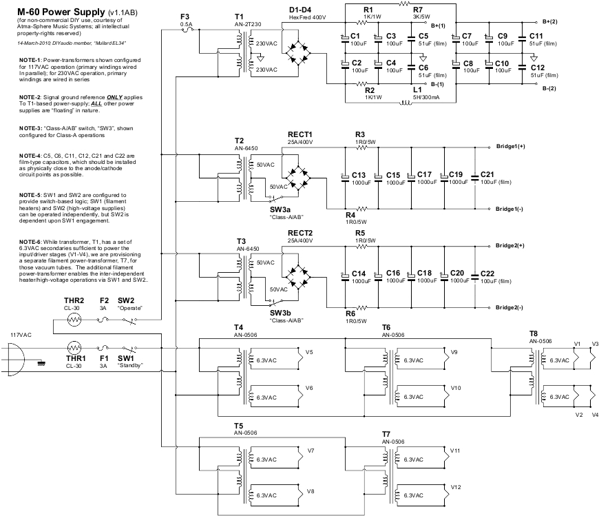

tympani1d,
Thanks for your kind words! As to the Class-A/AB switch functionality, there are a number of "moving parts" that have to be properly enmeshed/engaged; that's a big part of the reason that I opted for the "hot-rod"/Class-A-only M-60 configuration... :D
The only schematic that includes the Class-A/AB switching functionality is the schematic for the production M-60, which was posted by "atmasphere" earlier in this thread. Neither of the power-supply schematics posted by me include the Class-A/AB capability.
The Class-A/AB switching functionality appears to have two primary elements:
* Reconfiguration of primary-windings for "floating" power-supplies - the Class-AB mode only energizes half of the primary windings of the "floating" power-supply transforms; the input/driver stage power-supplies are unaltered.
* Decreased fixed-bias for 6AS7's - Class-AB mode switches-in additional resistors into the voltage-divider that establishes the fixed-bias voltage for the output tubes, resulting in more negatively-biased grids for the 6AS7's.
The power-transformers that we've specified for the DIYaudio M-60 (selected to enable both 117/230VAC operations) could accommodate the necessary reconfiguration for 117VAC (switch the AC-line voltage input to only drive one of the two primary windings), but I don't see any means of configuring the Class-AB functionality for 230VAC environments by manipulating the transformer primaries.
Hmmm, I suppose that, leveraging the dual-secondary power-transformers that we've recently specified for the DIYaudio M-60's "floating" power-supplies, you could use a switch to only employ one of the 50VAC secondaries during Class-AB mode (using half of the secondary voltage would be the equivalent to driving only half of the primary voltage, right? :)). The dual-secondary nature of the DIYaudio M-60 power-transformers would enable the Class-A/AB switching, regardless of 117/230VAC primary-winding configuration. Just a thought; your mileage may vary... :D

As I noted, power-transformers for the "floating" power-supplies with less current-delivery capacity would "work", but it would appear to be sub-optimal to me. I would recommend that we not unnecessarily constrain the M-60 design/topology during the build-out ($20-$30/transformer just doesn't seem worth the potential performance compromise from my standpoint, but that's just an opinion...). However, the DIYaudio forum members are certainly free to implement the design according to their own engineering muse... :cool:

M-60 OTL Power-Supply Schematic (v1.1AB)
Yes, I see the point.
I'm still fence riding as to "Hot Rods to Nirvana" or build up to switch for touring suspension on a quite ride in the clouds, as it may be and mood strikes!! :sax:
tympani1d,
Well, high-quality music reproduction is all about "enjoying the ride"... :cool:
Following-up on the thoughts I offered in an earlier post about implementing a Class-A/AB switch, I've attached a revised M-60 power-supply schematic that includes the power-supply elements of the mode-switching for the output stage; the additional switch, SW3(a/b), implements the necessary changes to the "floating" power-supplies for the output stage.
For those interested in including the Class-A/AB switching functionality, please review the schematic and see if it makes sense as an equivalent means of dropping the voltage across the output tubes as energizing only half of the transformer primaries (as documented in the original M-60 power-supply schematic posted by "atmaphere"). This circuit change, combined with the concurrent altering of the fixed-bias voltage with other sections of the switch, SW3, is how the M-60 is reconfigured for Class-AB operations. Man, that's a couple of ugly sentences, isn't it? :rolleyes:
