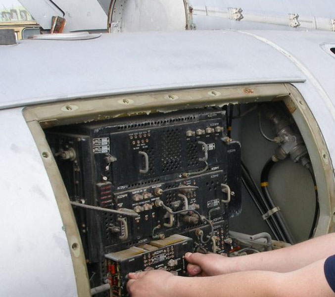

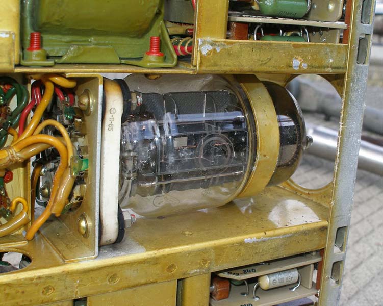

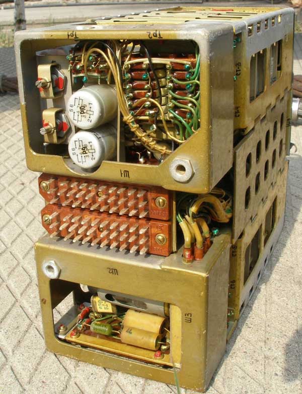

I can second that, most of the data I have on the quirks of the 6S33S that the general public is not aware of, comes from a few people who used to service MIG aircraft here in 'Zavodi Zmaj' Croatia (military operated while it was still in the ex YU, and even then other countries that had them had them serviced here - it was later part privatized and still services aircraft today).
The socketing arrangement in the MIG module (the way these are made is very interesting in itself, cast out of some sort of foamed aluminium-magnesium-titanium alloy to make it strong and light) includes a top retainer and the heater pins are crimped and apparently soldered with a special alloy. When it's serviced, the tube and the socket is changed. The 750 hour limit is a maximum, it would often be exchanged earlier depending on how the aircraft ended up being rotated for service. Also, the tube is operated single-cathode, and you can switch them over as a redundancy feature. Operated single-cathode, it's actually an extremely reliable tube, but since everyone wants to save on the number of bulbs in a project...
