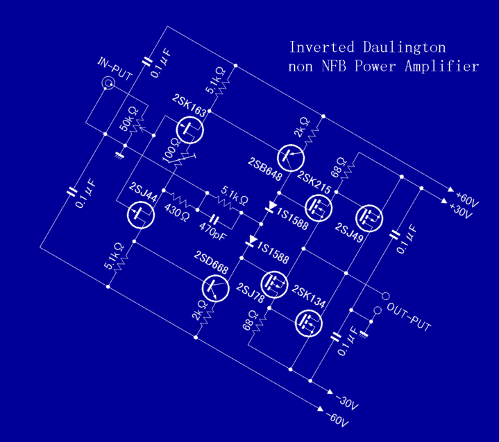

Thanks!
This one is truly a NON NFB design since only local feedback for any stage as opposed to only have the output stage outside of the NFB loop.
I wonder if there would be a possibility for PCB....
Fab
