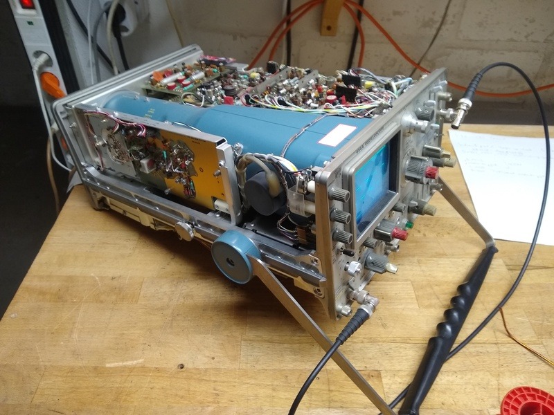

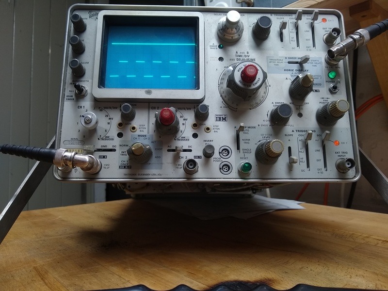

The last few days I repaired 3 old oscilloscopes that where otherwise on their way to the dumpster
The last one was a Tek 454A without horizontal sweep. Studying the scanned service manual of approx 300 pages
I encircled the culprit, a JFET inside the sawtooth generator. What a monster of discrete analogue technique,
sometimes I was close to give up

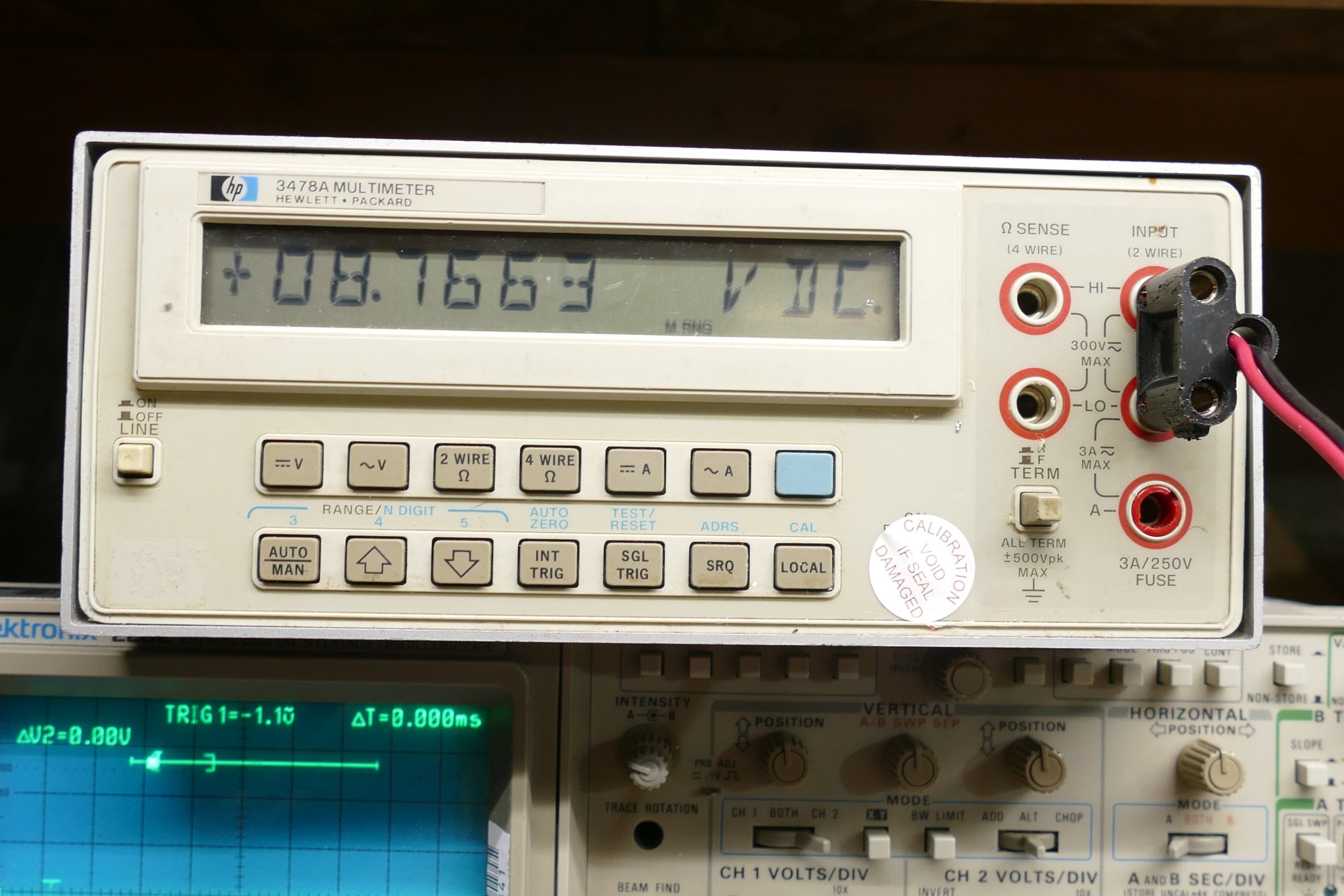

Got digits? This is what you need to determine if the 9 volt battery in your Harbor Freight multimeter needs to be replaced. I have several of their cheap meters for poking around in tube circuits. Only blown one in over 10 years.Ahhh! Someone else that groks that more digits are bettererr!
I got a HP34401 with more digits in a pile of dead test equipment that I bought many years ago, but I traded it for a dead (physically damaged) HP8903A audio analyzer just to get a spare CPU card. The 8903A uses HPs infamous SOS process CPU chip which can only be obtained by cannibalization of a dead 8903A. The "B" model does not use the same CPU. The SOS fab went away in the late 80's. I use my 8903A a lot and so far, the CPU has held up, but I have had to swap two other boards in it.
My 34401A is one of those that I would never part with - I replaced the display (dim) 12 years ago when I bought it off ePay and it has stayed accurate and pretty much bullet proof ever since. Even though the it and the Keithley are side by side, it is the one I reach for first by default.

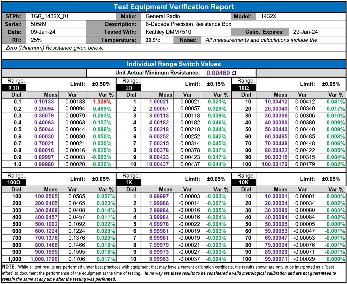

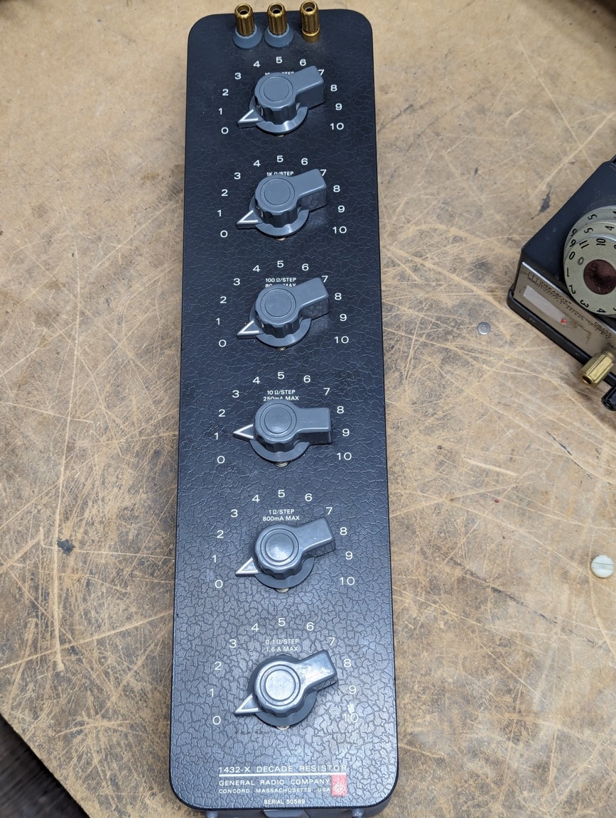

This is a General Radio 1432-X decade resistor that I got as part of a GovDeals auction several years ago - I have less than $5.00 in it. The one issue that I have with these (and other decade boxes) is that while the actual resistance elements may be ideal the total readings always include the parasitic resistance of the internal wiring. So the setting may be for 1.00 ohms but the actual resistance will be 1.05 ohms or such. This unit had a residual resistance of .004 ohms and, while small, it resulted in the low values being out of tolerance of the readings. This particular series of resistors uses individual resistors of the same value for all positions for each decade and the switch simply adds them in series. So, on the 0R1 and 1R ranges I added a resistor in parallel with the lowest value to cancel out the 0R004 residual. One thing to note on this is that this correction will reinforce any others in the following decades - you can tweak the lowest range to be perfect but if you select a value using the next (tweaked) range the corrections will be cumulative and the value will be too small. So you have to split the difference to eliminate these errors.
Anyway, not bad results for a 40-50 year old $5 resistance box

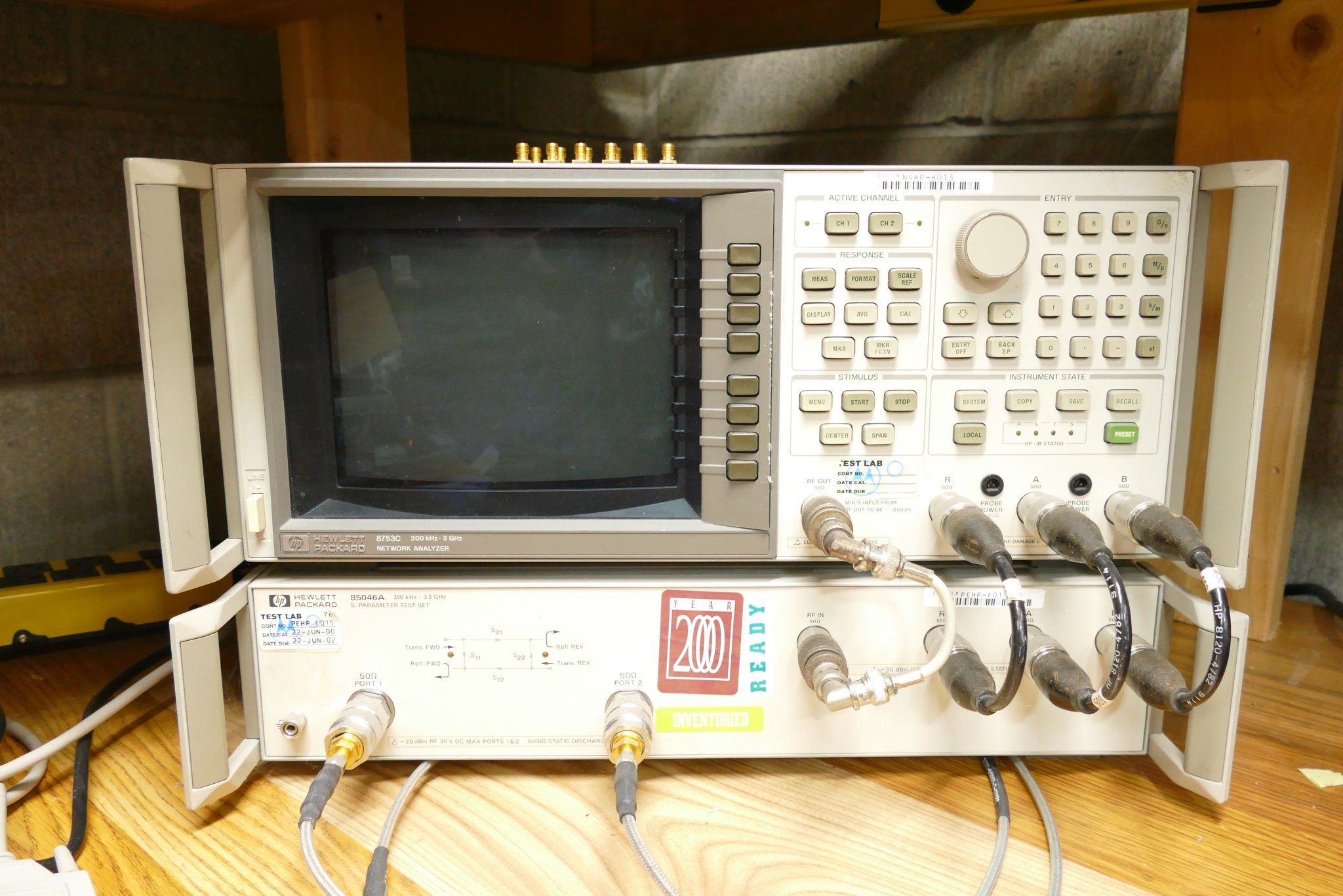

Regardless, Motorola and any other company that built stuff under government contract had to dance the Y2K compliant dance, hence the big "Year 2000 READY" sticker on the network analyzer. It did boost sales for the HPs and Dells of the world though.
