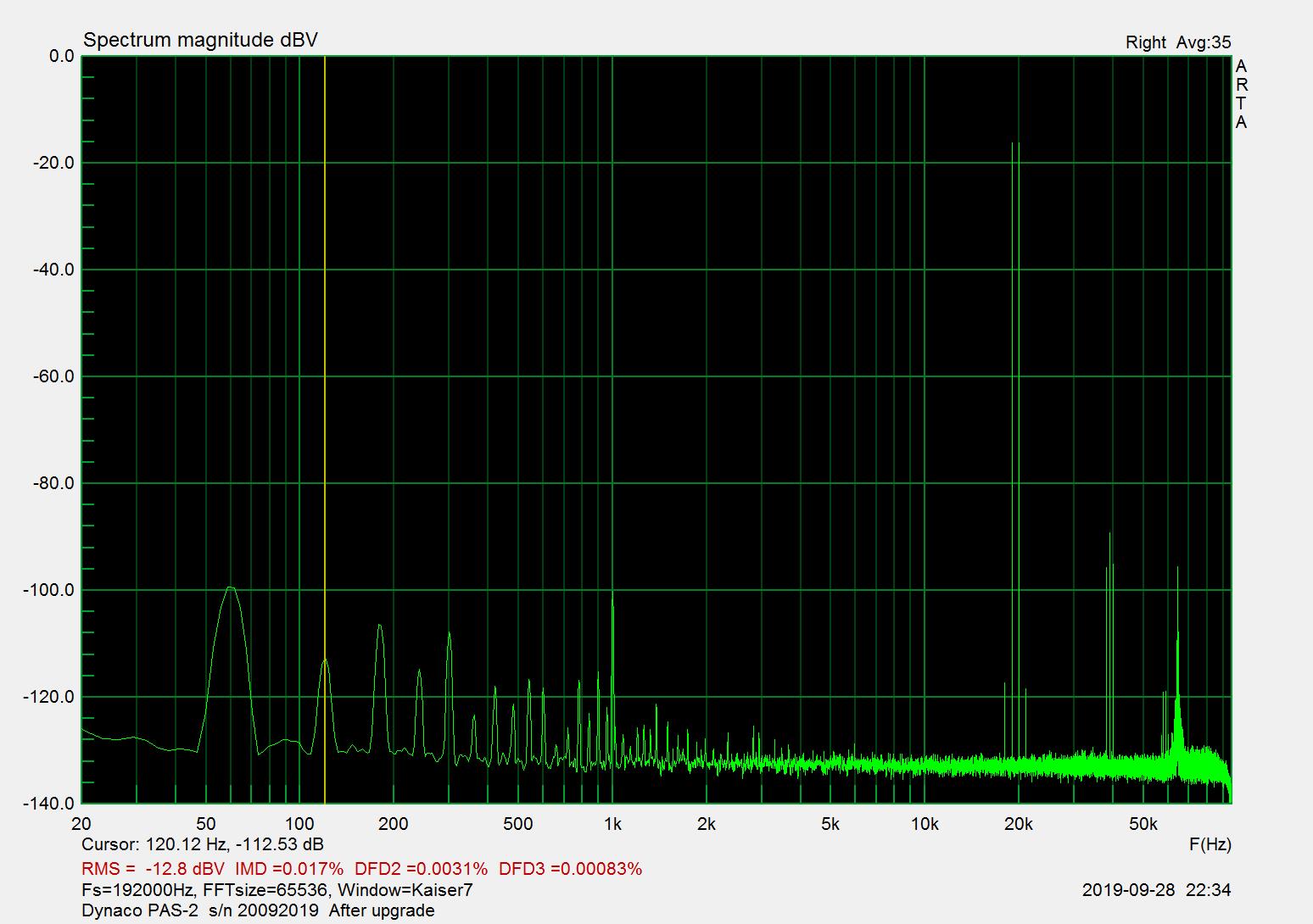

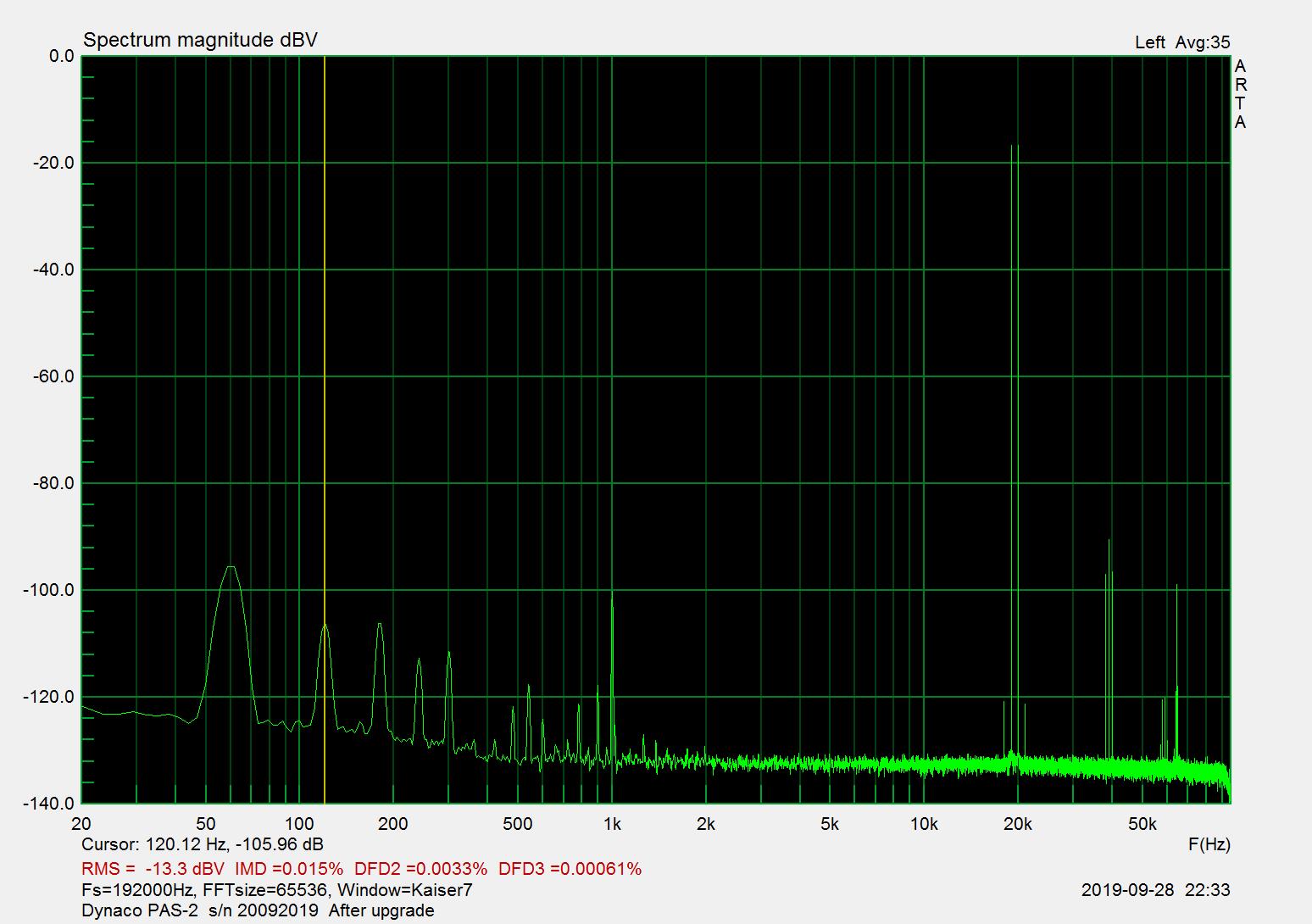

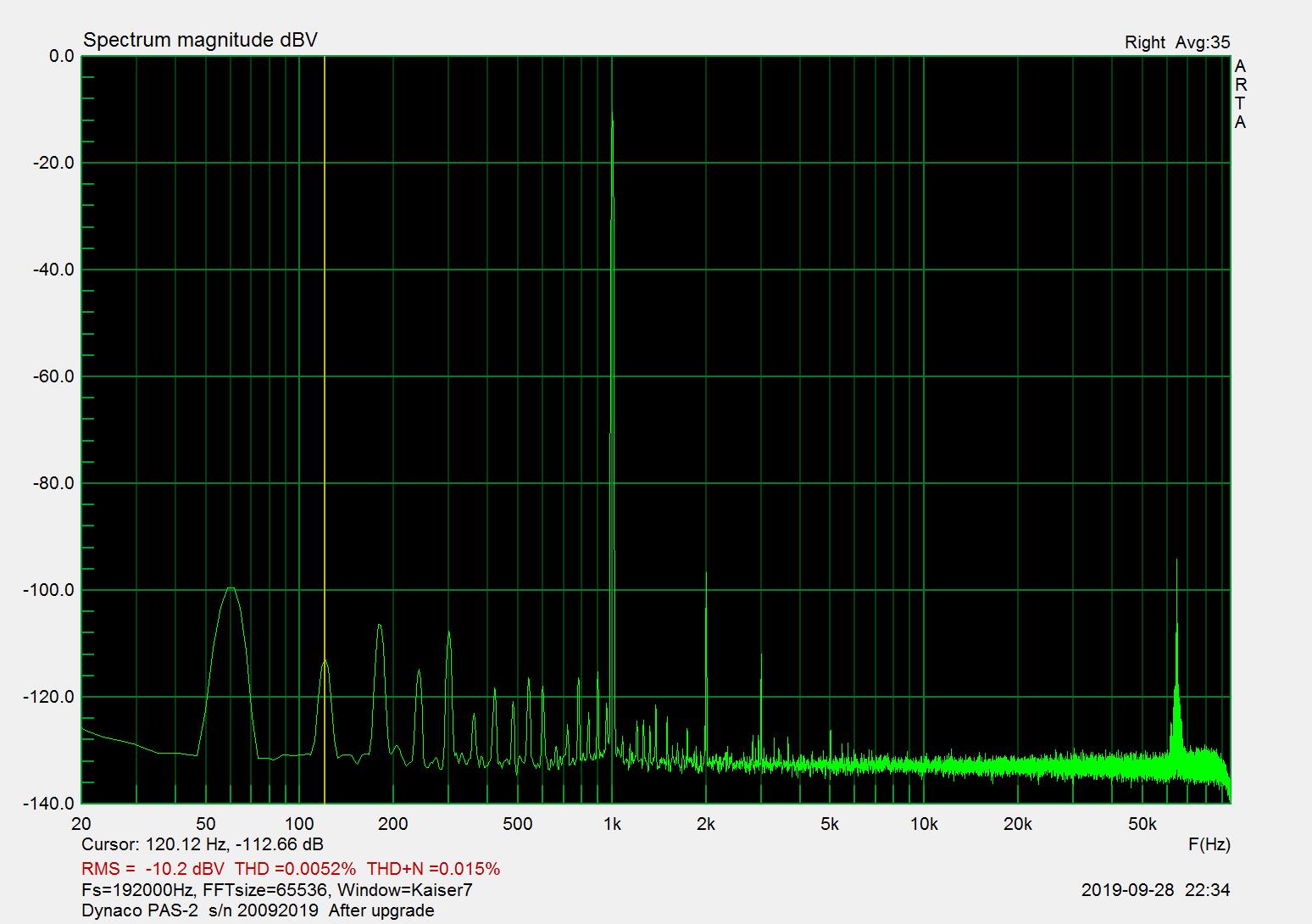

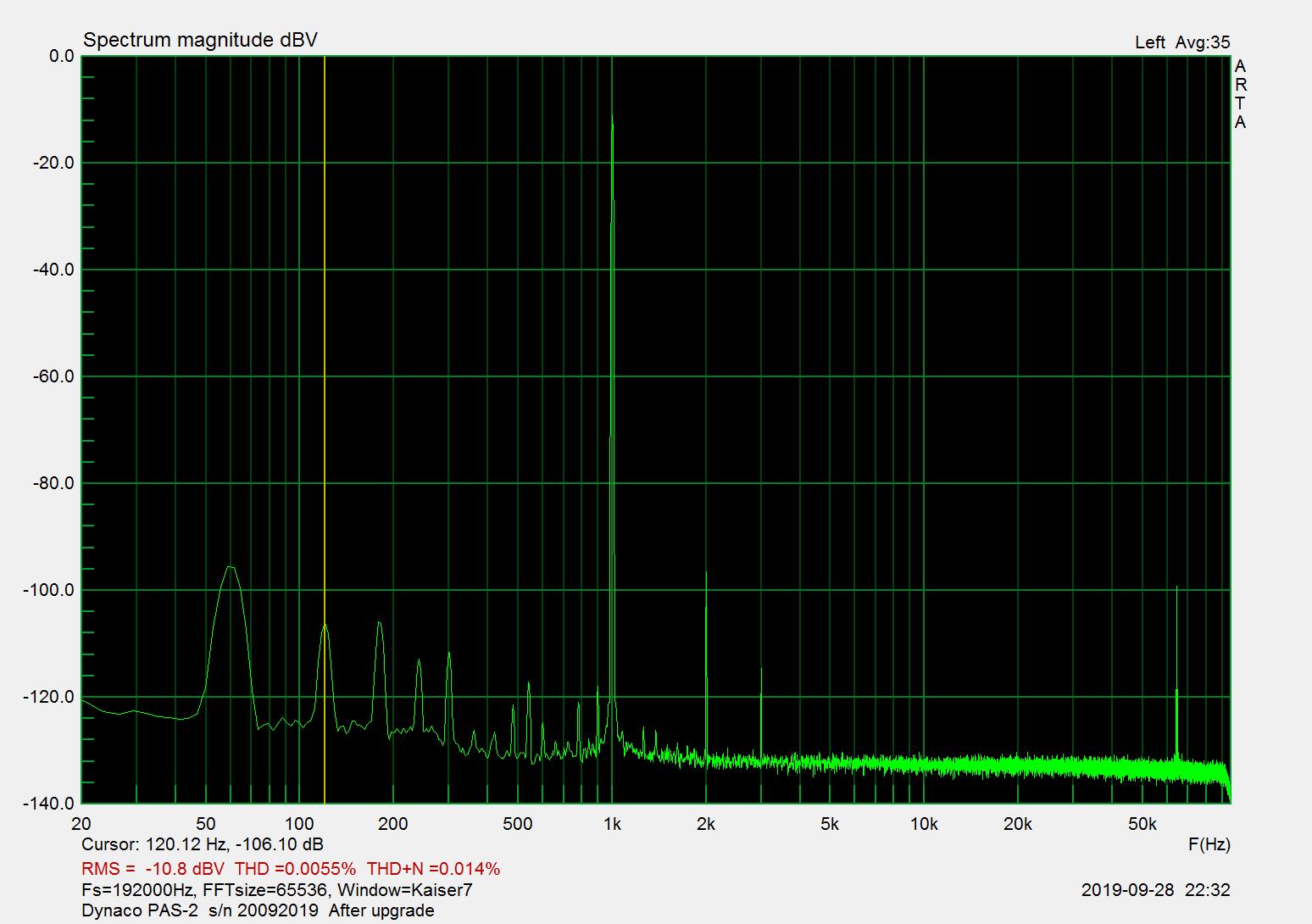

Just rebuilt a little Dynaco PAS-2 preamplifier. Due to it's age, almost every single resistor had to go (carbon composition). Also every capacitor except the multi-section electrolytic (go figure, it's in perfect condition).
The customer wanted it to perform the best it possibly could, so I opted for the best capacitors I could find without an audio name-brand on it. I didn't expect that great an improvement, but it really performed well.. I also matched the capacitors and carefully measured and padded the precision ones for the phono EQ.
If it were my preamplifier, I would have designed a nice high voltage regulator for it. Otherwise its a happy little "keeper". Here is the performance at 1 volt rms output. Not bad considering it was full of mystery tubes!
-Chris

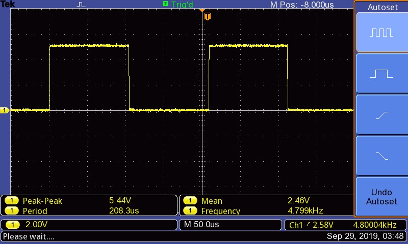

MX-50N again... Well it was a pretty challenged machine that got wet and had some odd issues that surfaced after about 50 hours of run time.
The capstan motor is a direct drive servo controlled BLDC with a logic and op-amp based control circuitry. Turns out I missed a few electrolytics during the overhaul and apparently there was a possible cold solder joint in one of the servo gain selection transistors.
It decided not to run at 15ips, for a while it was intermittent, and then it just started running backwards at maximum speed (30ips).
Surprisingly quick fix and the motor runs much quieter now on both speeds.
Performed the adjustment procedure in the manual. Pretty simple. Was marginally needed on the 15ips setting and also touched up the master clock.

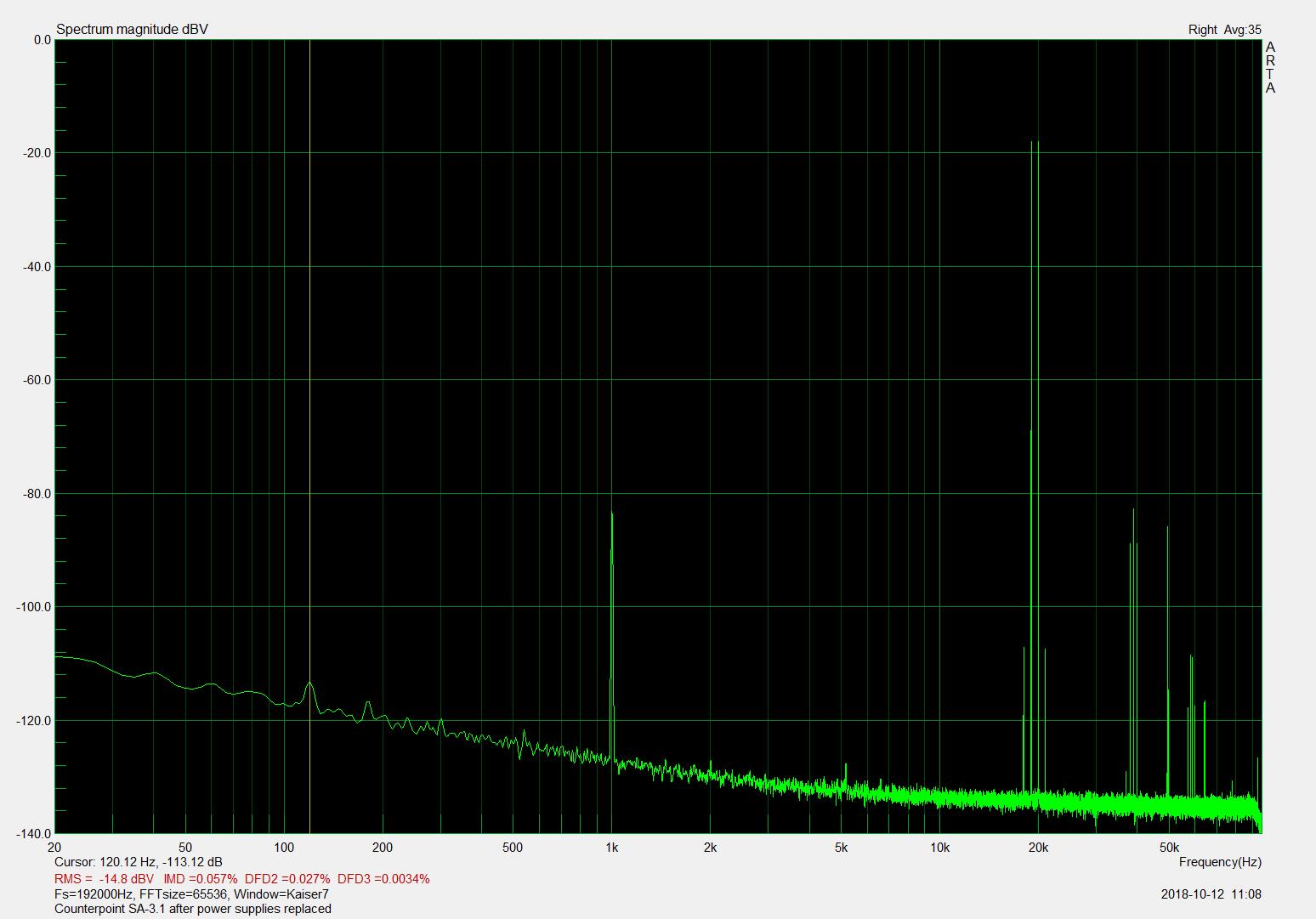

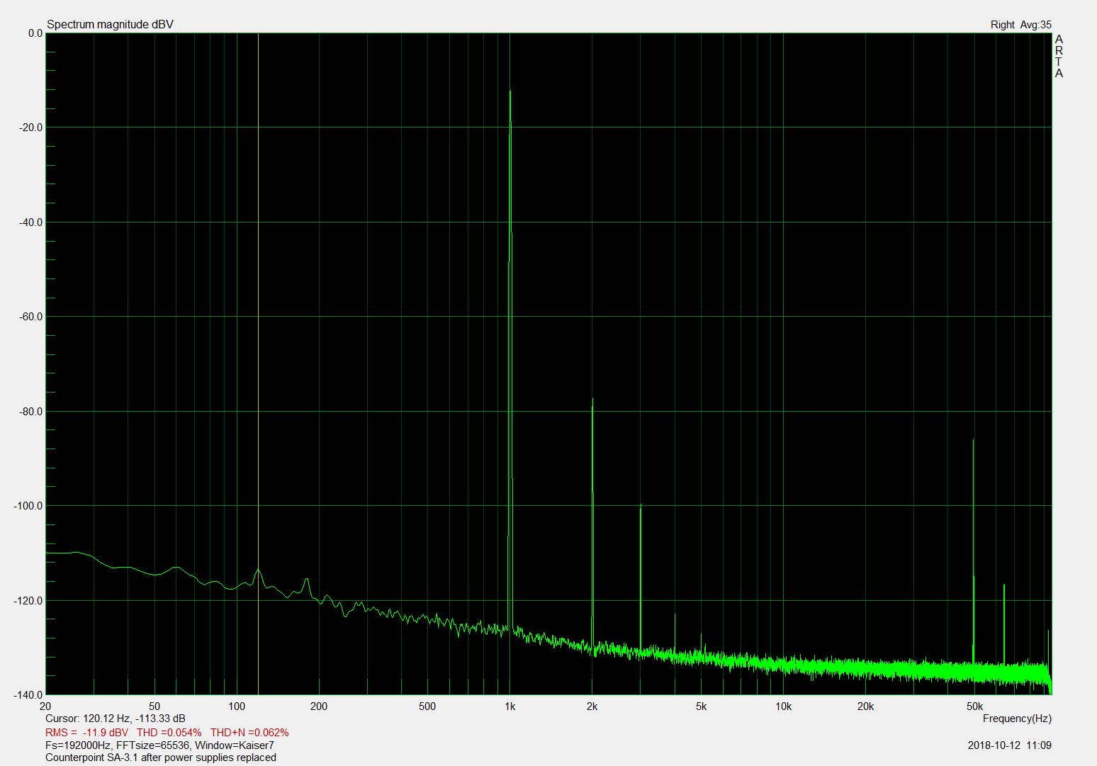

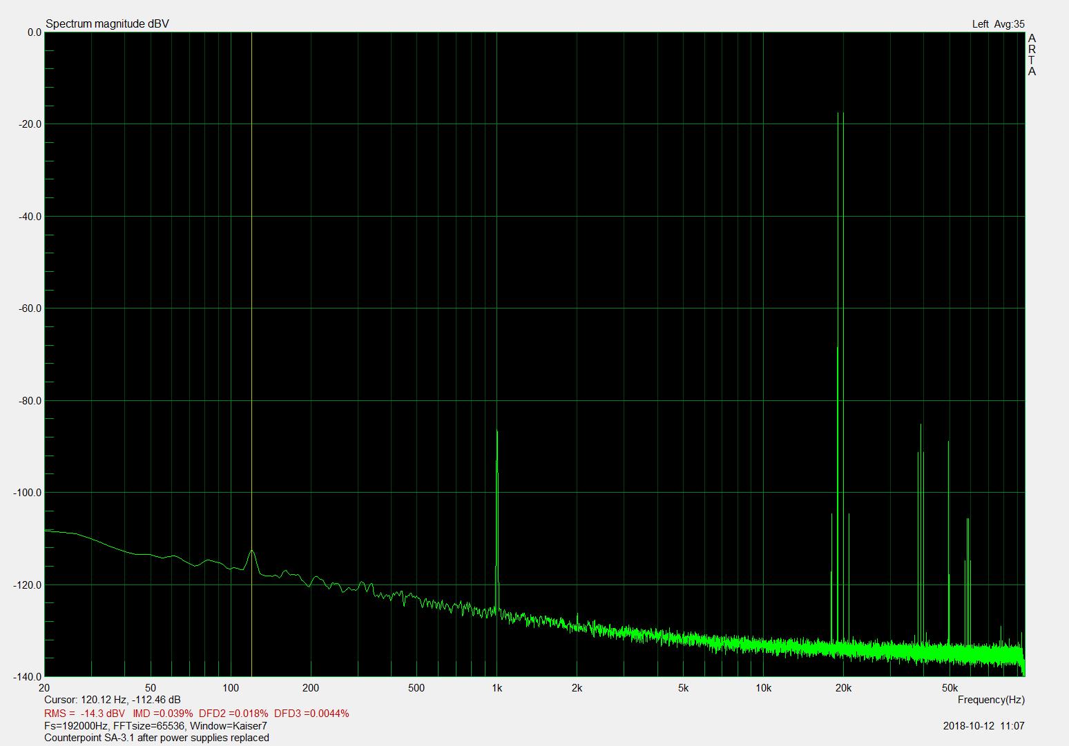

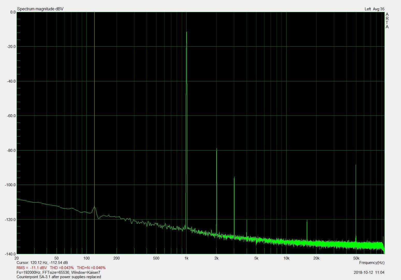

For comparison, here is a Counterpoint SA-3.1 that I completely redesigned both the LV and HV power supplies in. You can see the huge difference a good power supply can make.
The factory power supply was so bad there was no question about repairing it. You could only design a new regulator PCB and carry on that way. The old one had the regulator pass transistor perched exactly on the SOA curve line. I could go on, but suffice to say that the heat had to be spread out between at least two devices. This was done.
As you can see, the new power supply is perfectly happy doing it's thing.
-Chris
