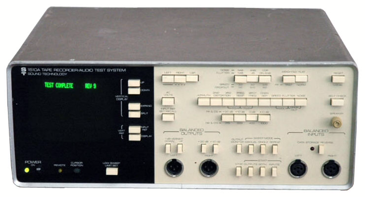

Back in the day, I can remember using one of these at the local hifi emporium. Other than the Revox and a couple of audio calibrating Nakamichis, I can’t remember a single make /model that didn’t substantially improve after a session on the bench with this gadget. Adjust azimuth, then pop off the top cover for access to PB & record level controls and bias to optimize Fr and distortion performance. Got it down to around 15mins, IIRC.

Hi Chris,
Yes, the Sound Tech unit. Flashy. I used just check points, but could easily sweep for frequency response if needed. The new gear I have can sweep, but by using DSP methods. Much faster.

Hi Chris,

At the shop in involved, the machine was set up on a table in one of the front window cubbies, where customers could sit and partake in the sacrament of “calibrating for the particular type of tape you’re using”, while sipping a freshly brewed espresso or Americano - although it was generally BYB - bring your one biscotti. Also in the same bank of cubbies was the turntable/tonearm set up station, including the rig for adjusting suspension on those fidgety Linn LP12.
Ah, those were the days

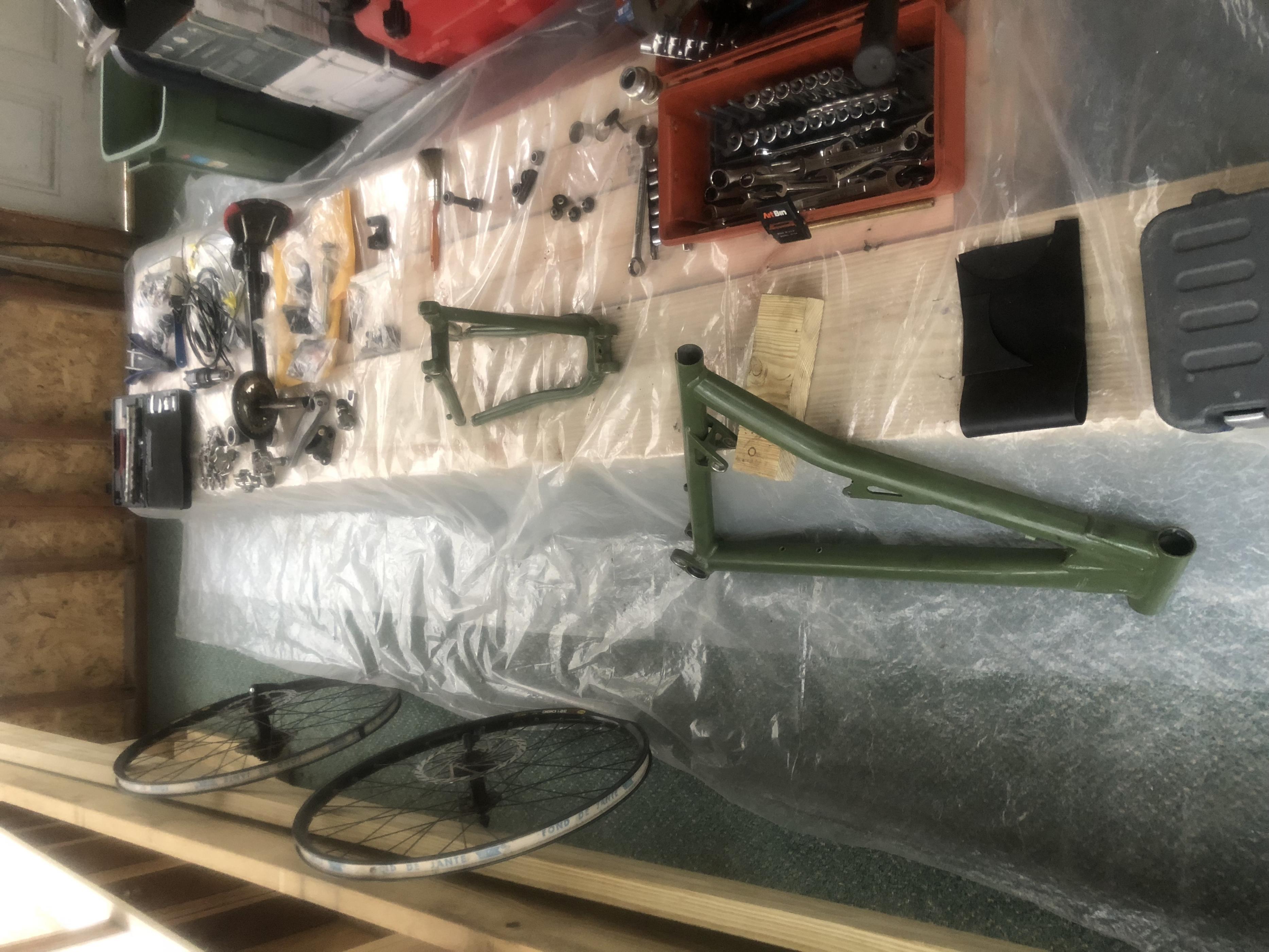

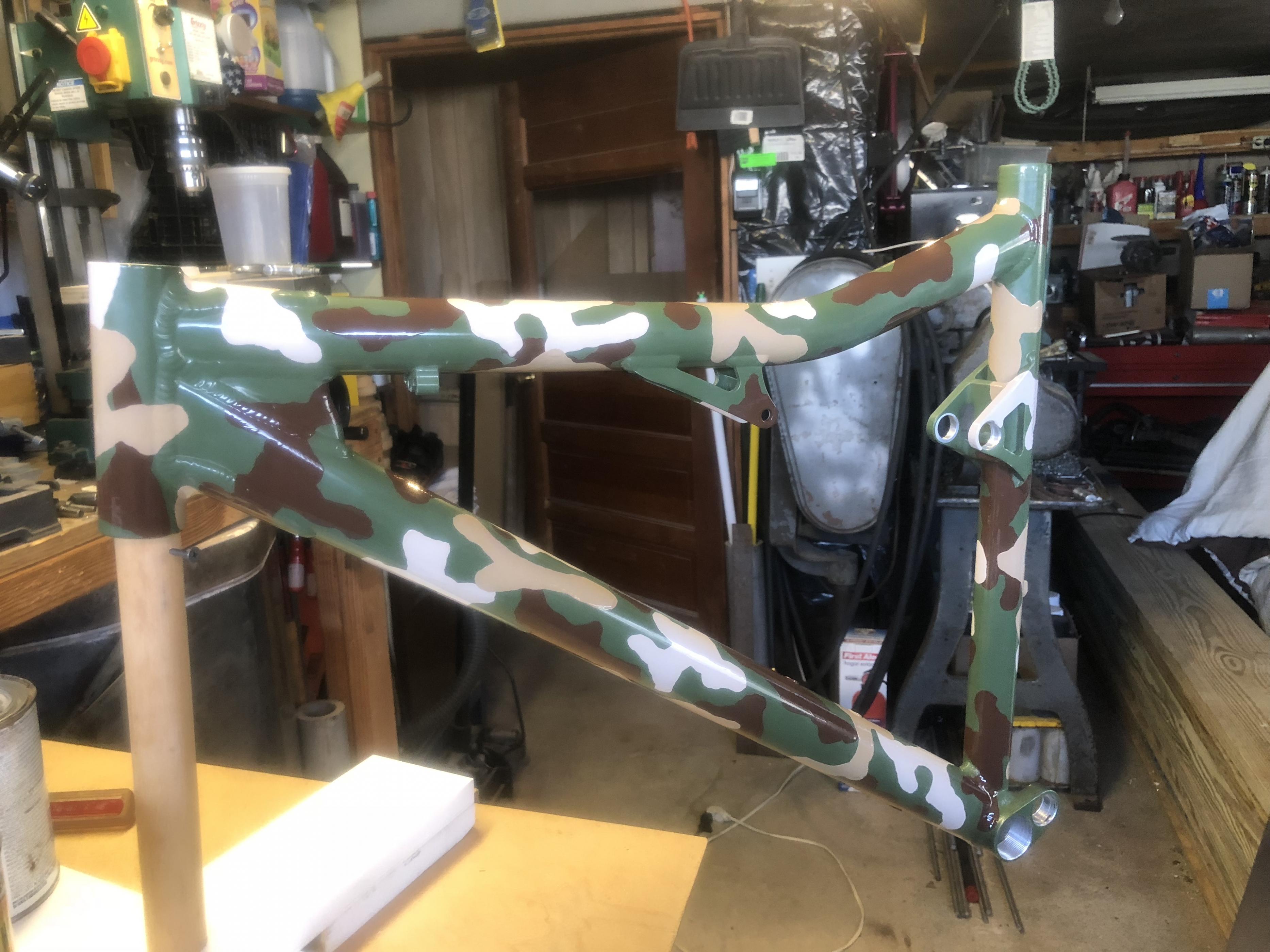

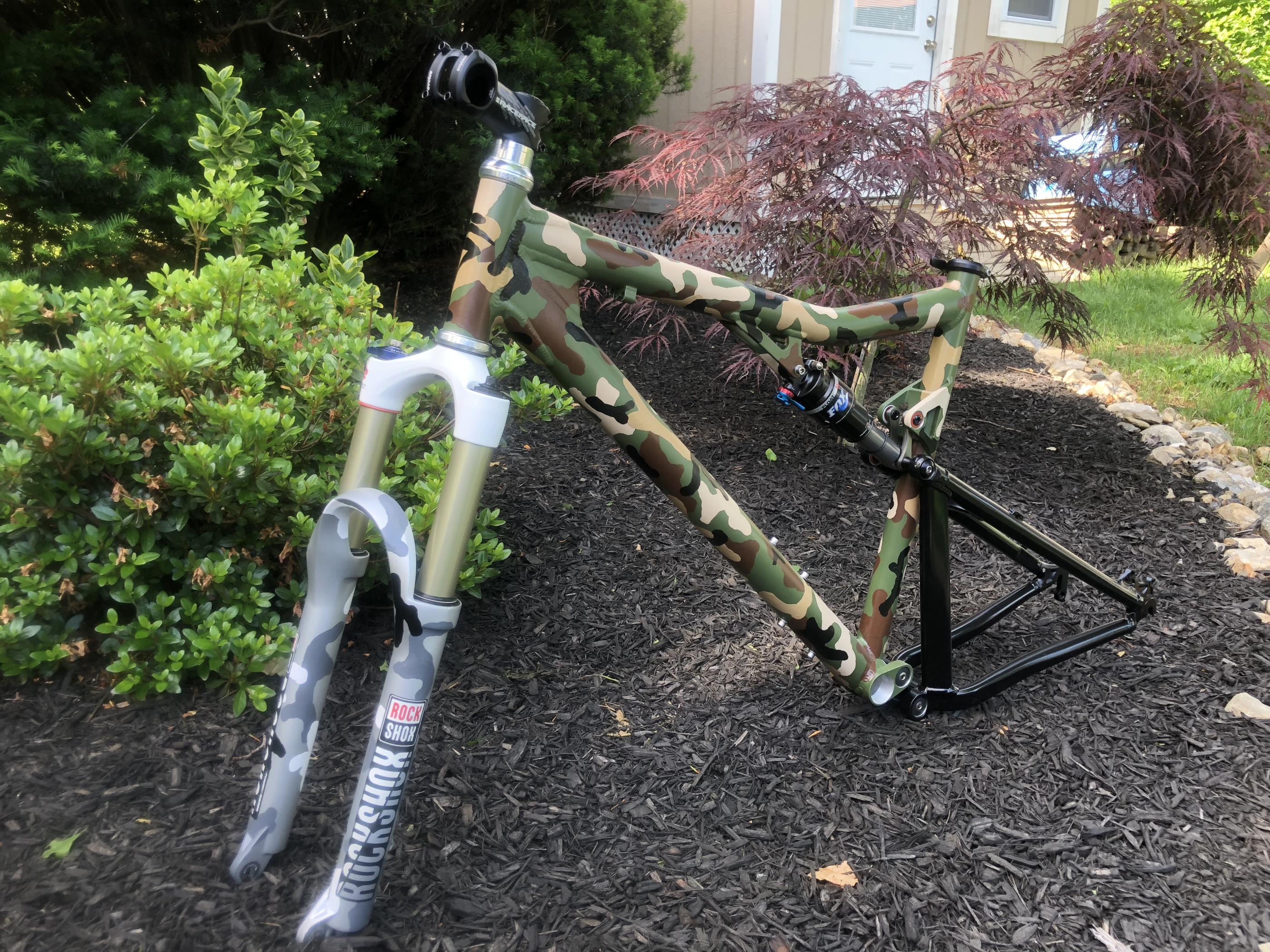

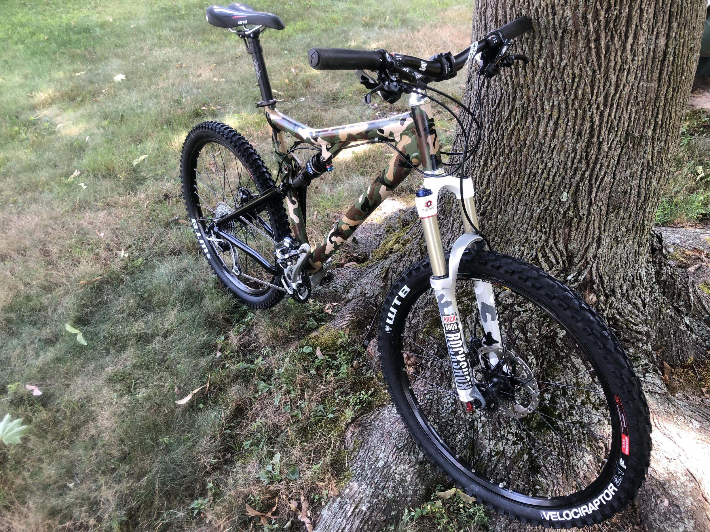

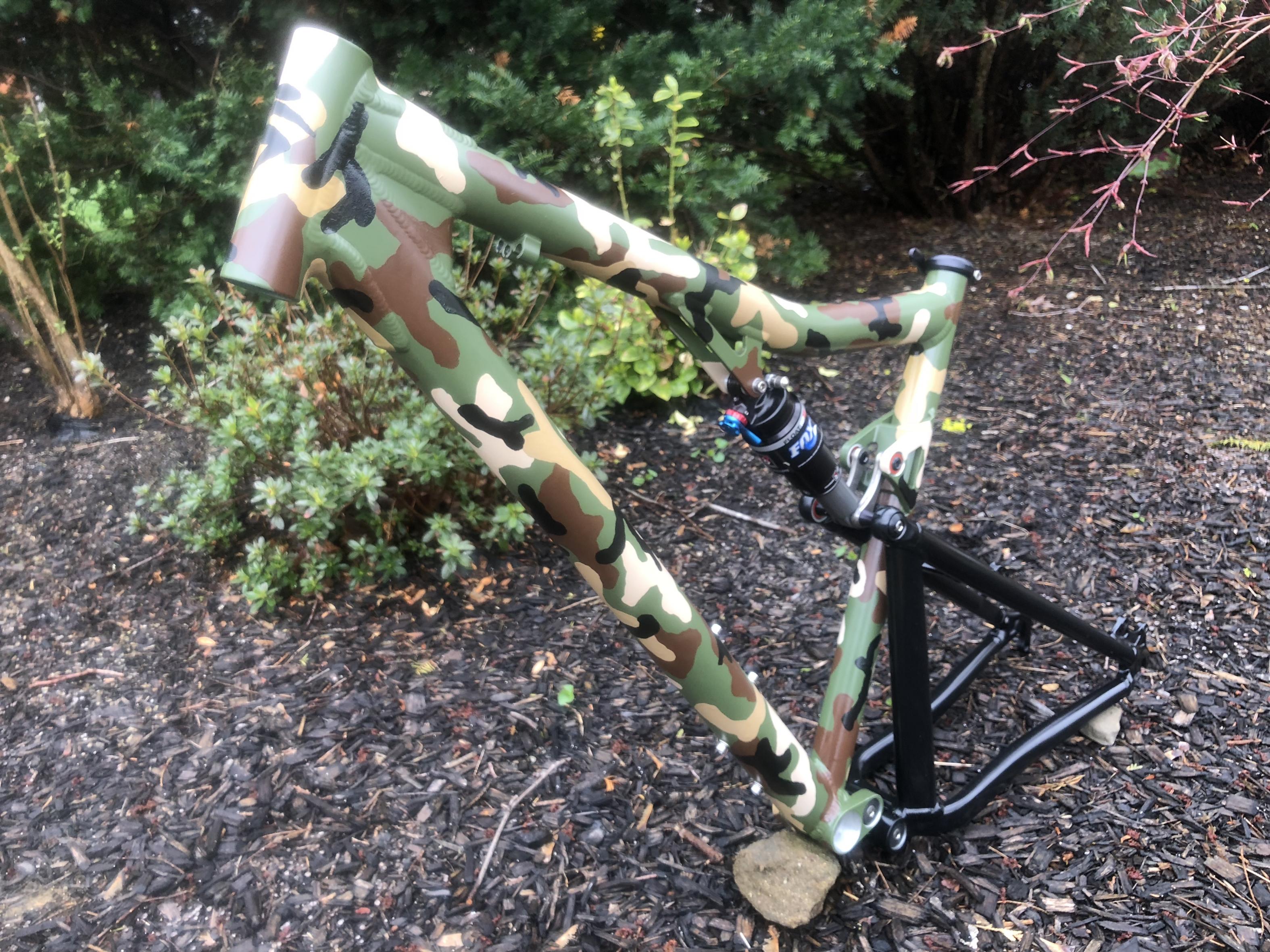

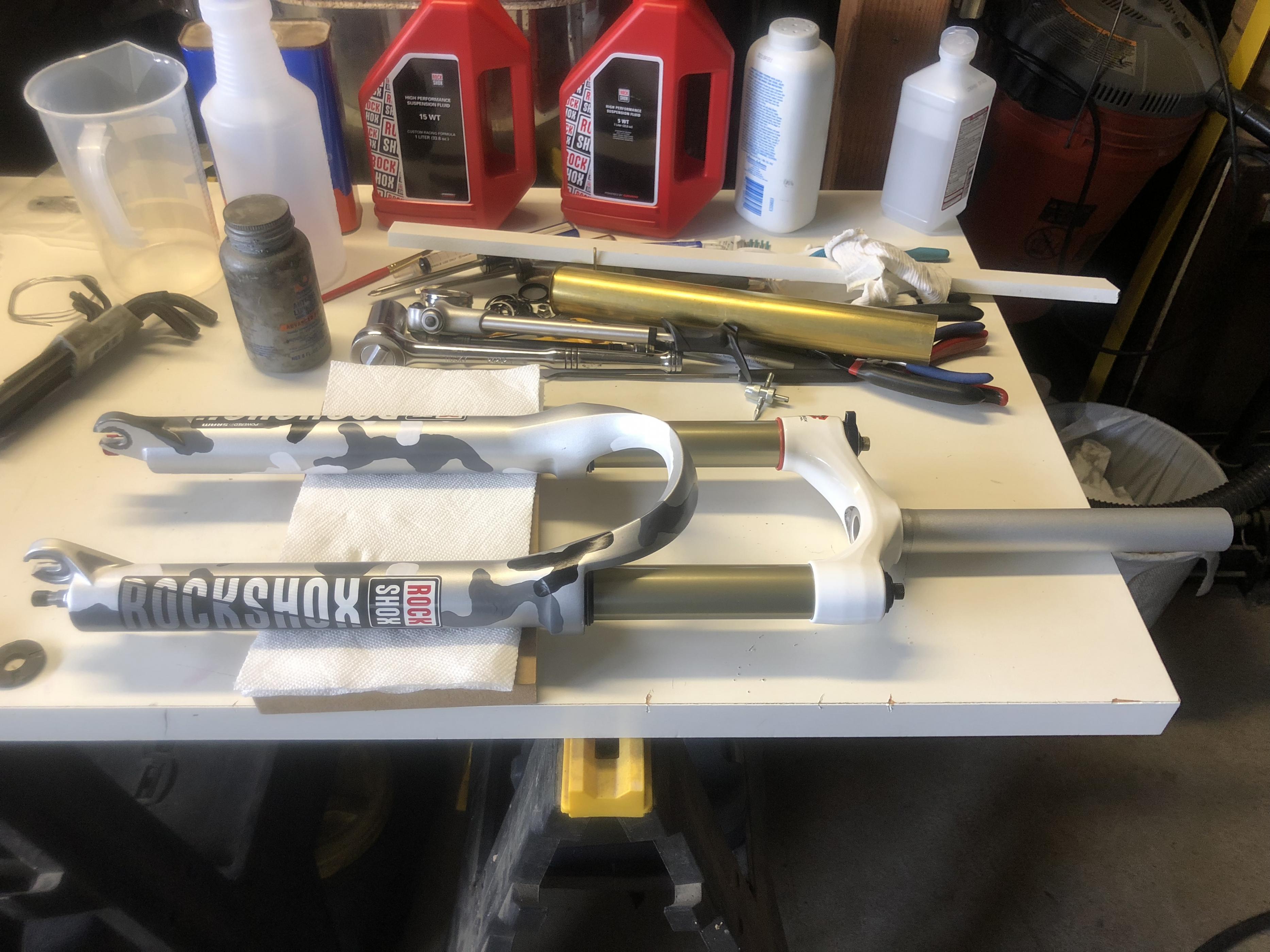

Did a complete tear down and restoration of a used 2008 Sante Fe Blur mountain bike my wife bought me for my birthday several years ago.
Started it somewhere around the end of March.
Worked with the beat up army green base paint and did a camouflage paint job by hand. Baked it in an old kiln I have.
Rebuilt both the front and rear shocks and gave the front it’s own Camo paint job with new decals.
Completely rebuilt the drivetrain and brake system with new parts.
It was finally completely assembled this past month.
Haven’t had time to tune the shocks and drivetrain yet.
The fall riding season is here, so I hope to get on it this week.
