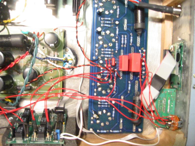

After 2 years of reading and trying to understand how valves work, I finally built my Aikido Preamp. I used John Broskie's octal board with 6sn7 input and output. Mr. Bas' Tube HV power supply board and Mikkel's attenuator with display and remote functions. All were kits.
The build went well and it looks GREAT!
There is a weird fuzziness to the sound, but not a crackle, almost like a poorly tuned AM radio station. It's not a hum or a buzz that would be associated with a transformer noise or AC related electrical field. More like being too close to a microphone kinda fuzzy. Think drunk DJ with a cheap microphone at a wedding kind of fuzzy. I can hear the clarity of the music in the background but it's
hidden by the fuzz.
I think it's a grounding issue somewhere, but I've tried every possibility I can think of and I need help. I just don't know enough to get this working right. I'm very frustrated.
Signal input and output grounds are isolated from the chassis, thanks Gregg; (AKA Geek)
I have run a wire from the -Ve to the chassis...no difference.
I've checked the solder joints on the attenuation board.....nope.
Solder joints on the Aikido board......nope.
I've bypassed the attenuation board altogether..........nope.
I've checked the voltage of B+ , the B+ bias, Heaters and jumpers on the board.....all are fine.
I've replaced the rectifier tube ..........nope.
I've removed the output caps and used .33 PIOs instead......nope.
I'm out of ideas and could use some help. Please.
Any inputs or ideas you may have will be appreciated. I'm happy to give anything a try. But, I am a newb, so speak/type slowly.

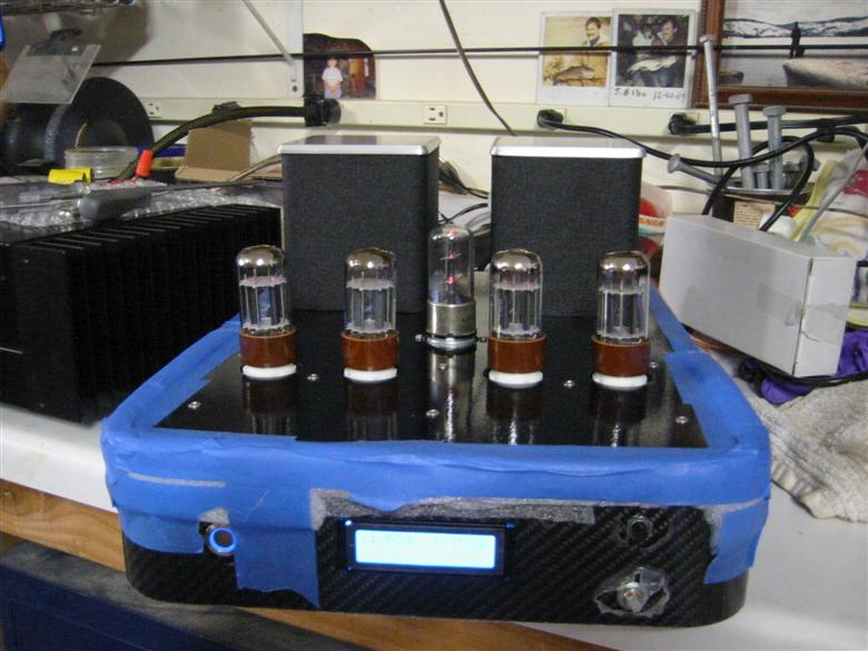

It's taped up so I don't scratch the Carbon Fiber while working on it.
The top I powder coated at home, mods for the PC gun I posted on this website.

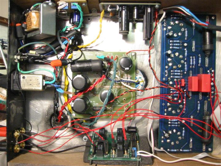

Consider a minimalist approach. Can you disconnect your attenuator PCB (I'm assuming it's the board with the sand all over it), input selector, etc. and just run one set of RCA inputs into a simple vol pot and then to the Aikido PCB and out?
This "stripped down" config will let you figure out if it is related to the Aikido boards or something else.
BW,
I do not have an input selector, so that makes it somewhat easier...LOL
Yes, the attenuator is the sandy unit with the foam underneath to quiet the clackity - clack of the relays. I have tried as you suggested, bypassing the attenuator completely using a very quiet song straight from the CD player to the RCA jacks, then Aikido board's inputs, from the outputs; straight to the RCA jack out to the good 'Ol Haffler amp. same effect........Fuzzy. Heell, I didn't even use a pot and it's still fuzzy
Sorta pointing to the Aikido board, huh....
If a choke makes a PS ring...what does that sound like??? And could that be heard as fuzzy on the signal side.
I have a 8.5 H choke on the Mr. Bas' PS board.
I'll strip her down again tomorrow and try it again, maybe I missed something. (DUHH)!

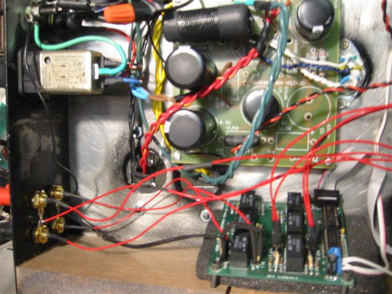

The board with the yellow twisted wires is a rectifier from Broskie that supplies 12.6V DC to the heaters...which are in series to 6.3V.
The other board with the green twisted wiring is a rectifier and a 5V DC regulator for the Display and the attenuator board.
BTW, Mr. Bas' board sits on top of an ABS plastic board with standoffs.

Is there any possibility that DC is going wrongly to some relay audio contact or somewhere in the Aikido that it should not be present? Like to the hum canceling grid feed or the output, due to some problematic cap? Sounds like chopping DC biased signal. I would inspect everything for proper execution starting from the attenuator. You reminded me of a classic album by the way. Gonna spin it on my TT first thing tomorrow.
Salas,
Thank you for taking the time (and concern) to listen to the .wav file.
It does sound like distortion even at low volume.
I have tested the attenuation circuit by removing it completely from the preamp. Fuzzy still. With that in mind it SEEMS likely that the problem lies in the Aikido Board itself. More correctly the way I built it wrong.
Should there be any DC voltage other than in the heater circuit?
I think I remember about 30V DC from the +Signal out to chassis.

That strengthens the scenario that there is AC signal riding on DC and getting clipped. Please examine the Aikido build thoroughly for correctness.
JPS said:Try running heaters with AC supply instead of DC.
I will try AC heaters as a last resort, because it requires desoldering 4 caps on the heaters. However I have heard (read) that AC heaters sound better than DC on the heaters. Is this subjective opinion or audible fact?
Will do! The caps are only rated at 16V, I certainly could have pulsed more voltage than expected during testing, as my home voltage is on the high side, ~ 125V, without a regulated DC the outputs from the TX could have been higher than the ratings of the caps. (Before I built the regulated heater supply)
boywonder said:Is your heater heater voltage biased off of Bas' PS board?
Yes, measured at 100.1V bias...............seems a little high. What do you think? Within specs.? Broskie recommends 1/4B+ for Bias, Others recommend 1/3B+ bias.............what to think???
