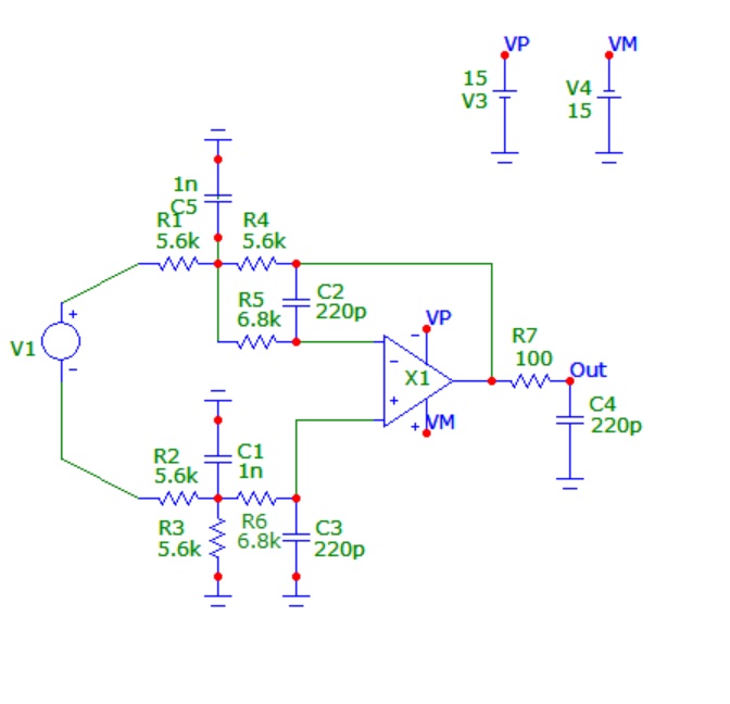

I am trying to follow this scheme but there is no "green ero" cap in latest version, so could someone pkease point which are the caps to be switched to 2200pF here?
All of the smaller, square capacitors are polyester I beleive, and the values are in code next to each one, as well as on the parts themselves.
The 220 pf ones are "221".
I replaced them all with some fkp1, or fkp2, depending on what the local parts store had around.

Thanks, I have good experience with soldering and I already removed the bypasses, but my questin was different:
some of the caps are rated 220pF on the board, but the scheme suggests switching some of them to 2200pF (2.2nF), so I was asking which of them are to be switched from 220 to 2200pF...
This is the latest board in stock version: which ones are to go from 220 to 2200pF..?
It depend of resistors valueThis is the latest board in stock version: which ones are to go from 220 to 2200pF..?
I'm happy with this filter
Thanks, my measurements show that resistors should be the same values, so I was asking which caps were suggested to be switched to 2200pF by Dario in that post...
None...
The green EROs (2,7nF) were on positions marked with 222 (2200pF or 2.2nF), in your board they're blue caps.
Ah, you means these 2...
Yes

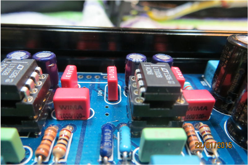

Do anyone else have 2 Red Wima 1000/100v on line with the OpAmps.
Look like it's the same on this picture...
I think they are 1000pF / 1 nf.. Mine was with 100nF here so it's very
different DAC9 I have..
I have very little output gain in mine.
/Thanks Michael
/Thanks Michael
I have 1000pF Wimas, there.
