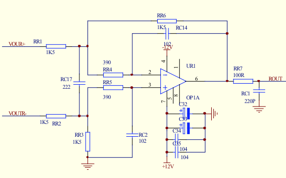

I had a look in the schematic, it is clear, the potmeters are there to control the voltage. see picture.
Yes I take a measure with one probe between the diodes DW1/2 on either
pin 4 (-) or pin 7 (+). The trimmers controls either pin4 V- or pin7 V+.
Set them from +-12volt to +-15volt. Most Op Amps can handle 15 volt, but
please check it before you do the adjusting.

Another question,
My Dac 9, V12 (assembled by supplier). has different resistors. RR1 = 1k, RR2 = 3k. In all the ref schematics these are equal, being 1k5. See also pictures.
I wonder now, is this on purpose, or would it be an improvement to change.
What are your experiences?

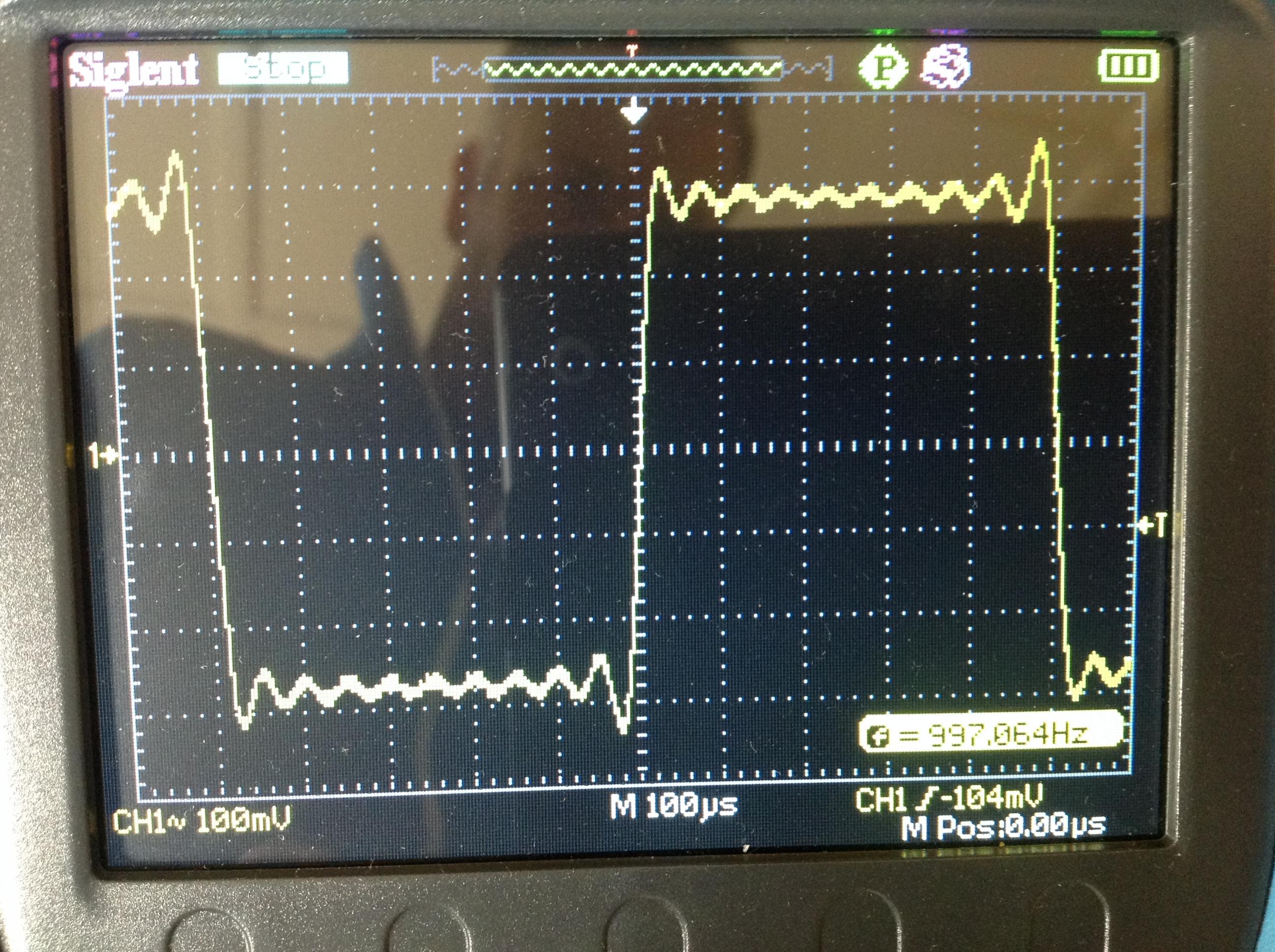

During my first checks, I putted a 1kHz (32 bit 192 k generator) on the dac. See attached the output. I was puzzled how to get this one better. Probably, reducing the filter will help. I will check in the next days.
Olaf
Hi Olaf, most of that ringing is caused by the digital filter. Unless there's a slow roll-off function in the DAC, there's nothing you can do about it.
There does appear to be a little overshoot caused by the analog filter - it's probably a Butterworth function. Changing cap values so that it's closer to a Bessel function will help here, but you need a simulator or proper filter design software to calculate them.

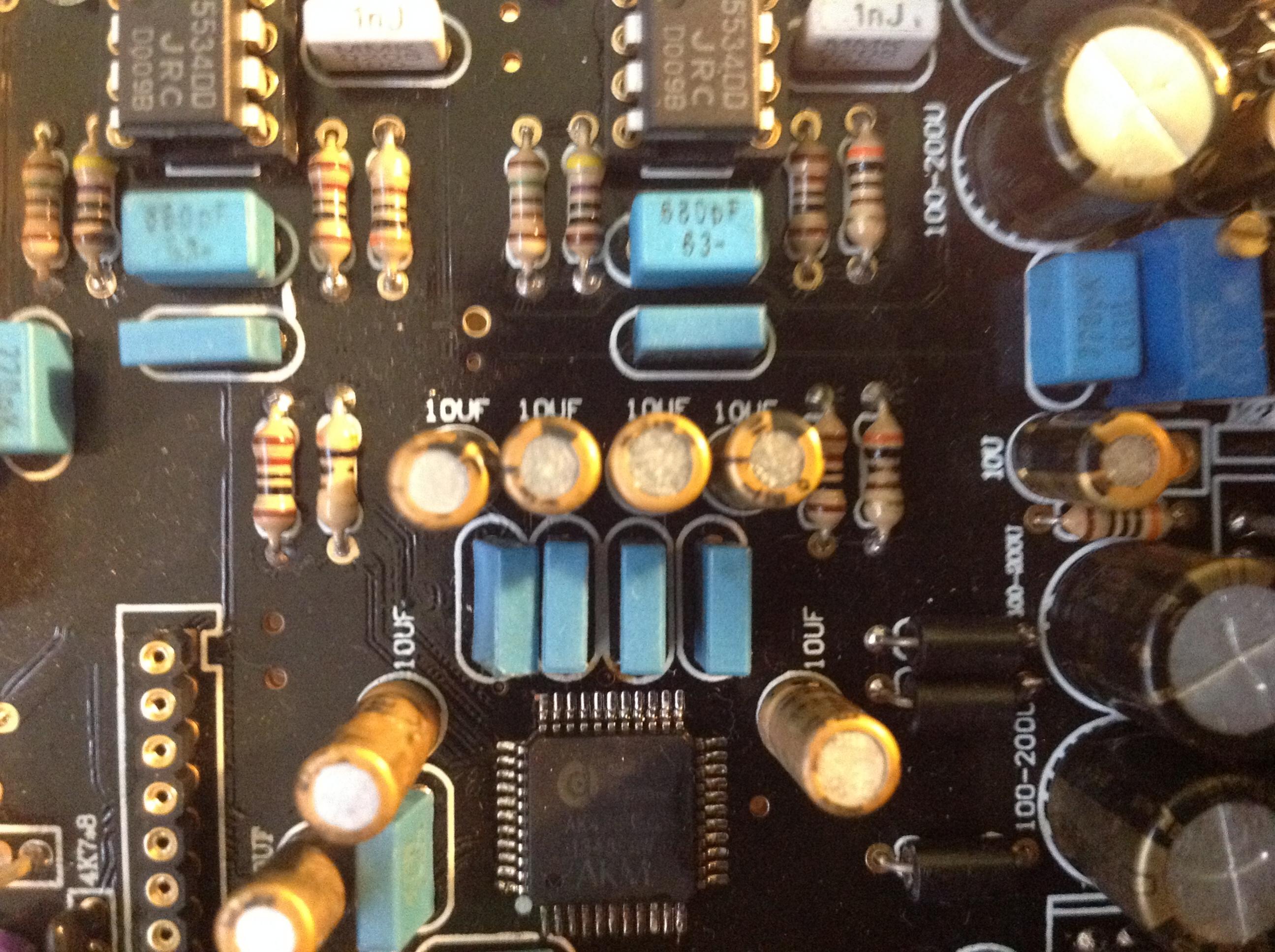

Best decouplig AK4399
summing up around the chip for the coming members:
1. DVDD § BlackGate STD or Niobium AVX NOJ or Sanyo OSCON
21. VCMR § BlackGate STD or Niobium AVX NOJ or Sanyo OSCON
25. VDDR § Elna Silmics II Black/Gold
26. VREFHR § Elna Silmics II Black/Gold
30. VREFHL § Elna Silmics II Black/Gold
31. VDDL § Elna Silmics II Black/Gold
35. VCML § BlackGate STD or Niobium AVX NOJ or Sanyo OSCON
41. AVDD § Elna Silmics II Black/Gold
all 10uf as the AKM recomedation but without bypass.
thanx to ClaveFremen and others in the thread.
