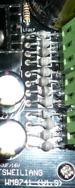

after failing & smoked 3 sets DAC5 kit, finally i gave up and ordered a pre-built board, together with the 1ppm crystal, opamps (47920HA), upgraded voltage regulators and a CM6631a usb interface. (make sure nothing goes wrong this time.)
works flawlessly with usb & coaxial. the sound is good & clear.
may someone teach me what is the name of those rectifier diode in red circle? are they good?
