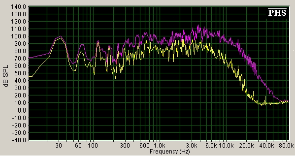

WHG: For those that may be interested in the spectral content of musical instruments, reference to the following article is provided.
There's life above 20 kilohertz! A survey of musical instrument spectra to 102.4 kHz
WHG: Here is an on-line listening test for those that might be interested in determining their distortion detection threshold:
Listening Test
