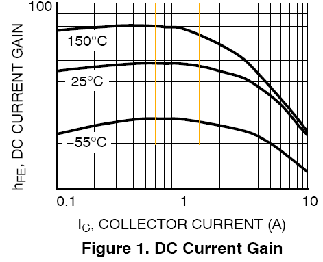

"Nonlinear distortion" is not audible
To qualify, you are talking about speakers? Branching out to amps, higher orders of HD (and higher orders that are greater in level than lower orders) are long suspected to be audible.
An example is the biasing of an output transistor at these two points (assuming this is the exact cause). One is colder and somewhat edgy, the other is warmer yet is engaging.
