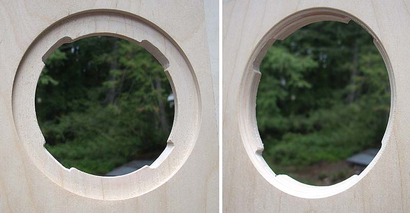

Second, after many months occupied by finishing my grade 11 school year and working throughout the summer, in the last few days I have found the time to finally assemble my ML-voigts. They are now about 80% complete (with only the driver hole to be cut and the interior baffle to be made) and I'm looking for clarification about the driver placement.... Basically I need to know if the driver has to be countersunk. I don't think I have access to the tools nor the woodworking skill to do so..

The Mark Audio drivers (of which EL70 is one) have a fat circular bezel. If this is left unrebated there will be an increase in the diffration signature, If you can't rebate the driver, you can use various methods to minimize the issue.
Pretty much it these amount to faking a rebate. Find a piece of material the thickness of the bezel (dense wool felt, wood, cork, plastic), cut a hole in it that just fits around the bezel and then place it over the driver and attach to the baffle.

Or do as I typically did and make a second full size baffle 'veneer' to both rebate the driver and stiffen it up, 'killing two birds with one stone'. ;)
Note that the rear of the hole ideally needs to be beveled out at >45 deg, but no need for any fancy router work, I just dug it out with a really coarse wood rasp file until I was able to afford an industrial strength Dremel-like hand held grinder/wood rasp bit to make quick work of it.

Alright thanks dave, I think I'll take my chances with getting my dad to use a router to attempt to countersink the driver
Also, I don't fully understand the angled interior bevel. How can you screw the driver into the enclosure after effectively thinning what it's being screwed into

The MA baskets are very open at the back so you can get reflections from a vertical wall on the cutout. You can bevel just that part not near the screws. If you built with ply like we do, what is leftover provides enuff meat for the screws.
If you want to go nuts something the heads in the direction of all-out (see picture) works too.
dave

P10 states about the MA drivers having very open backs, which is true, but in contrast to some Neo drivers which are very open, In my experience, the MA drivers are open but transversely rather than axially, with respect to the cone, so naturally and unfortunately reflections will occur. unless rounded off the inner edges have a profound affect in these cases.
