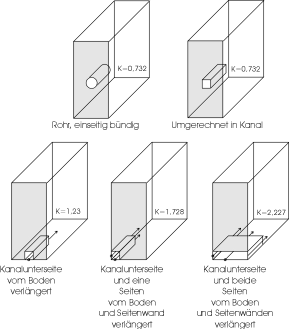

same area/length as pipe
dave
The shelf vent shown will have a considerably different end correction that will tune lower than the equivalent area/length pipe, though in this design's case it probably isn't enough to matter in-room, but you can check it by recalculating it and convert it to a longer pipe of course:
GM

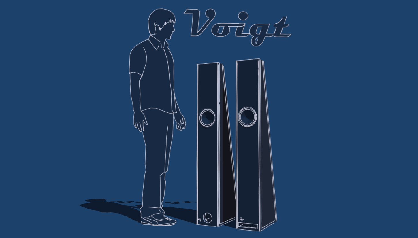

You say traffic light I say robot :O
I added the ports but not the feet yet (lol, kinda don't like them - the feet).
I have to say the square port is lots more apealing, as you are not looking down its throat into the cabinet's tonsils...
