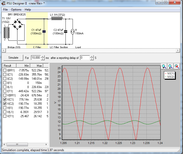

They used to be rated for "nominal DC current", in post 33 you can see a printscreen I could make from google cache. When I wrote the producer, he changed the whole description of the chokes, including this information.
I am attaching what I actually built and measured. The primary of the power trafo was fed from a Variac. As I don't have seas of time to experiment, I did a test at low voltages - shouldn't matter for inductance - using 12,6V filaments as loads (12SN7 is 300mA, 12AT7 is 150mA) and some (measured) 47uF electrolytics.
After finding out that 450mA (12SN7 and 12AT7 in parallel) was over the top I kept the 12AT7, and lifted the Variac until I got about 12,6V DC across the filament, good for 150mA DC. With 20H the simulated ripple was minimal (5mV or so...) As I measured about 900mV, I decreased inductance until the simulated output was about this 900mV, ending up with 1H worth of inductance.
I did not have the time to test it in a choke input PS yet.
Erik, thanks for expanding on the test you did. If you use a 1sec reporting delay in PSUD2 then the VC2 Max-Min=12.3-11.4=0.9Vpp, which is about 0.32Vrms (as harmonics are low). Perhaps you measured 0.9Vrms, not 0.9Vpp.
If choke inductance is tweaked to simulate 0.9Vrms on output for that PSUD circuit then inductance would be 0.4H.
If you used an 84 ohm resistive load (which would be more appropriate imho) with 150mADC, then inductance would need to be tweaked to 0.38H and VAC to 20V. Choke current varies from 110mA to 187mA.
For comparison, 40Vrms across that choke causes just 3mArms. So one observation from the test is that the core is pretty much fully saturated above about 110mApk, in which case the spec for 500mA (AC or DC) doesn't look right.
To get 500mArms AC only current through that choke (if it had 20H inductance), would for example require a 100Hz voltage across the choke of 6.2kV.
Did you ask the manufacturer to explain how the 500mA AC current spec was derived?

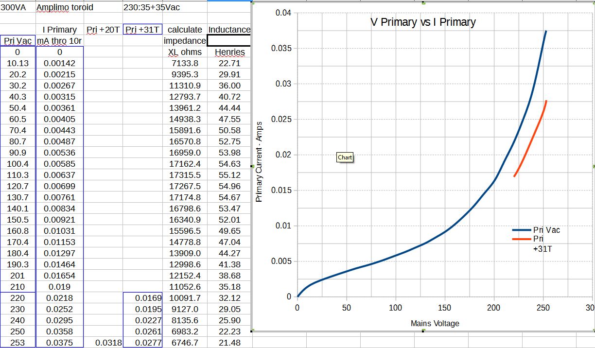

I posted a toroid transformer Iprimary vs Vprimary with the secondary open in another Thread.
In effect that is an inductance test.
Here is the diagram from excel/openoffice
Note that inductive reactance and inductance peak at ~110Vac. The peak will be between 110Vac and 115Vac.
Note how low the inductance is at the extremes of voltage. less than 50%
This is an AC test. It did not use DC to make the saturation worse.
This is typical for all continuous iron cores
They gain in inductance as the ampere turns increases
then as the core starts to saturate, the inductance begins to level off and then falls as saturaton becomes extreme.
If one wants an inductor that is impervious to flux saturation effects, then it must be air cored.
The next lower standard is to use a gapped core, or a core that includes microgaps (iron dust and similar types).

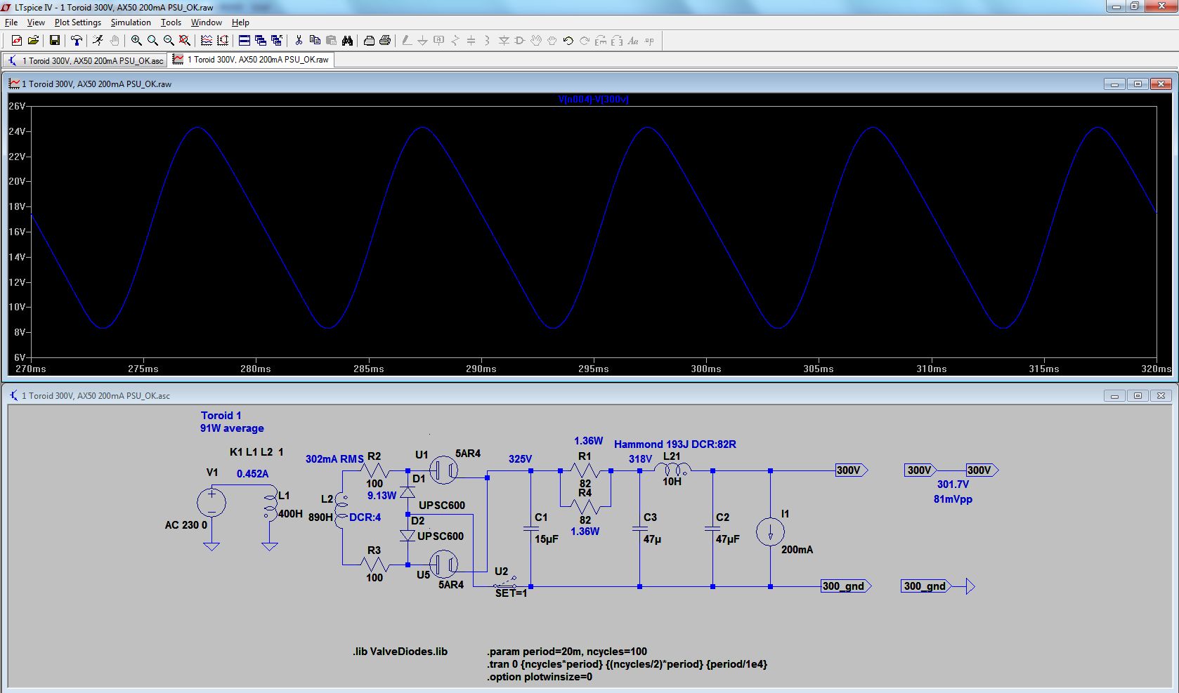

This is one of my active PSUs (300V, 200mA) simulation. I corresponds to the actual measurements.
The toroid transformer is capable up to 500W, secondary is 340V, 300mA (DCR:4R). The real rectifier tube is AX50 (mercury vapour).
As you can see, across the brutally large choke (Hammond 193J: 10H, 82R DCR) about 16Vpp sawthoot (on the 16.4V average DC) voltage.
