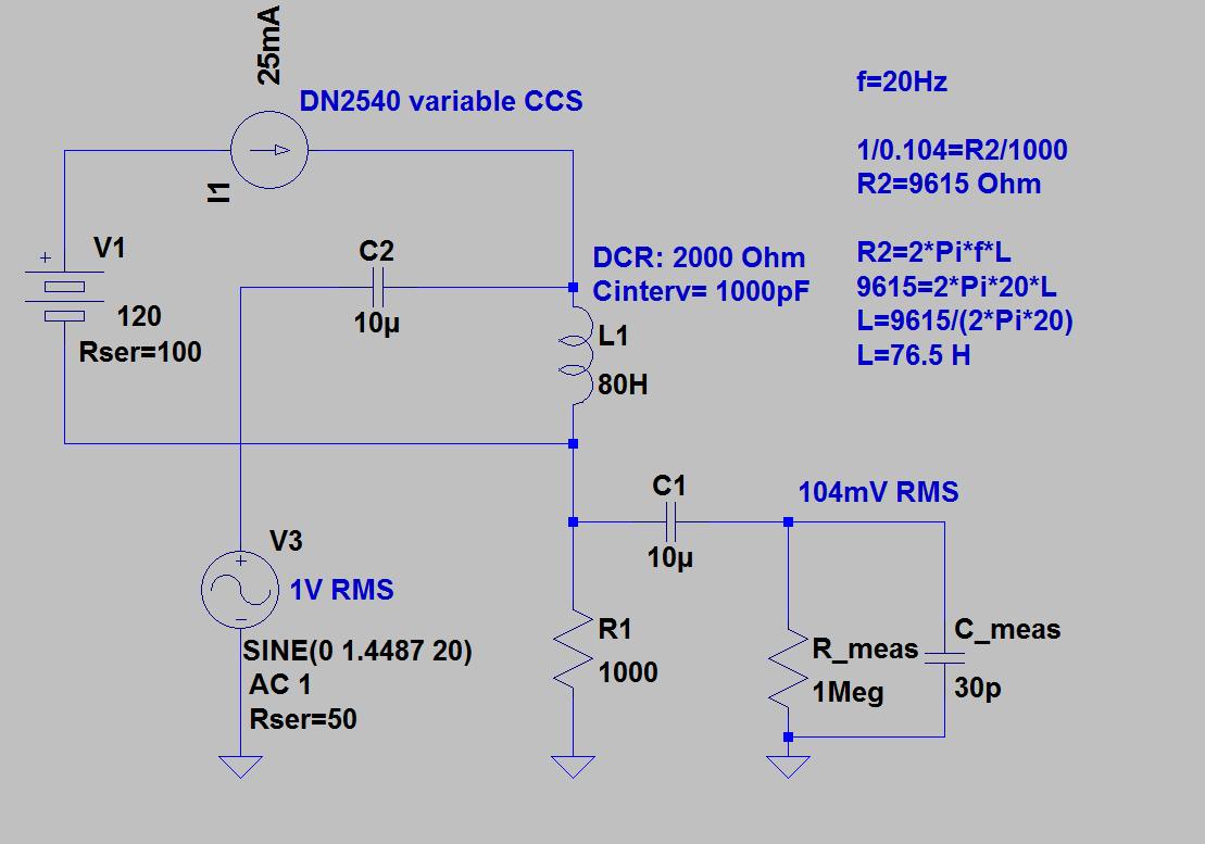

Thanks for your post! I used a very similar method (applying DC current from a high impedance source + AC coupled signal generator, measure AC reduction to obtain reactance and L) to test some Hammond chokes, where the values matched - but because of "clumpiness" disassembled the whole thing, so testing in a PSU was easier with the toroidys. But I will surely make a similar setup again, but less clumsy, like yours!
Main thing is, I contacted Toroidy, he agreed that there information on the website was not complete and made sure that it is better now. I think my tests and this thread are a step in the good direction of informing each other.

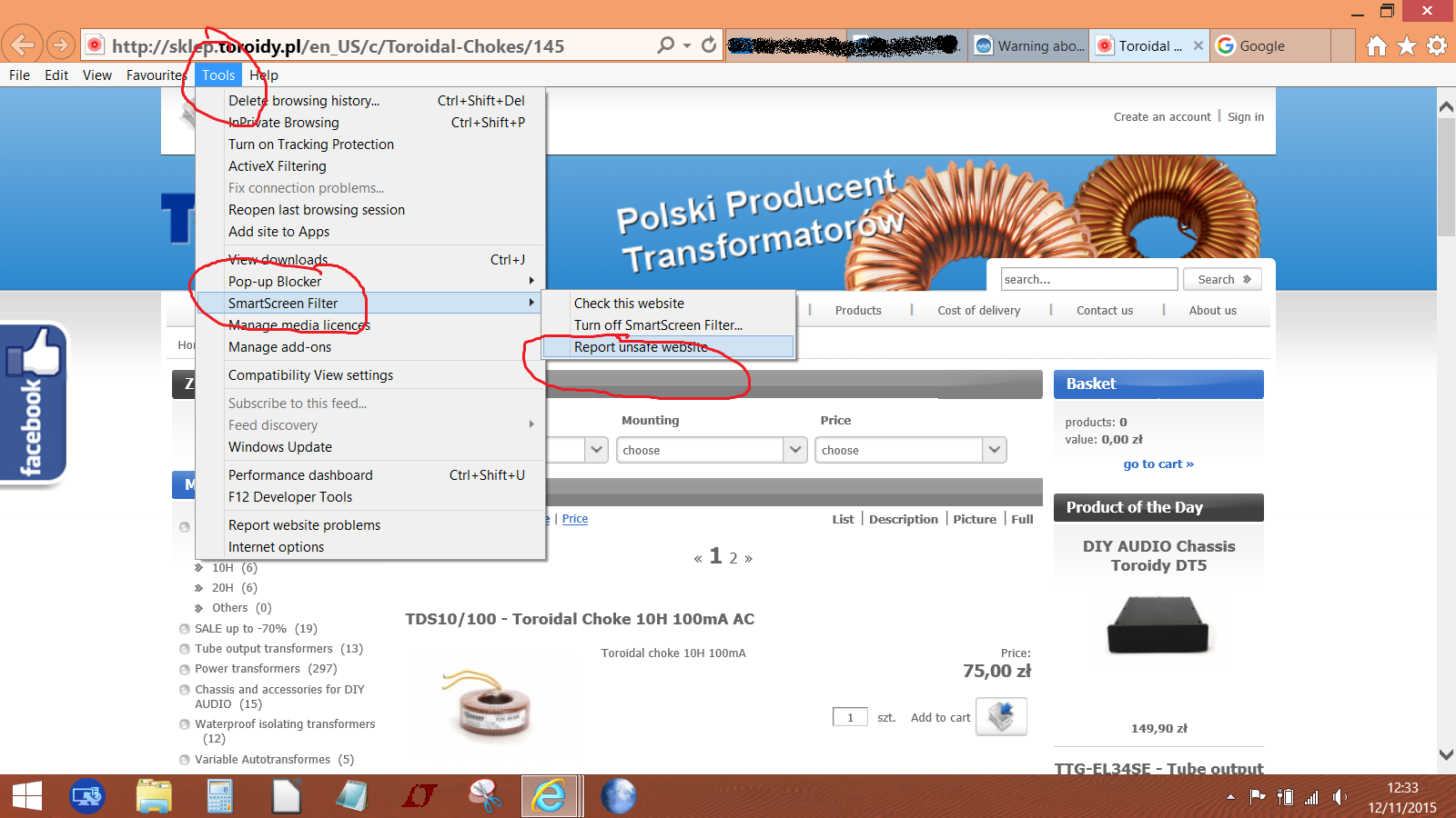

Be careful with the links as there is malware in both of them and you may get infected if using a windows based system.
How did you determine that ?
If you have doubts and are using Windows then take the time to do a couple of clicks and report it. (I found no problems by the way)

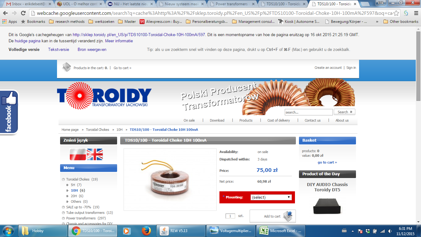

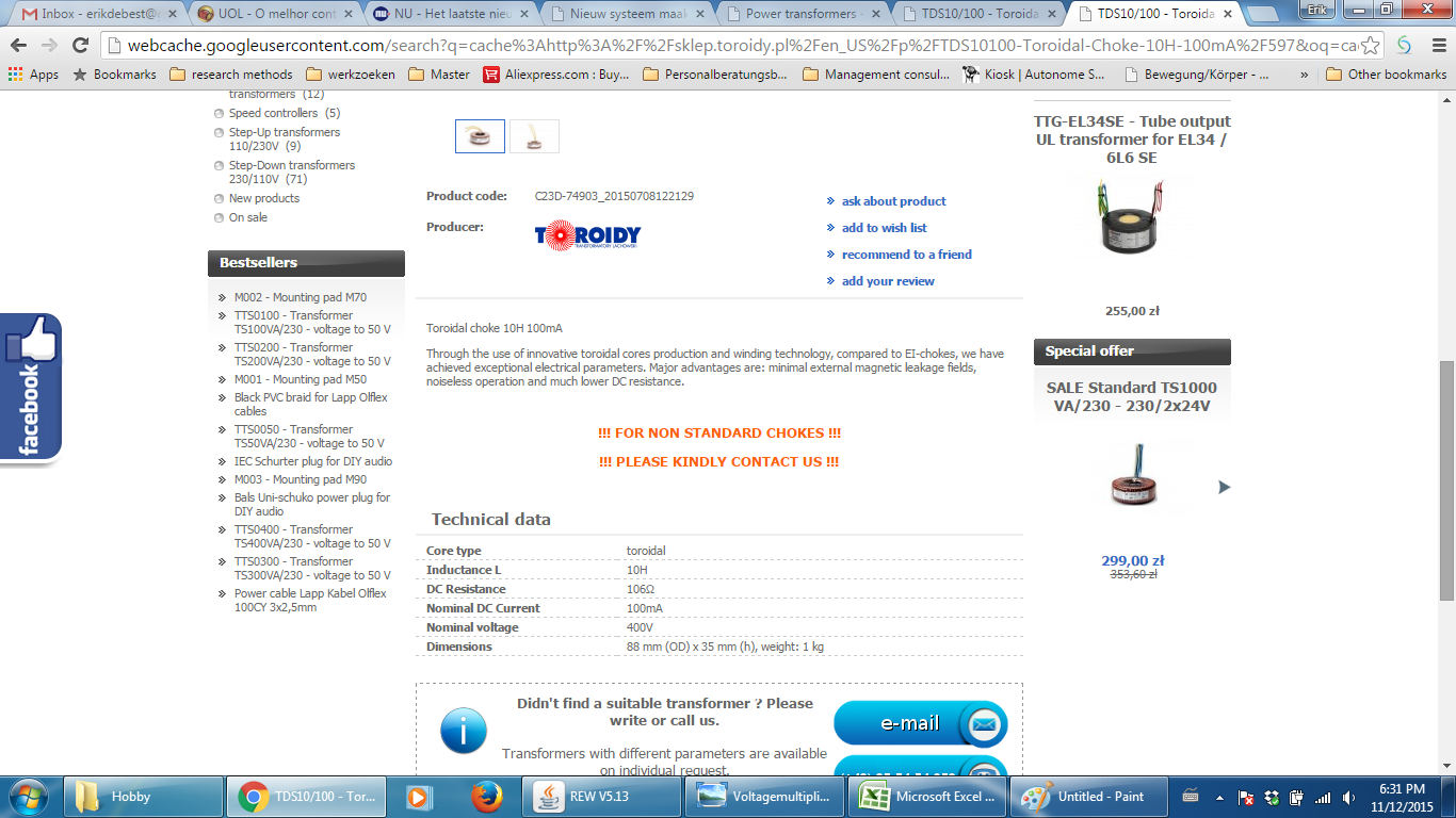

If you google and look at the cache then I don't see anything about DC current, so based on that it would seem that you were naive.
Dear mr Robbins,
I learned a new trick today - no, it is not manipulating pics in photoshop - but to use the cache function. See the attachments, quite clearly stating "nominal DC current". But maybe you have seen something different?
When I wrote naive, it was referring more to the fact that I could know beforehand that there was something wrong with this info.
Excellent sleuthing of google. Seems like they updated their website incrementally - no mention of AC in the title or that inductance would drop with DC in the simply accessed cached version.

Are you testing the choke with 120Hz ??? Do not use 1kHz or anything higher, since chokes usually have high winding capacitance that will monkey up the measurements...
You can test it in circuit a lot easier, unless if you have an inductance bridge with the ability to apply a DC bias current...
A gap is usually required for linearizing the inductor over it's operating range... Unless you are making a swinging choke....
The quick and dirty way to test it in circuit... Put a AC ammeter in series with choke and a AC voltmeter across it....adjust the BIAS of the power tube to vary the DC current...
WHen using a DVM for the ammeter, just switch between AC and DC to note the measurements.. Your (AC Volts/ AC Current) will give you reactance... Divide by (2*pi* freq) to get INDUCTANCE... for 120Hz from a full wave bridge divide reactance by 377 ... Vary the BIAS of the valve from near cut-off to some high current that the tube can sustain for a just a short brief test... and note this DC current.. The true reactance you are getting is r+jw and you would normally vectorily subtract the resistance but most cases it is insignificantly small.. Make a graph of L vs DC current ... The applied AC ripple would be whatever you measure for your given amp and capacitor values.. If you use a scope to look at the current and voltages you can determine the Bsat point...

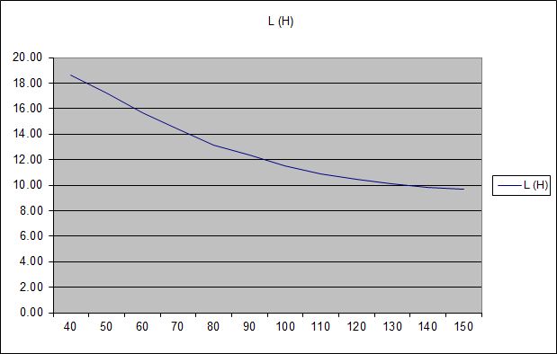

I tested the choke in the attached circuit, so at 100Hz, where I suppose it would work best. I started with 20H, and the ripple on C2 was minimal. Then I reduced the value of H until I came up with the ripple I actually measured, and this was about 1H at 150mA DC.
For previous tests, on Hammond chokes, I built a circuit similar to what Euro21 posted, and I plan to build a more definitive one soon, to test all sort of transformers under DC load. But the results of the test in the PS are, I think, quite clear that I tested the chokes before saying something? Also, the manufacturer now clearly states that under DC current the inductance will drop - he didn't say that before.

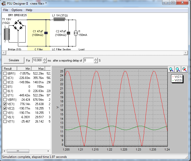

Some chokes, such as fluorescent ballasts were designed for AC only, but are fine for use as chokes passing DC in amp power supplies - the main thing is to appreciate when the peak current level starts to get too far in to the saturation region - that peak current level can come from AC, DC or AC+DC, the choke doesn't mind at all.
To get good benefit from PSUD2 you need to appreciate what average L is likely to be presented for the current through the choke (PSUD2 doesn't model L variation). L versus current measurements are well worthwhile, and can be done in a few ways - the technique I use is in the link:
