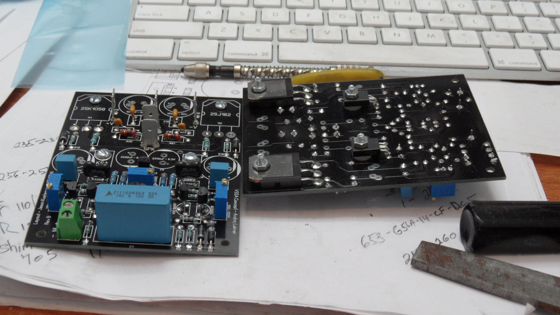

A quick snapshot with the CM on-board. Now time to mess with the CCSs, looking to see if I can integrate the 1Q+LED for those who like BJTs and the simple JFET for those who like that better.
Any other observations or suggestions are welcome...

Getting There
Jason,
Just waiting for the rest of my order to come in. :)

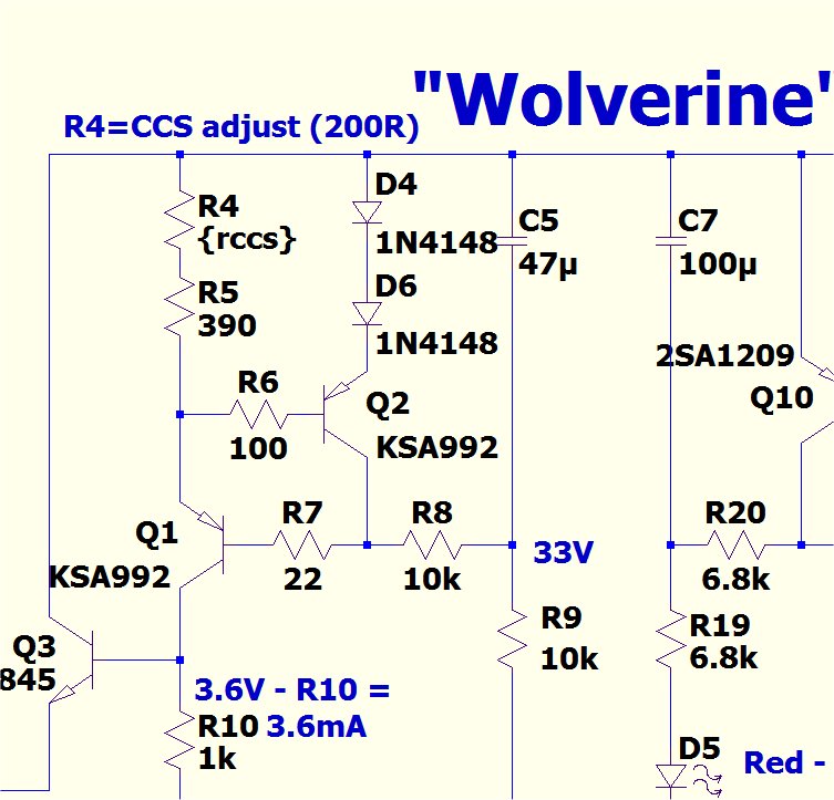

LED Vf drops with increased temp. , offsets it's associated transistor's pos.
coefficient. This effect is increased with low LED I(f).
The LED CCS generally has slight negative Coefficient.
2Q CCS has a definite positive coefficient ... best used in a circuit that
has a second stage with another CCS (like the "blameless") .
In this case they cancel out.

You can offset the 2Q's positive curve with a diode in series at the
emitter of the 2'nd transistor (the one without the Re).
The Vf of the diode will cancel the Vbe of the 2Q.
try 2 diodes for more cancellation .. (below D4/6).
you may have to double Re to maintain the same Ic for your CCS. :)

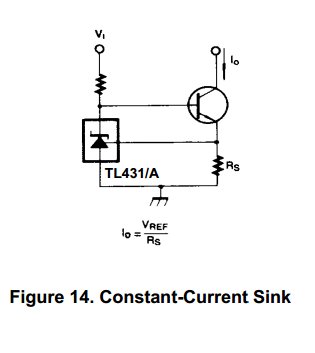

PS - If you are going to add the multiplier , it ... plus the led CCS will beat the 2Q.
You also could go all out "anal" and combine a temp. compensated 2Q (or 3 pin TL431 CCS - below 2) for the "ultimate".
