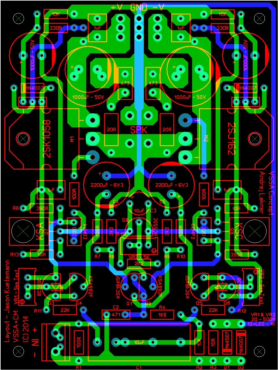

This should be getting close to a workable version with an integrated CM to feed the IPS and VAS. I included some pads for wire links to either power the CM off the main supply or to leave it off to feed the CM with boosted rails.
I have not yet messed about with the CCSs, at least as yet. I noticed that it is also very easy the bias the front end just like the PeeCeeBee version via resistors. This allows for three options for builders, the originally intended 2Q CCS, the 1Q+LED CCS as first noted by Sheldon, and finally the PeeCeeBee style resistive bias.
By leaving off Q3, Q4, Q5, Q6, R11 and R12 and installing two 10K resistors, one from Q3's base pad to Q4's collector pad and the other from Q6's base pad to Q5's collector pad, and using 10K trimmers for VR1 and VR3 we can use the current boards as a PeeCeeBee for those who want the fewest active components possible. I'd still leave Q8 for biasing as opposed to a diode string, fully adjustable bias is too convenient to throw away, though possible too.
Any comments? Silk is not fully worked out yet, so don't hang me out on that just yet .

You are rockin' ... J.
Having options is nice ...but it could confuse some... .
Your layout is cutting edge ... this simple CFA will most likely
be double digit PPM in normal use.
Some of your techniques were used on the "CFA-X"
OS
Thanks, OS. Again your comments are always welcome. I'm very humbled you used the phrase 'cutting edge' to describe my efforts .
I agree that too many options can be a bad thing and could confuse a newer builder - especially considering this design's simplicity is apt to attract a builder with less experience. I think I will try to curb my desire to make this 'universal' for a few reasons with avoidance of confusion being paramount.
I just thought I'd mention the resistive bias since it is another happy accident and requires no cutting or modification of the board at all. Neither the 1Q+LED CCS or the resistive bias techniques were considered during layout but fit perfectly as is.
In any event I will be a little while before being able to get this ready for production but will post some final images when I am ready to move forward.

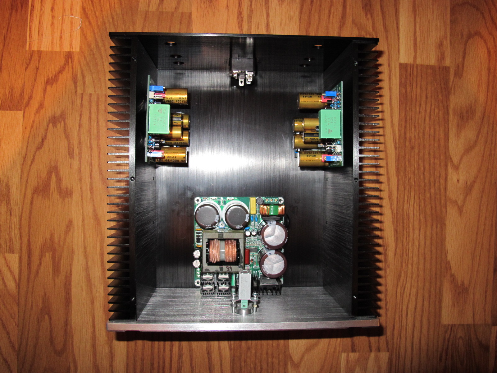

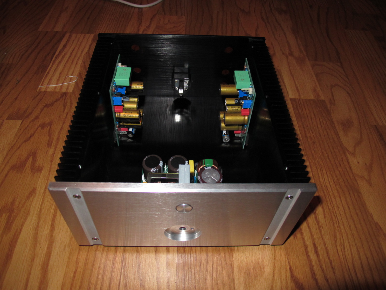

Funny how clean an install can be using an SMPS. Have you fired it up with the SMPS yet? I can't hear anything that would lead me to believe it isn't just as good as my trafo and cap multiplier. Less than half the weight and space.
Beautiful case.
Blessings, Terry
You bet the install will be 'clean' with this SMPS in there. This thing is about the size of a 250VA toroidal transformer, never mind the rest of the supply. If it works as well as I hope it will I may never use a linear bulk supply again, except perhaps to recycle parts from old equipment.
I haven't tried it yet. I need to get some more mounting hardware, so it will have to wait until it can be properly mounted. My only debate is wether or not to centre the amplifiers on the heat sinks, which brings them in closer to the SMPS, or to leave extra physical room as pictured.
The case is quite nice. I'm planning on some kind of insert to block off the volume control mounting location. Perhaps a nice aluminum disc, raised and beveled with a nice 'VSSA' engraved into it. The piece I can machine in the garage and I likely have stock in the appropriate size too.
Nice work!You bet the install will be 'clean' with this SMPS in there. This thing is about the size of a 250VA toroidal transformer, never mind the rest of the supply. If it works as well as I hope it will I may never use a linear bulk supply again, except perhaps to recycle parts from old equipment.
My opinion is,you MUST centre the amplifiers on the heat sinks.
The reason is that centre,is the only way for isothermal distribution.
Waiting for listening test with SMPS.
