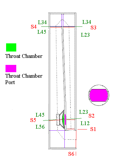

The horn shown in the original HR shot on the site does not math up to what is shown in the plans.

I did use the parameters from his site to see how the 3015lf modeled. That would be the source of the discrepancy if they aren't representative of the plans. Now I just have to figure out how to put the dimensions from my copy of the plans along with the 3015lf parameters into HR. What's the best way to go about reverse-engineering the dimensions into the program?

It does indeed match up quite closely now. I took some room measurements today (sans EQ) and was suspicious about the levels I was obtaining, which were hovering around 95 db. I couldn't get 2.83V to the driver cause the amp I was using was digital and had discrete indexing for the volume control. It was either 2.66V or 3.02V, so I used 2.66V. Even still, the results seem fairly close (given room interaction of course). When I get a chance to measure outside, then we'll really be able to make a solid comparison. Thanks for the hook-up Soho!
Had some people ask, so this is how you can figure it out.
In the center of L34 is an increase in size, so it should really be split into two different section. It is a minor increase, so it isn't that big a deal. The main problem is that there is no real flare for that portion of the horn.
I just noticed the little chamber at the bottom of the driver shortening L12. I didn't notice it last night. Subtract 8.9cm from L12 in what I posted before to add it back in. It cleans the impulse response up a little.

soho54 said:How did you calculate S5-S6?
I just did a quick calculation based on the plans from his site. The red lines indicate where the S positions should be. W x D. With S5 pretend the driver isn't there, and measure what the distance would be if there wasn't a hole there.
If you mean the distance, since the bend is 90deg I just connected the centers of the sections before and after the bend to better match a wave true path around a tight bend, just like the dashed line shows.
As I just did this in MS paint, there is an error factor there. If I did it in sketch-up I could be more exact. If you can measure these points on your own build that is what I would do. You should be able to get the bottom half directly, and the upper bend from the outside.

Ok, the pic shows the easy way of doing it with AkAbak. There is actually a negative flare between the S3 & S4 in the pic at the center of the bend. If you wanted to go crazy you would do another split here, but it is only a small reverse flare so it sims just fine as a pipe section.
With Hornresp you would take S3 & S4 and create a new S3 at the center of the bend. This will spread the non-flared section length over the new L23 & L34 to minimize the inaccuracy when HR sims it as a true conical flared section. Then just leave the rest as it is, bump the numbers down one level. This is what I did in the sim above.
