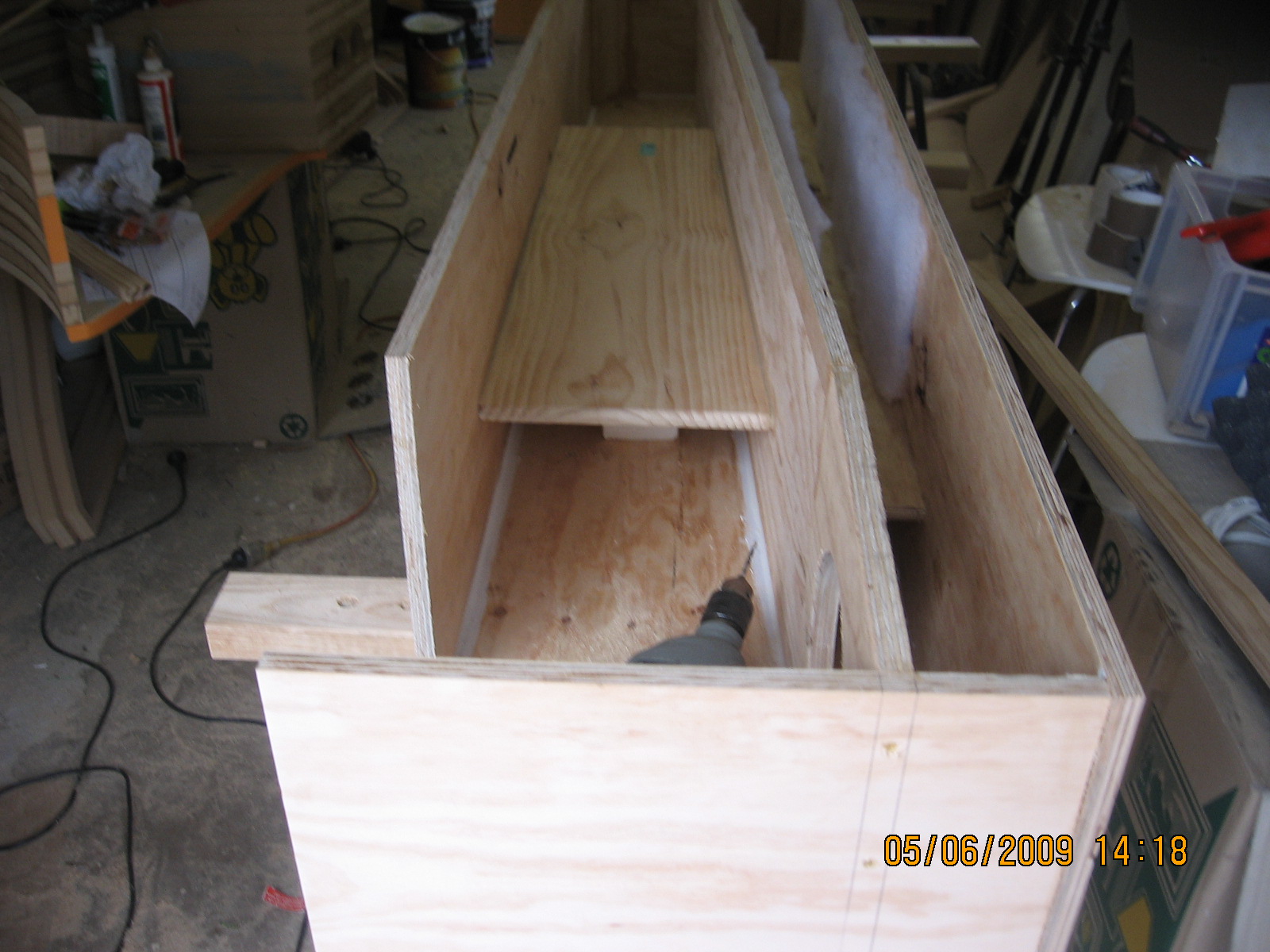

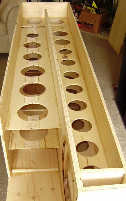

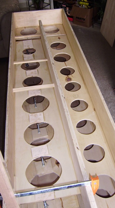

After perusing what would be an nice compliment to my [main speakers], and satisfying all criteria for movie and music listening for subwoofer duty given my apartment, I've decided to give the 20Hz TH a shot. I've built a couple cabs of Bill Fitzmaurice design (with excellent results), but this DIY project is most appropriate shown here in this forum. Test fitting and assembly is under way! More photos to come...

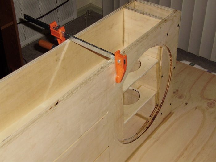

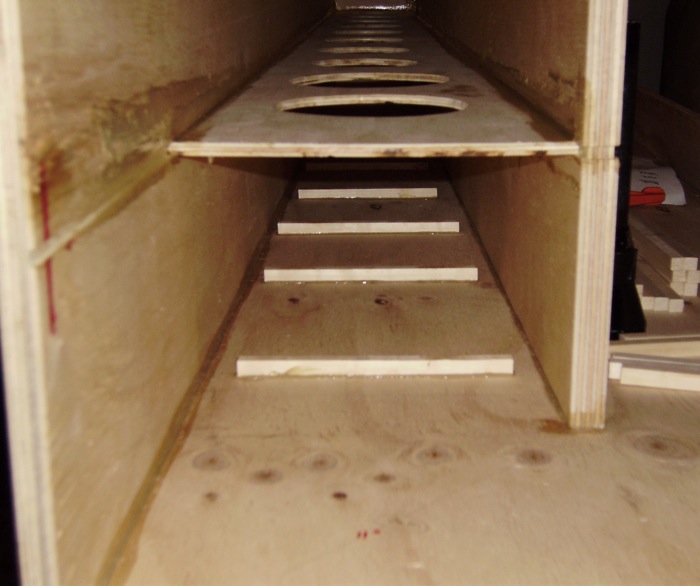

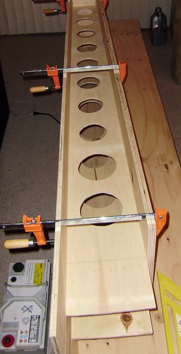

Alright, first brace glued into its dado and side panel cleats glued on. These cleats stiffen up the side panel as the span from the baffle to the outer panel increases along the length of the cab. Was this a must? No, but it sure makes for a rock solid cab when working with 1/2" ply. Will it affect performance? Not enough for me to fret over, and not over any frequencies that I'd care about.

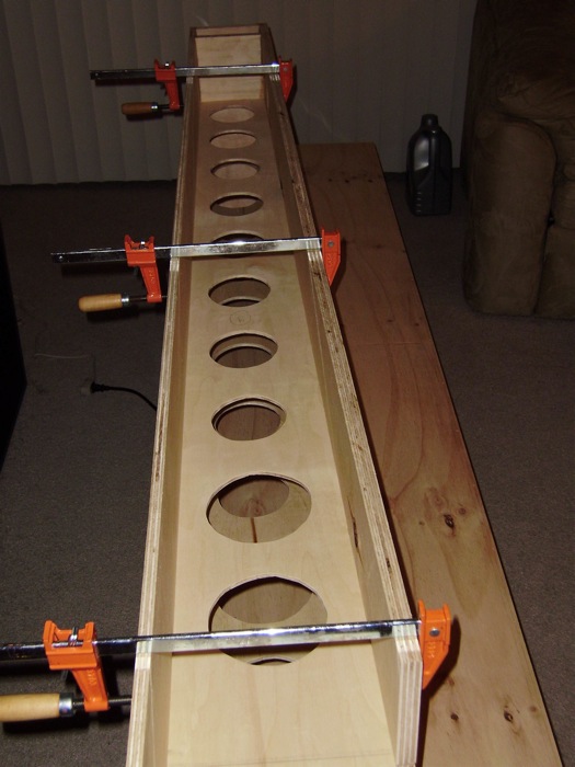

I've got pictures sorted out now, so here's bigger versions of the dry fitting pics from the first post. -Cheers :cool:

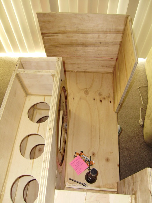

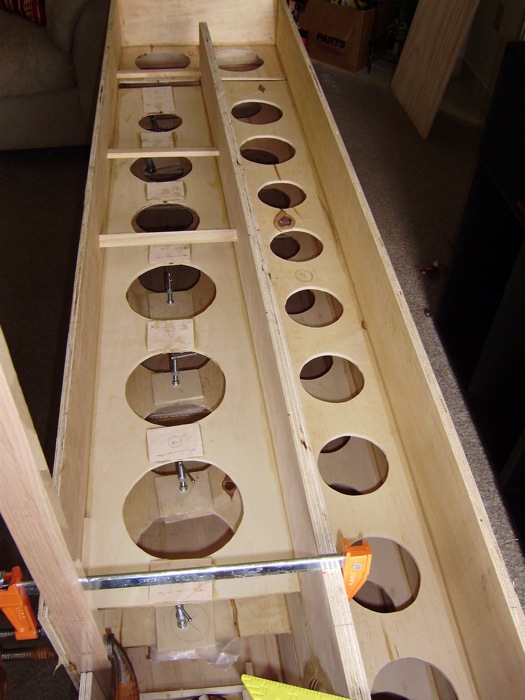

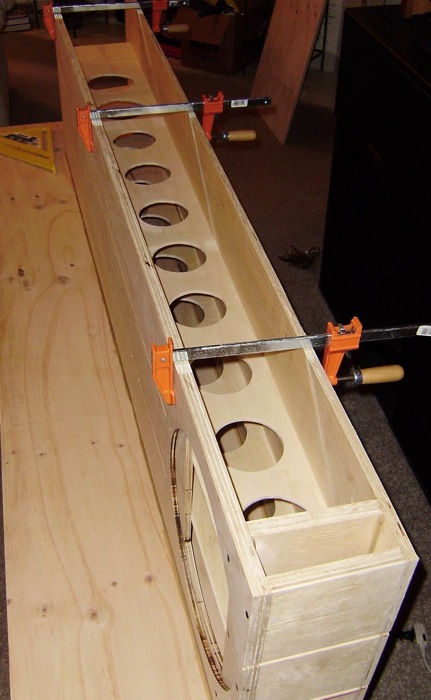

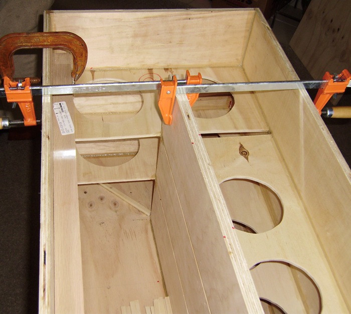

Little more progress today...can't wait to hear this monolith when it's done. It's like carefully opening a christmas present real-l-l-l-l-y slow.:D

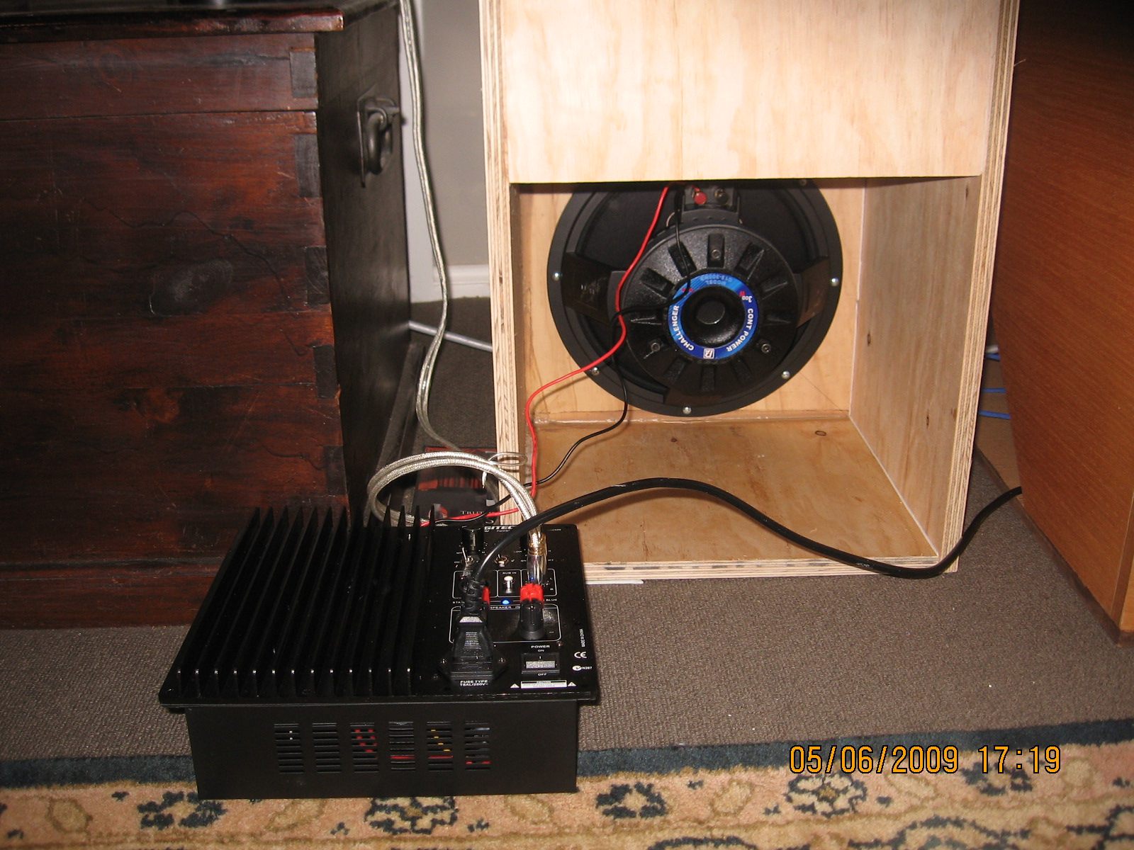

I did the similar project...with 12-inch Visaton. Certainly large volume of rich bass....running high pass filter to roll off around 120Hz....but ideally, this could be lower, eg 70-80Hz. Earlier 600-watt plate amp with 96dB driver was complete overkill.
The shape of the pine box means my wife doesn't need to invest in a coffin...
...hence the love note I stuck on the front door prior to her returning home after it was built.
Note the size compared to the Big Fun Lowthers....no small units either.
All fun though....

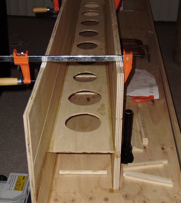

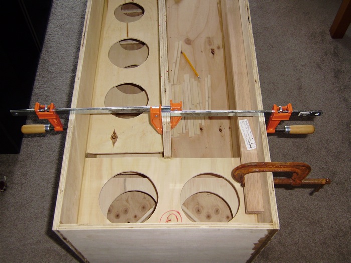

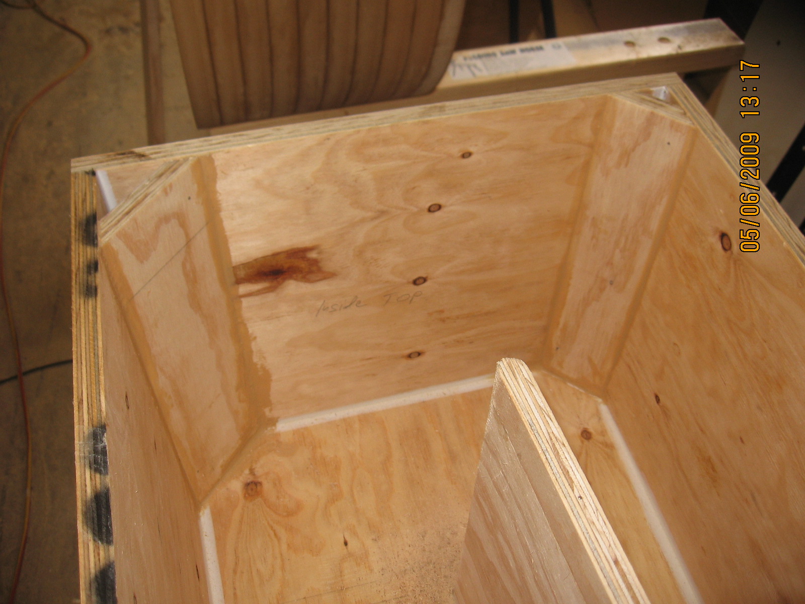

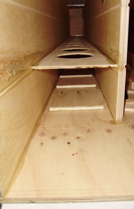

Rework is a PITA:mad: That's what I get for blowing through a dry fit too quickly. My bracing on this side wasn't in far enough. When clamped down and adhered, the whole panel sat about 1 cm too narrow. I tried to spread it out to match it up to the side panel, but doing so fractured the glue seam about 10cm from the end of the bracing before even coming close to dimension. The solution was to "unzip" the bracing to relieve the stress, reposition the panel correctly, patch each cut in the brace, then re-glue the fractured seam. Acoustically and structurally the patches function as if the brace was never cut but it made for some tedious rework. It didn't help that this panel was warped about 15 cm end to end. :rolleyes: It's all good now...waiting for cure, then I can move onto the side panel.

It is PL Premium. That's why I almost crapped myself when I heard it snap. I thought I broke the panel knowing darn well how strong this adhesive is. Fortunately, the glue hadn't cured all the way through the joint. It was just the outer skin letting go near where I was clamping (where the panel was distorted the most). I figured something was amiss after that step when the side panel wasn't lining up at all down by the hatch opening, so I started to shuffle the joints before it was rock solid. Two or even three extra hours care getting it right before glue-up would have saved me the last three days work. :wchair:

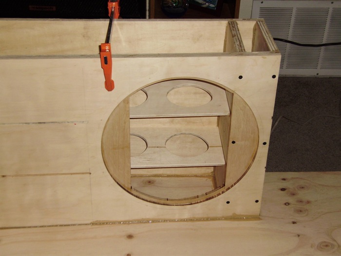

Repairs complete, back on track. Now it's onto getting the hatch framed in and securing the side panel (which is cupped beyond all belief :rolleyes:). Did I mention this thing is going to be feather weight? Even though it's measures in at a touch under 2.5 meters, it can't tip more than 15kg right now. :yes:

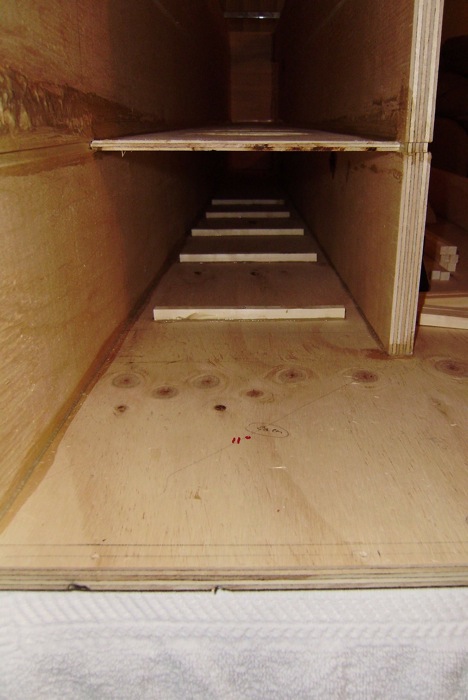

FYI- Those patches on the braces are 1/16" 3 ply baltic birch...very stiff when it's orientated and bonded correctly. It's the type used for building RC airplanes. Awesome stuff. I'd build the whole cab out of hobby wood, but what a price tag that'd be. :$:
