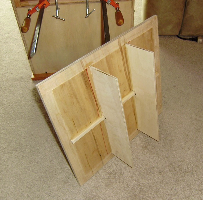

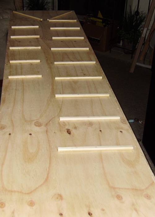

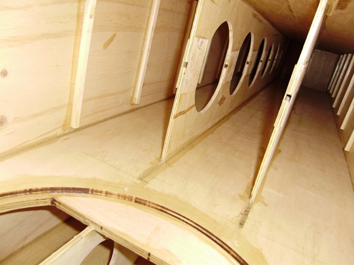

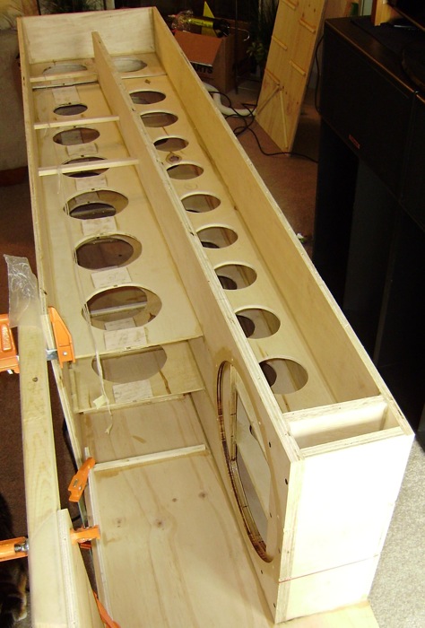

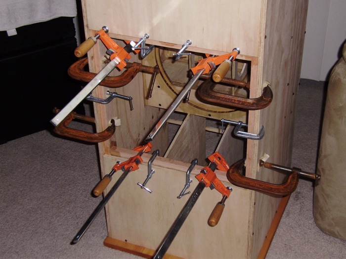

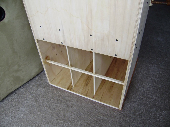

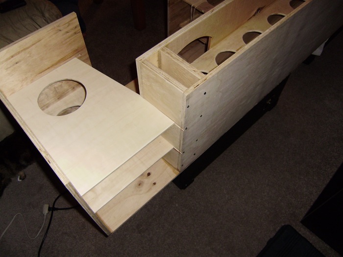

Dry fitting the mouth braces, squaring up the mouth and hatch, pre-drill all the holes, vacuum everything out, side panel glued down.

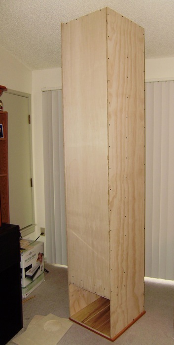

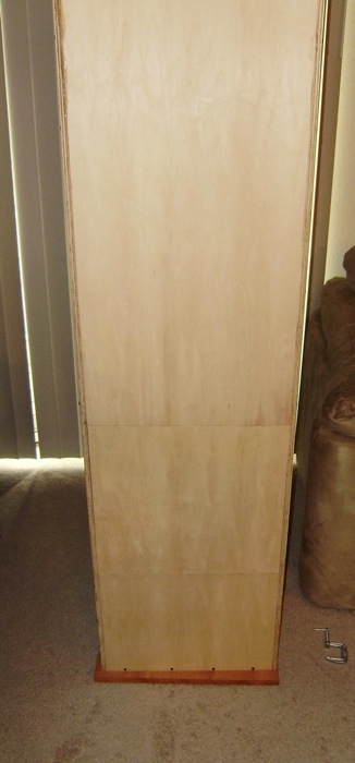

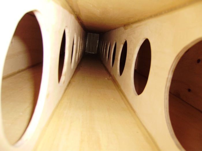

I had to stand it up to get a feel for it's size. In real-life it plays with your eyes. The long vertical lines make it look imposing, but it only takes up a half meter squared of floor space. I had the ceiling height to make it doable, so why not take advantage of it.

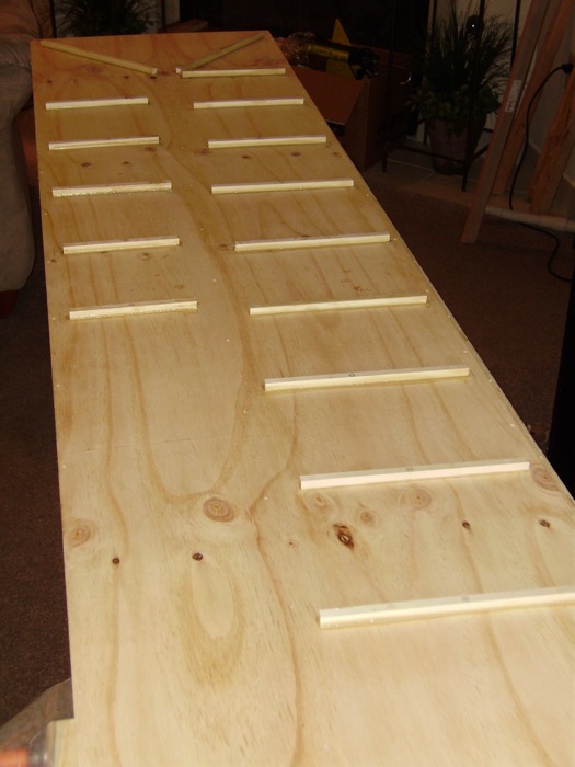

The splints with the strings get pulled after the side panel was dropped into place. As that outer panel was heavily warped, they kept it inline those final mm's until I could shoot the screws. After cure, a tug on the string knocked 'em out. Still trucking...

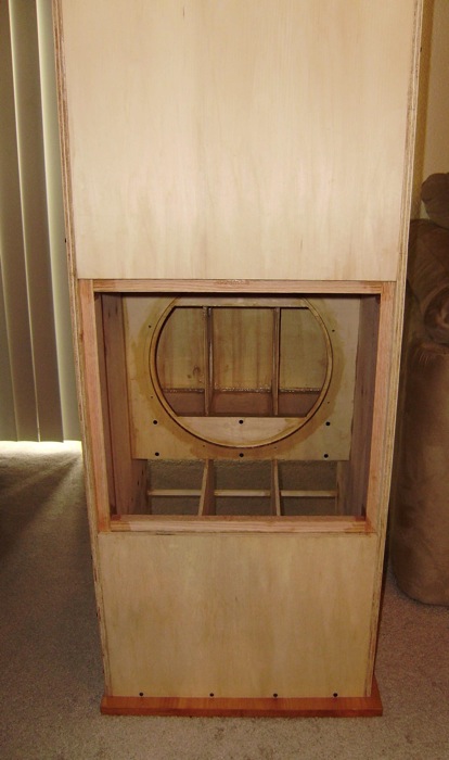

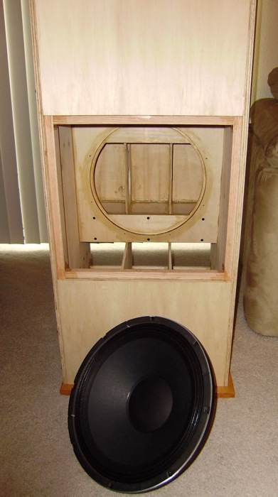

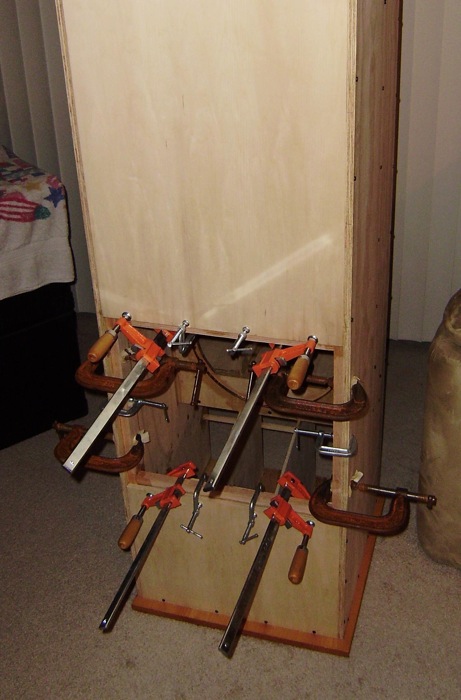

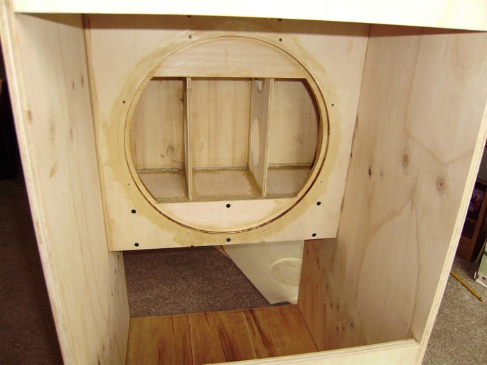

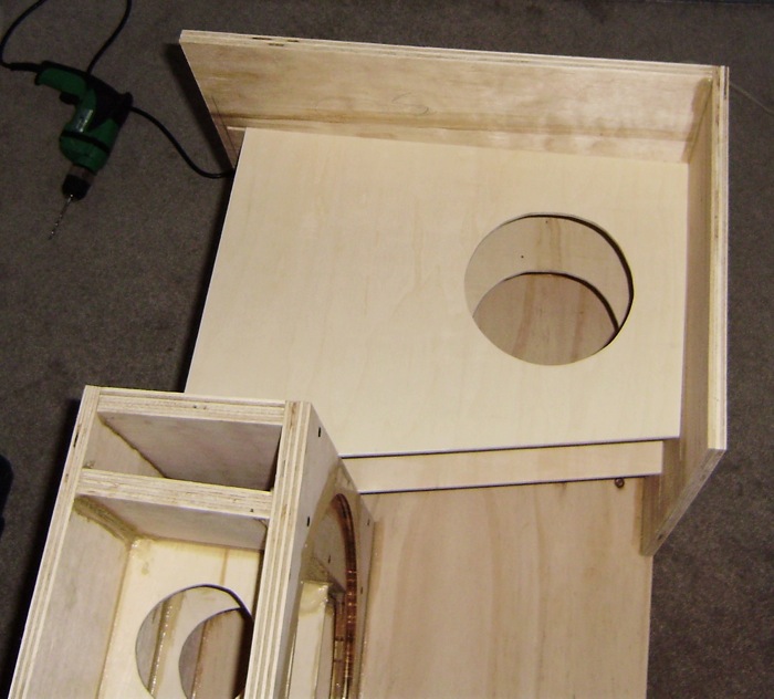

Mouth bracing done. Clamping in the access panel flanges. The picture reminded me of myself when I had braces as an adolescent.
I used oak strips for the flanges to handle repeated screw removal in the future and also for its stiffness.

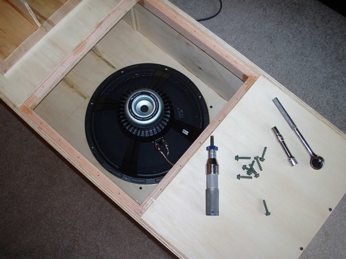

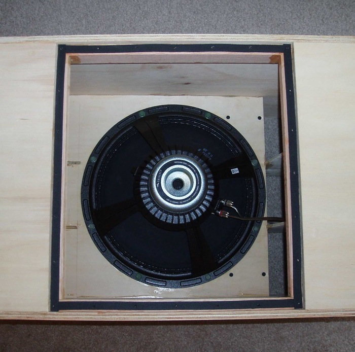

Hatch ready to go in and fitted up before drilling holes. Driver all broken in and gaps in the gasket sealed up. Modified Spax wood bolts torqued down evenly. Flange gaskets laid down. Ran 25 Hz through it and checked around the driver for leaks. None. So I cinched the hatch down, and let 'er rip while I started cleaning up.
