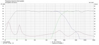

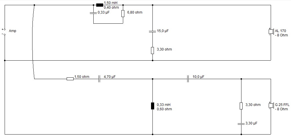

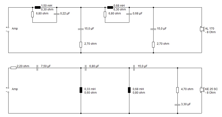

You made nice box.. I simulated AL170 in same box, but with two different tweeters and few xover modifications..
Instead Vifa you could try Visaton KE25SC or Dayton RS28, all three have almost identical dimensions, 104-105mm..
  • AL170_KE25SC_RS28.zip
Thanks for the compliment, I thought I was doing everything wrong. The ke25sc is a tweeter I am desiring for a while now. If ihave the financies, I'll order myself 2. My other drivers are all from flee markets. Example: bought 2x al170, dsm25ffl, w21s, g25ffl, and vifa's for 100 euro.

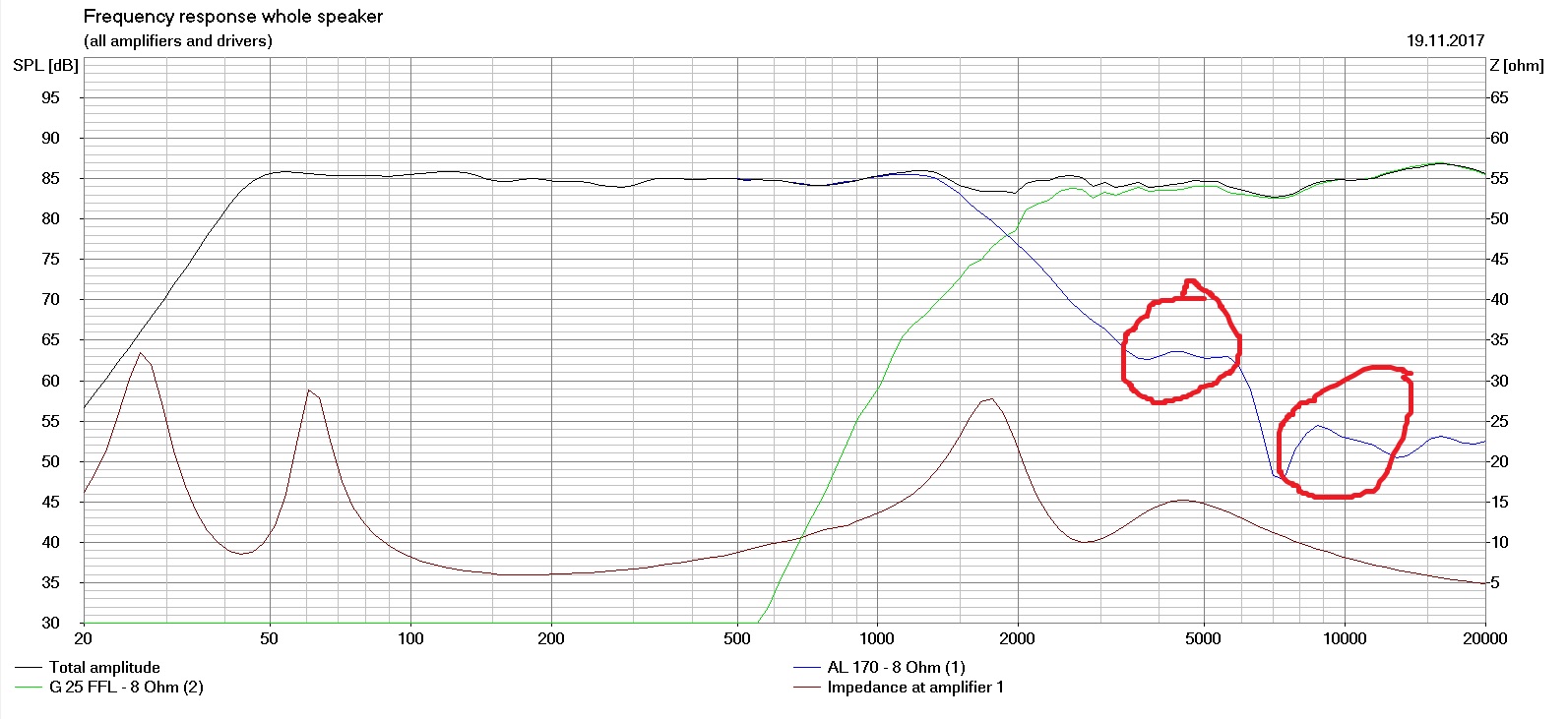

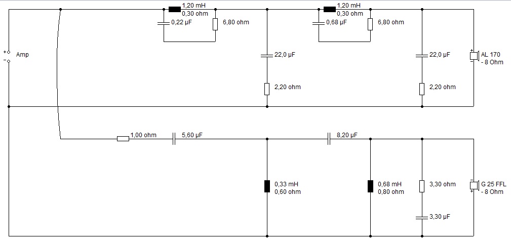

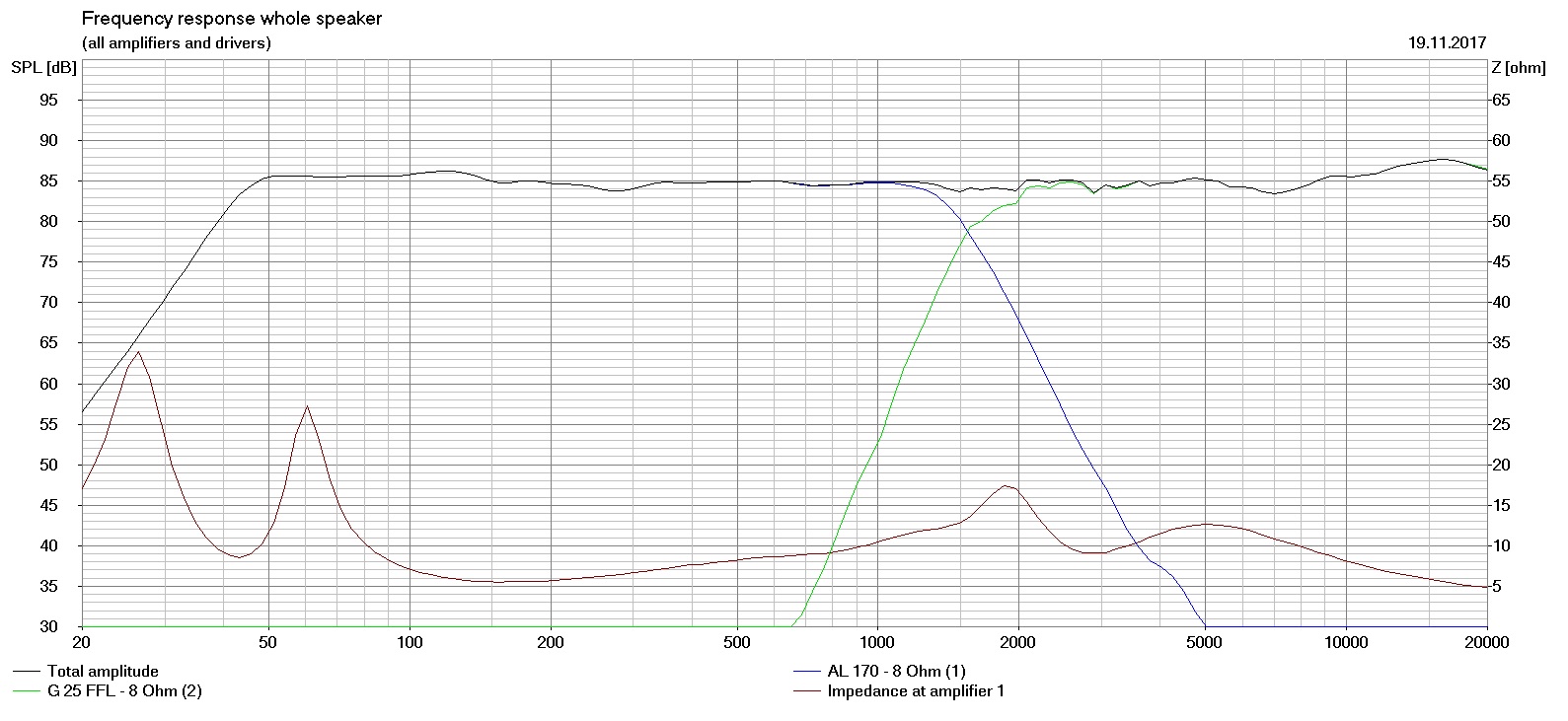

You can easy make something like this.. use some parts from your xover, and put G25FFL instead of Vifa.. but problem with AL170 ringing remains, only slightly lower..
p.s. can you please give me precise position of drivers on front panel, 90-80 from your simulation is imposible and I modified it to 90-76
  • Al170_G25FFL.zip

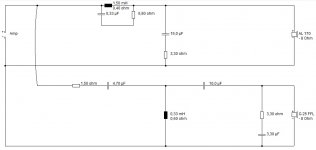

System 7
I used Lojzek's suggested crossover, combined with your 3R suggestion.
