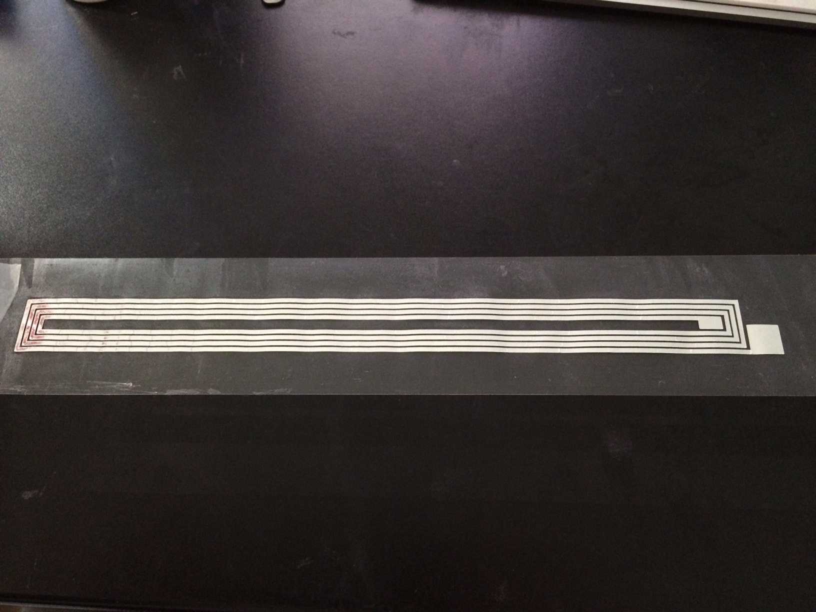

My resistance calculations were off. I just etched a conductor and measured the resistance. I got about 1.6 ohms.
Using the following parameters I get a predicted resistance of 1.4 ohms:
Aluminum resistivity: 2.6 x 10^-8 ohm meters
Conductor length: 1.373 meters
Conductor thickness: 13 x 10^-6 meters
Conductor width: 2 x 10^-3 meters
Resistance is resistivity times length divided by (thickness times width). My measured resistance is probably slightly high because of a combination of probe contact resistance and slightly undersized conductor width (assuming some under-cutting in the etching process). I think I have the foil thickness correct because I measured it two ways and they agreed (I weighed a known area on an analytical balance and also measured the thickness of many stacked layers of foil and divided by the number of layers).
I still ran into some gluing problems but it was much better so I think I'm on the right track.
So now the question is whether to continue with the silk screen and etch approach or follow the Scandinavians' lead and use a Silhouette cutter. I'll be out of town for four days so I can either ponder the options while traveling or order a cutter today so it's waiting for me when I return! Tough call...

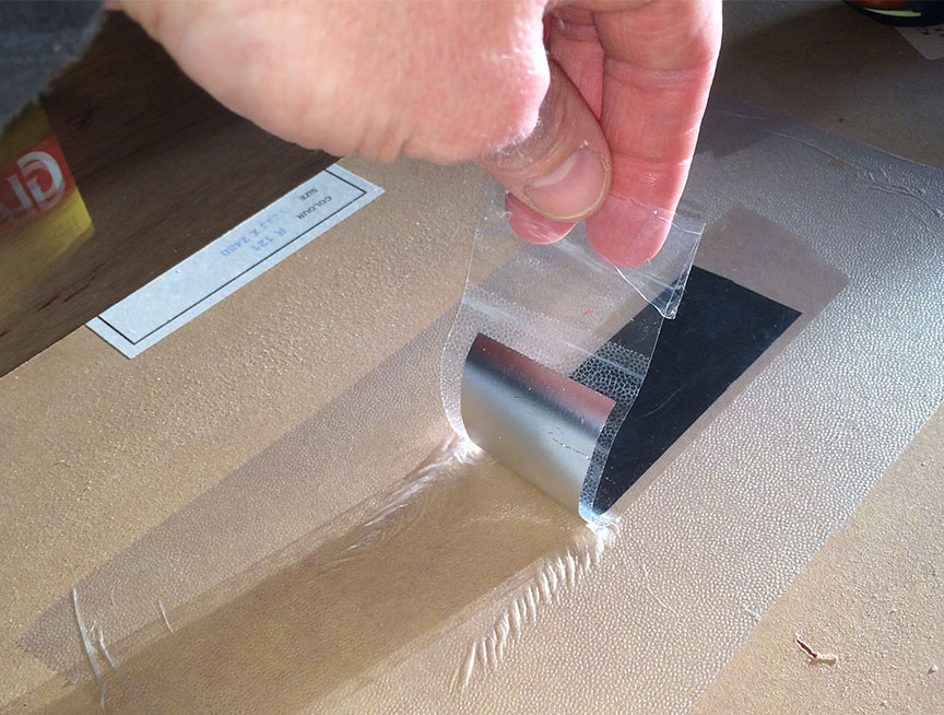

Thanks, Solhaga, for the information. Before I saw your post I came up with another possibility for holding the foil flat while cutting it with a Silhouette machine. For those of us who have a hard time finding the paper/foil laminate this might be an option but I've only done preliminary testing.
Press'n Seal, made by the Glad company (see attached photo), is available in US grocery stores. It has a lightly tacky adhesive designed to stick to itself but it seems also to stick just the right amount for holding thin foil so that it can be cut but also removed safely.
As a test I sprayed 3M 77 on a smooth surface and stuck the less sticky side of a piece of Press'n Seal onto the adhesive. I used a rubber roller to smooth the Press'n Seal and ensure that it was well stuck. I then put a piece of 13 micron thick Al foil onto the Press'n Seal, rolled it flat, and verified that it sticks very well. I don't think a cutter would dislodge the Al from the Press'n Seal. But, I was still able to remove the Al foil from the Press'n Seal without damage by laying adhesive tape on top of the foil and peeling the foil off the Press'n Seal (I'm really tired of typing that silly name; it's PnS from now on).
I was thinking I could put the PnS onto the cutter mat, put the foil onto the PnS, do the cuts, and then remove the cut out conductor by overlaying it with the diaphragm material coated with adhesive.
If I can find paper-backed foil this might all be less necessary but for now it seems like a promising approach given the materials I can find. I have photos of the process but I think it's premature to go into too much detail because the whole idea might be doomed. I've attached just one process photo showing tape being used to peel the 13 micron foil cleanly from the PnS.
