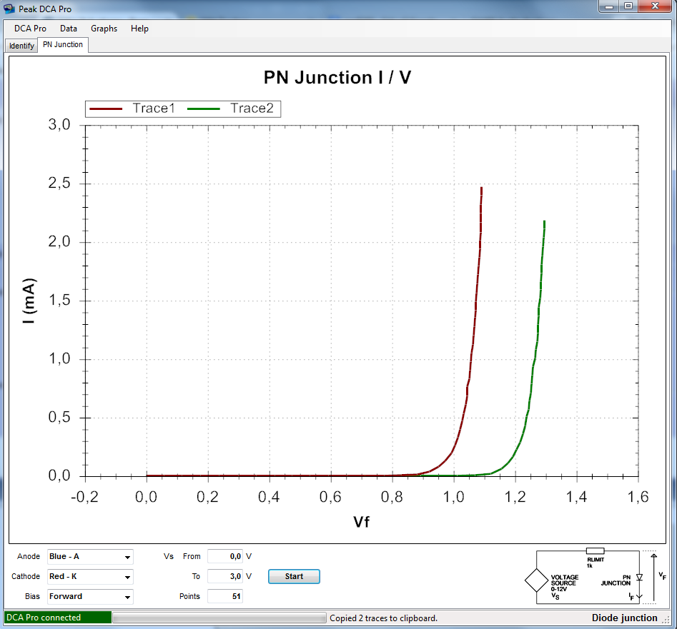

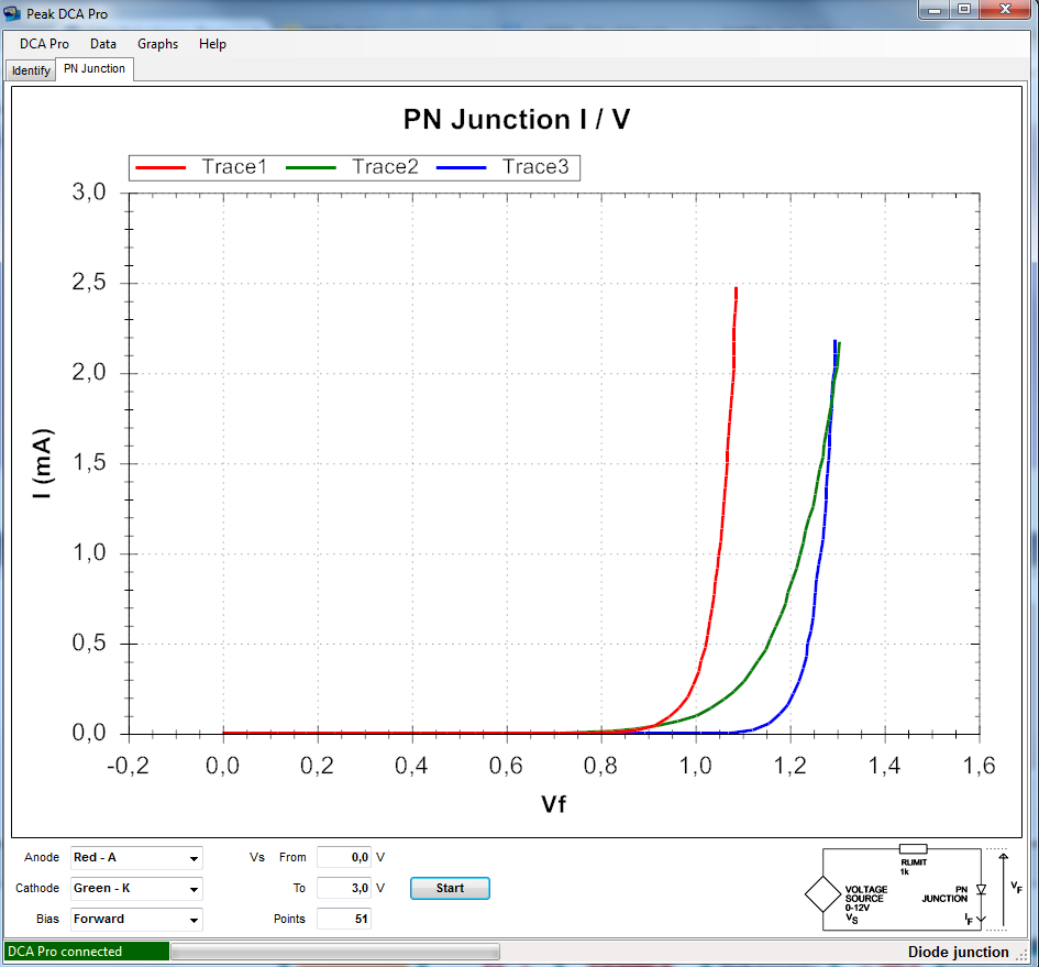

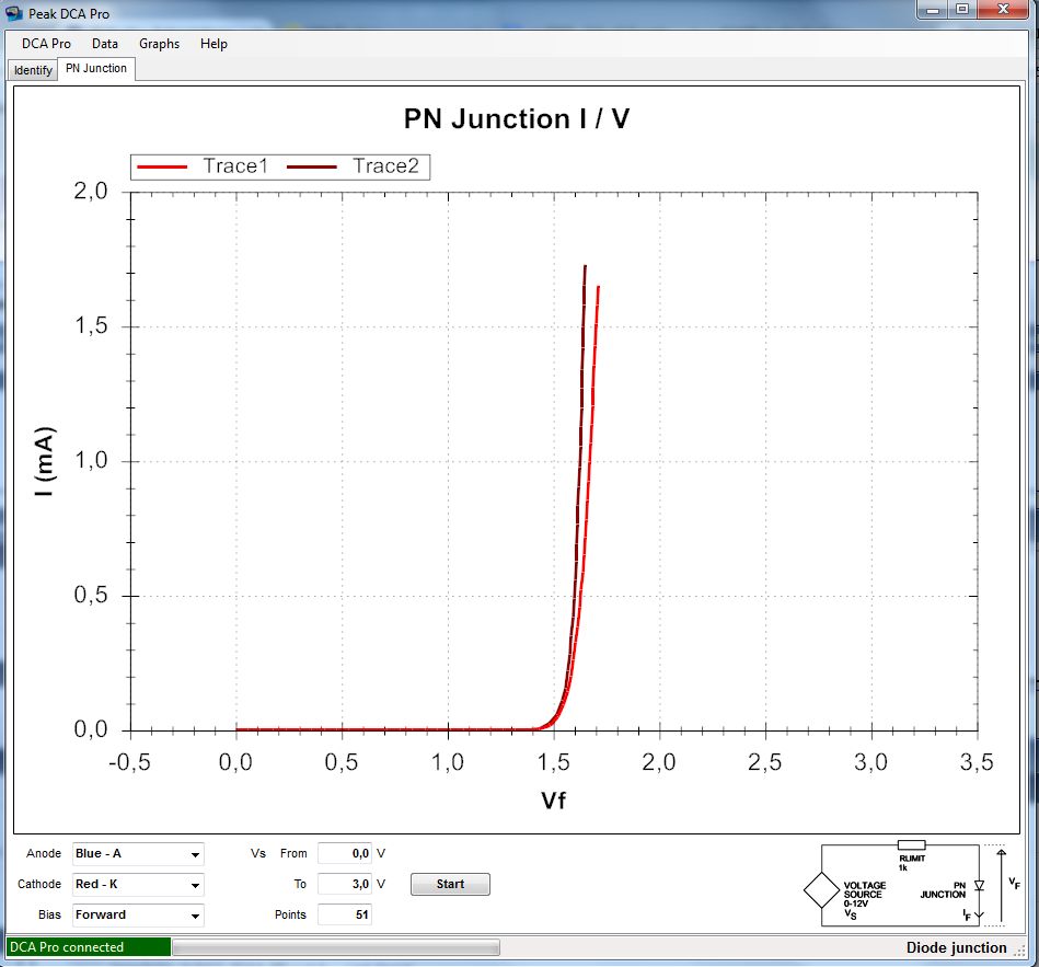

Having traced such in detail in the past I would rather say 1.5mA is the base. Depends on the tracer and the samples also. Injecting extra current to the diode etc. has to be judged as an extra current noise vs signal swing vs delta Ohm result. Obviously needed in a line stage, more of a trade off in a phono input stage.
Joined 2011
The results for the rectifying diodes was a bit of a surprice to me tho, they look far worse regarding linearity in their datasheets at low currents

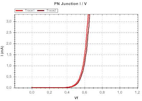

Red is 1N4007 brown is 1N4148. Resolution is 50 plot points per Volt.
