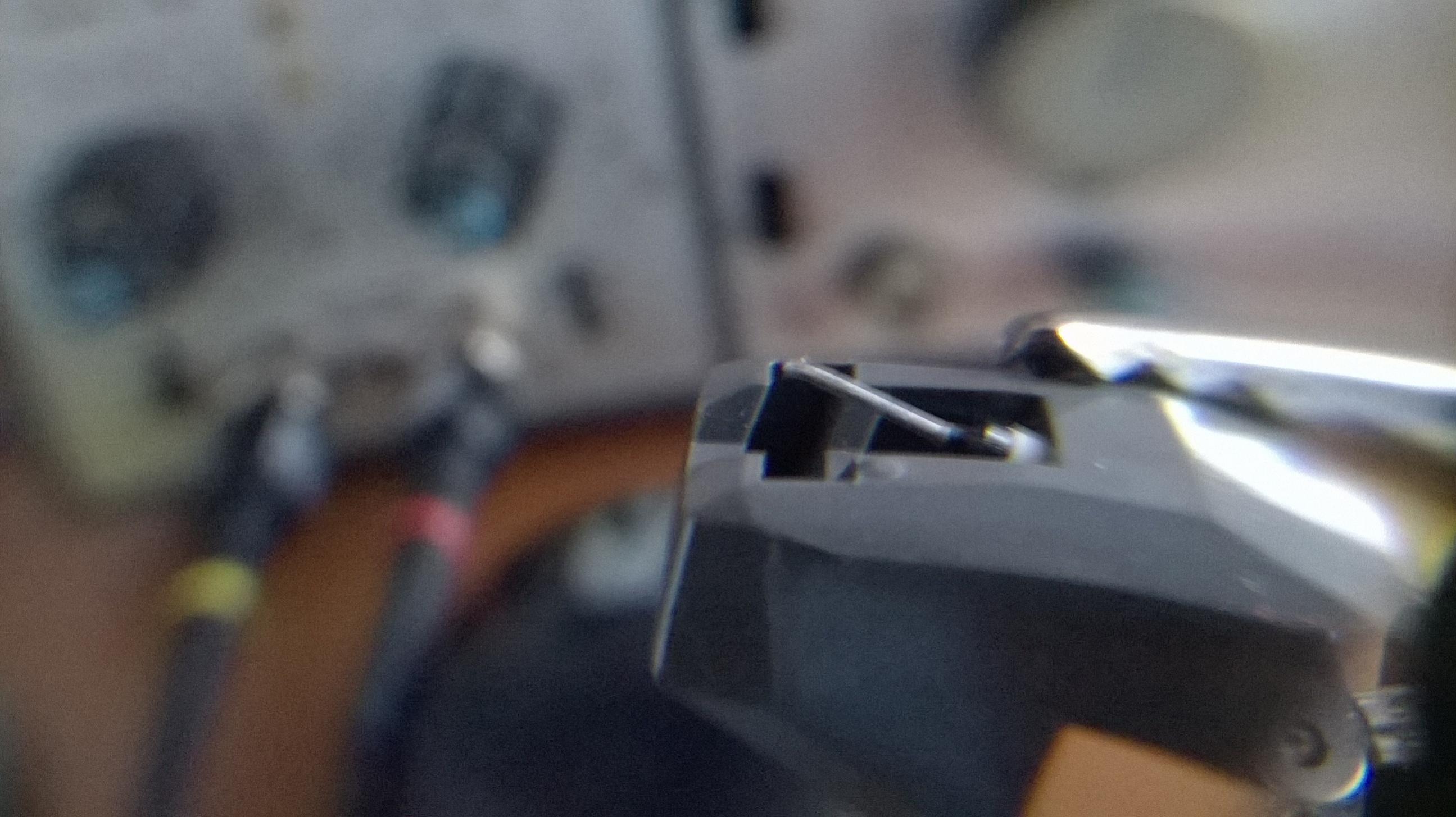

OK, so taken to read the same way in & out. Those translate to 42.7dB and 42.6dB gain for your implemented circuit that says 43dB on simulation as you posted it. Excellent agreement to theory and between channels for a tube phono you DIYed and its valves matching you achieved. Results show that the problem is NOT in your phono build.

The cartridge looks OK
