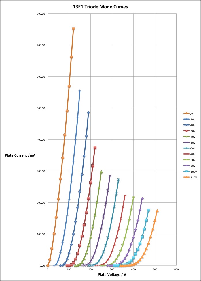

13E1 Tetrode Mode Model
Jazbo8 - here is the promised triode mode data for the 13E1, this is for a single tube but I picked one of 6 which all measured within +/-10 percent of each other.

13E1 SPICE Models
Here are the SPICE models for the 13E1 based on the sample that you provided, please note that your sample does not seem to match that of the AEI datasheet. The sample's current seems to be a bit lower than the datasheet but as long as the output pairs are well matched, you should have no problem, you could also run the screen voltage a bit higher to compensate for the difference.

13E1 in tetrode mode
Jazbo
Many thanks. I too had looked at the AEI data sheet, and the current is considerably below that. But I've found triode models elsewhere for the 13E1 and the data from mine is similar.
Currently all the tubes I have are from the same batch. I however have another batch and I will try these out soon and tell you what happens.
Many thanks again.
