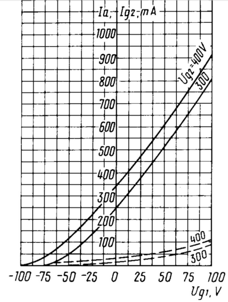

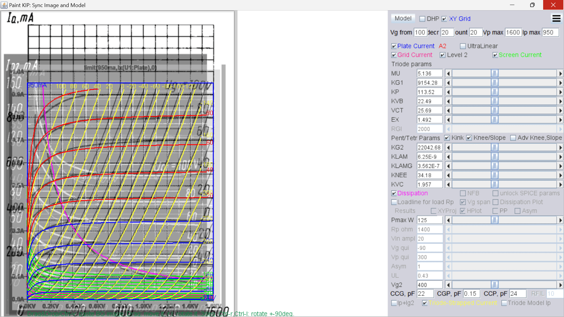

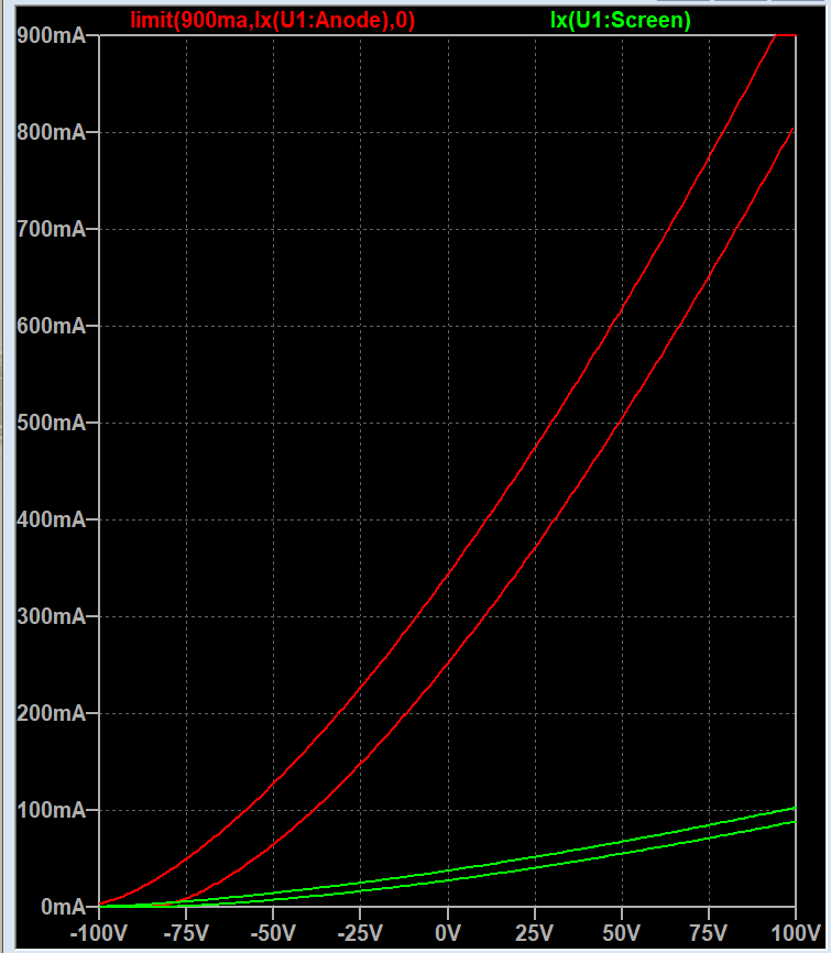

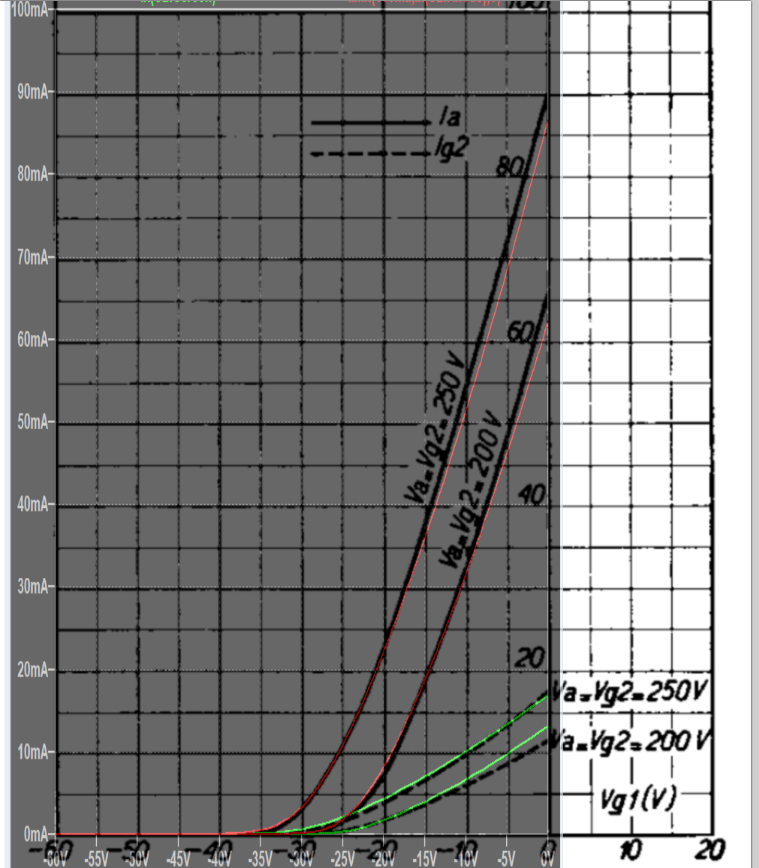

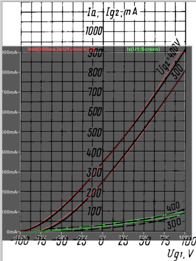

Here is GK-71 pentode model:
Code:
**** GK_71 ******************************************
* Created on 11/15/2022 00:27 using paint_kip.jar
* www.dmitrynizh.com/tubeparams_image.htm
* Plate Curves image file: gk-71.png
* Data source link: <plate curves URL>
.SUBCKT GK_71 P G2 G K ; LTSpice tetrode.asy pinout
* .SUBCKT GK_71 P G K G2 ; Koren Pentode Pspice pinout
+ PARAMS: MU=5.136 KG1=9154.28 KP=113.52 KVB=22.49 VCT=25.69 EX=1.492 KG2=22042.68 KNEE=34.18 KVC=1.957
+ KLAM=6.25E-9 KLAMG=3.562E-7 KNEE2=0.95 KNEX=30  KNK=-0.044 KNG=0.006 KNPL=0.1562 KNSL=7.48 KNPR=13.8 KNSR=29
+ CCG=22P CGP=0.15P CCP=24P VGOFF=0.33 IGA=0.004044 IGB=0.384 IGC=30.4 IGEX=1.84
* Vp_MAX=1600 Ip_MAX=950 Vg_step=20 Vg_start=100 Vg_count=20
* X_MIN=62 Y_MIN=165 X_SIZE=422 Y_SIZE=493 FSZ_X=1296 FSZ_Y=736 XYGrid=false
* Rp=1400 Vg_ac=20 P_max=125 Vg_qui=-90 Vp_qui=300
* showLoadLine=n showIp=y isDHP=n isPP=n isAsymPP=n isUL=n showDissipLimit=y
* showIg1=y isInputSnapped=y addLocalNFB=n
* XYProjections=n harmonicPlot=y dissipPlot=n
* UL=0.43 EG2=400 gridLevel2=y addKink=y isTanhKnee=y advSigmoid=n
RE1  7 0  1G    ; DUMMY SO NODE 7 HAS 2 CONNECTIONS
E1   7 0  VALUE=  ; E1 BREAKS UP LONG EQUATION FOR G1.
+{V(G2,K)/KP*LOG(1+EXP((1/MU+(VCT+V(G,K))/SQRT(KVB+V(G2,K)*V(G2,K)))*KP))}
RE2  6 0  1G    ; DUMMY SO NODE 6 HAS 2 CONNECTIONS
E2  6 0  VALUE={(PWR(V(7),EX)+PWRS(V(7),EX))} ; Kg1 times KIT current
RE21 21 0 1
E21  21 0 VALUE={V(6)/KG1*ATAN((V(P,K)+KNEX)/KNEE)*TANH(V(P,K)/KNEE2)} ; Ip with knee but no slope and no kink
RE22 22 0 1 ; E22: kink curr deviation for plate
E22  22 0 VALUE={V(21)*LIMIT(KNK-V(G,K)*KNG,0,0.3)*(-ATAN((V(P,K)-KNPL)/KNSL)+ATAN((V(P,K)-KNPR)/KNSR))}
G1   P  K  VALUE={V(21)*(1+KLAMG*V(P,K))+KLAM*V(P,K) + V(22)}
* Alexander Gurskii screen current, see audioXpress 2/2011, with slope and kink added
RE43 43 K 1G ; Dummy
E43  43 G2 VALUE={0} ; Dummy
G2   43 K  VALUE={V(6)/KG2*(KVC-ATAN((V(P,K)+KNEX)/KNEE)*TANH(V(P,K)/KNEE2))/(1+KLAMG*V(P,K))-V(22)}
RCP  P K  1G     ; FOR CONVERGENCE
C1   K G  {CCG}  ; CATHODE-GRID 1
C2   G P  {CGP}  ; GRID 1-PLATE
C3   K P  {CCP}  ; CATHODE-PLATE
RE23 G 0 1G
GG G K VALUE={(IGA+IGB/(IGC+V(P,K)))*(MU/KG1)*
+(PWR(V(G,K)-VGOFF,IGEX)+PWRS(V(G,K)-VGOFF,IGEX))}
.ENDS

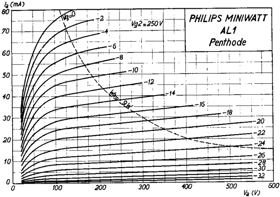

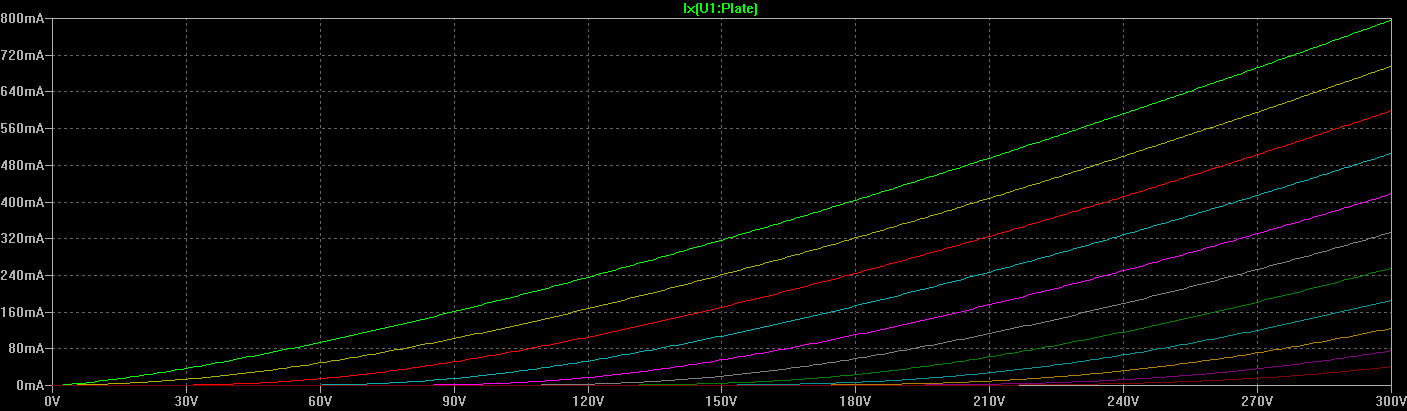

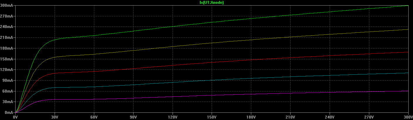

Consolidating two questions I didn't realize I messed up.
What kind of .asc circuit does one use to generate tube curves in LTspice if a known-good model is available?
EL81 has been used as PP pentodes in Philips PA amplifiers long ago.
Philips BX998A table radio used PL81's as direct-coupled series triodes in the bass amp and EL84 for the treble amp. I think this radio used high impedance voice coil speakers (700-800 ohms?)
One Philips datasheet I have to keep re-finding has a small set of as-triode data ( ra=1k, mu = 5.5, gm = 0.0055 @ 250 V, 40 mA, -38V on g1), but no triode curves. It has a 8W plate but with g3 connected to k, & g2 connected to a, they use 10 W as combined plate + screen dissipation).
I have done some LTspice simulation of preamps, but never attempted creating tube curves. Attempting to replicate pentode-as-triode curves for one that has already been done would be a good way to validate one's own plots.
But I am not sure what kind of circuit would do this.
Reading some of the 'Getting Started' web pages is helpful, but one eventually encounters advice to not use certain models.
So obviously not a task to undertake alone (in a vacuum)!
I have a library file for PL81 that Derk Reefman created, as both pentode and triode.
Any recommendations for a 'curve tracer' circuit to pursue this? I don't have an amplifier circuit to simulate. I want triode curves to draw a load line on first.
Thank you
Murray

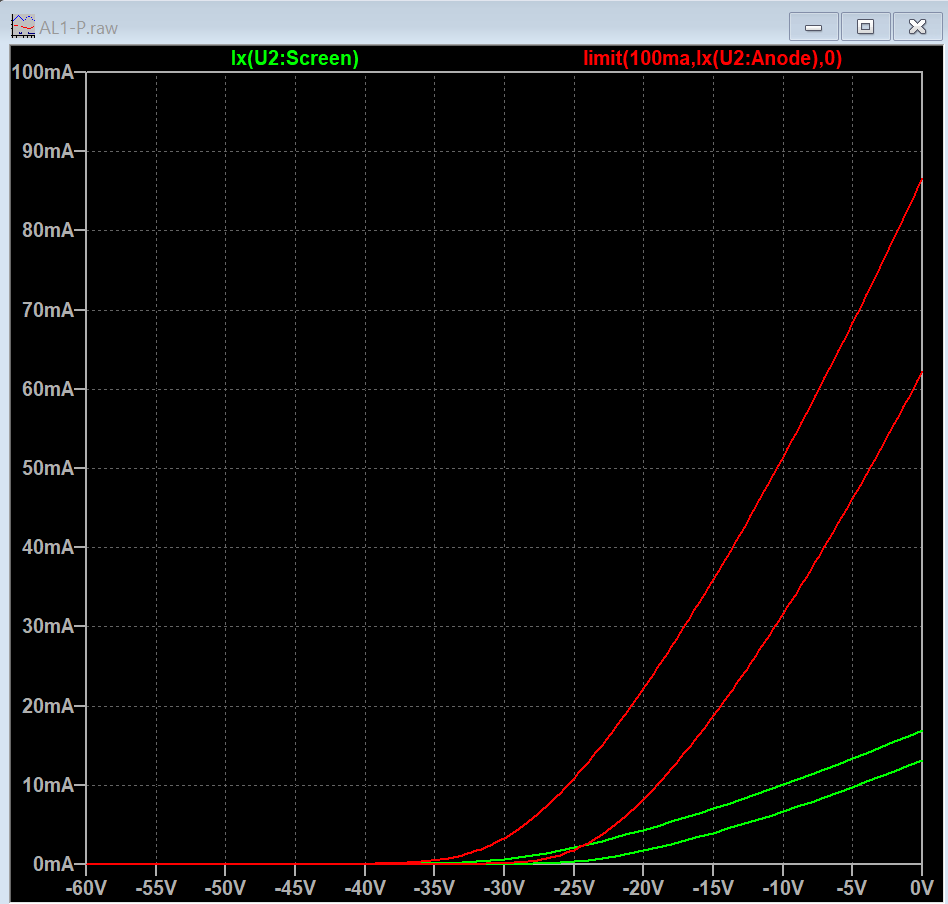

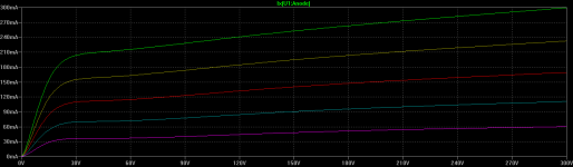

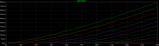

Try the attached LTspice file. It includes the Reefman PL81 pentode model, and the simulation's plot parameters are consistent with the attached Philips PL81 datasheet (bottom of page 4). After running the simulation, place the current probe on the tube's anode to plot the anode current and you should get the plot shown in the attached image.
  • PL81 Pentode Curves.asc
  • PL81_Philips.pdf

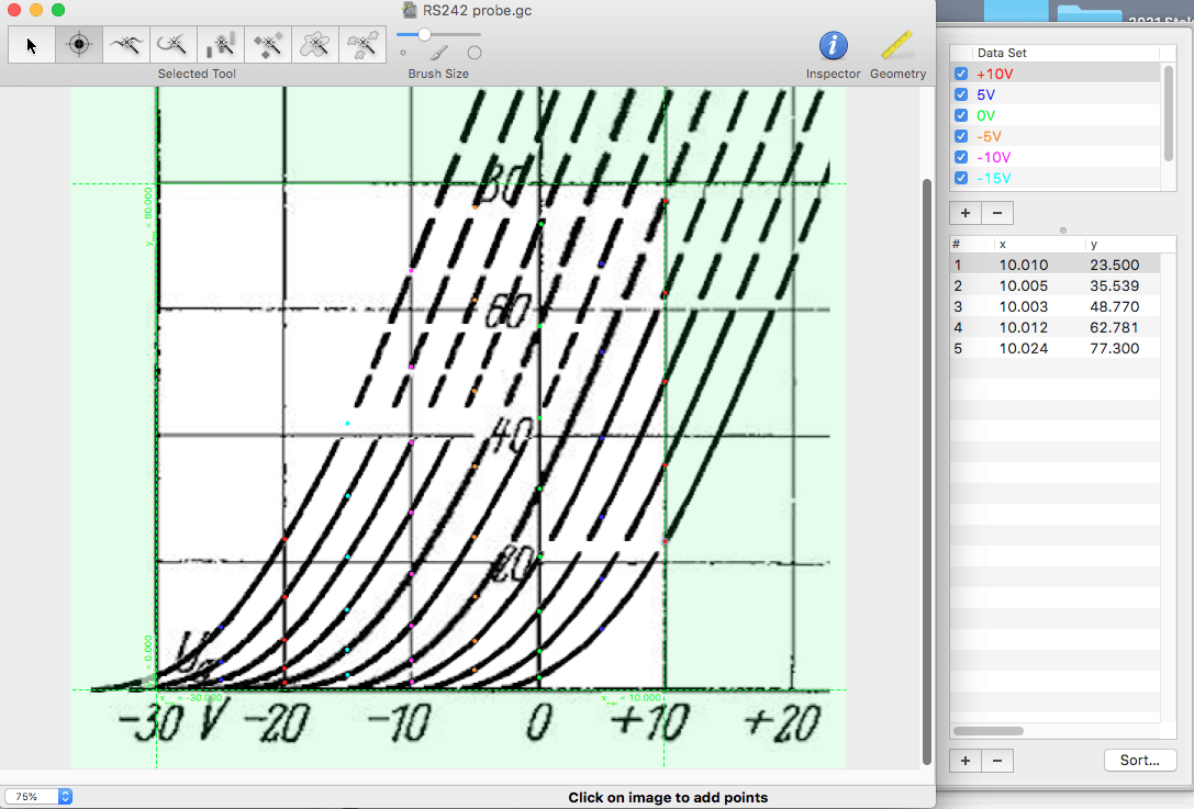

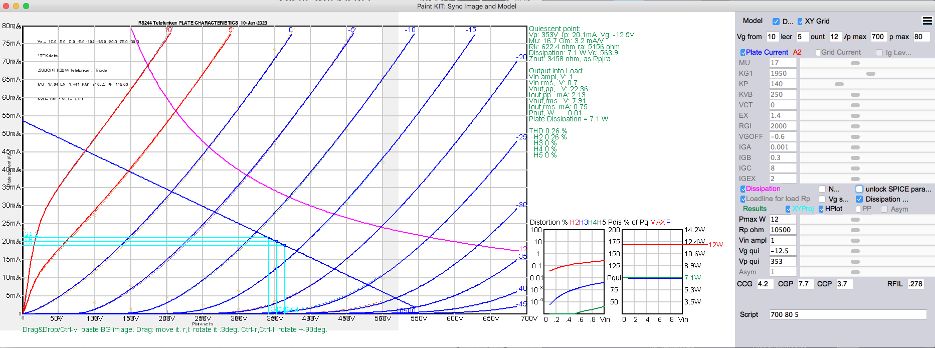

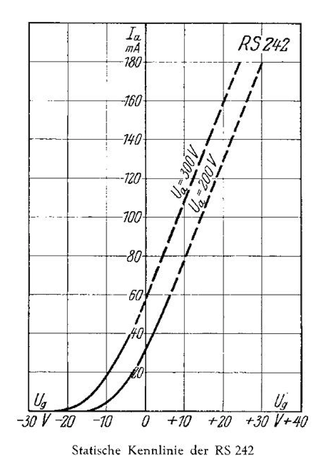

Hi i try to derive some spice model for RS242 DH triode. The model is based on tiny and insuficient informations. At least I didnt find more informations than original TFK sheet. :(
a) First I multipied the 2 curves from graph
b) get the data points from Graph Click.
c) Set the Matlab file RS242.m to input in the Norman K. Tuparam Matlab, to fet the Anode chrs in more desirable form.
d) With these anode chrs I checked with Model Paint tools soft for the composite DHT model.
Code:
****  Composite RS242 DHT *****************************************
* Created on 01/10/2023 22:42 using paint_kit.jar 3.1
* Data source link: Telefunken RS242 datas
* Vhaeat = 3.8 [V]
* Iheat    =  0.72 [A]
* Pa-max = 12[W]
* Ia-max = 70[mA]
* Ua-max = 400[V]
.SUBCKT RS242_DHT 1 2 3 4 ; P G K1 K2
+ PARAMS:
+ CCG=4.2P
+ CGP=7.7P
+ CCP=3.7P
+ RFIL=5.278
+ MU=17
+ KG1=1950
+ KP=140
+ KVB=250
+ VCT=0
+ EX=1.4
+ RGI=2000
RFIL_LEFT    3  31 {RFIL/4}
RFIL_RIGHT   4  41 {RFIL/4}
RFIL_MIDDLE1 31 34 {RFIL/4}
RFIL_MIDDLE2 34 41 {RFIL/4}
E11 32 0  VALUE={V(1,31)/KP*LOG(1+EXP(KP*(1/MU+V(2,31)/SQRT(KVB+V(1,31)*V(1,31)))))}
E12 42 0  VALUE={V(1,41)/KP*LOG(1+EXP(KP*(1/MU+V(2,41)/SQRT(KVB+V(1,41)*V(1,41)))))}
RE11 32 0 1G
RE12 42 0 1G
G11 1 31 VALUE={(PWR(V(32),EX)+PWRS(V(32),EX))/(2*KG1)}
G12 1 41 VALUE={(PWR(V(42),EX)+PWRS(V(42),EX))/(2*KG1)}
RCP1 1 34 1G
C1 2 34 {CCG} ; CATHODE-GRID
C2 2 1 {CGP} ; GRID=PLATE
C3 1 34 {CCP} ; CATHODE-PLATE
D3 5 3 DX ; FOR GRID CURRENT
D4 6 4 DX ; FOR GRID CURRENT
RG1 2 5 {2*RGI} ; FOR GRID CURRENT
RG2 2 6 {2*RGI} ; FOR GRID CURRENT
.MODEL DX D(IS=1N RS=1 CJO=10PF TT=1N)
.ENDS
Ray-
Maybe I am being too literal, but after plotting the pentode sim voltages, and then not matching, I noted you said current probe, and my observation with the 'cursor' probe is that its default is voltage, and the resultant X-Y plots are (uninteresting) V-V lines :mad:)
Do I need to figure out how to change the setup for probe/plot to current, or add directives for I(x)?
If directives would each (x) be the sources VP, VCG, VSG, or I(N003) etc.?
Meanwhile, I'll try things & see what happens.
Thank you
Ah, just found right click, Add Traces, and the currents of interest are there.
One hand in my pocket...
I probably could have described this better. After running the simulation, you can move the cursor and left-click on various nodes to plot their attributes. If you hover the cursor over the wire leading from the plate, the cursor turns into a probe symbol and left-clicking on the wire with the probe symbol displayed will plot the voltage on the wire (node). But if you move the cursor over the plate in the tube symbol the cursor shape turns into a clamp-on ammeter symbol. Left-clicking while the ammeter cursor is displayed will plot the current into that node. That is how I displayed the plot attached to my post. You really don't need to use "add trace" in this situation although you certainly can if you want to. There is usually more than one way to accomplish something. :)
I hope this helps.
Yes, helpful.
Thank you
That was not supposed to be a mad face I posted...it was auto-corrected to an emoji or similar. Or shape-shifted.

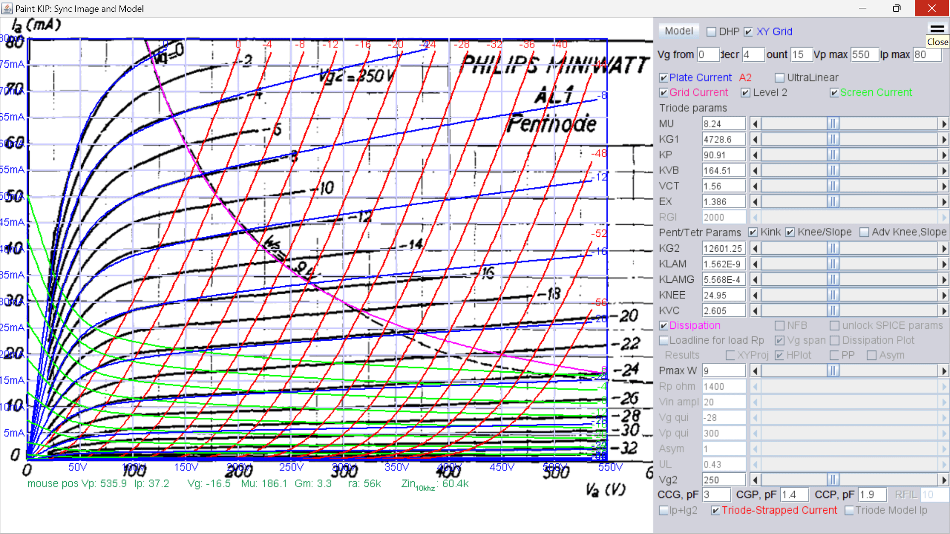

Now I'll move on to figuring out how Dimitrynizh paints his masterpiece curves. From stick-figures to landscapes will take some practice.
I thought the triode curves looked pretty nice, then realized they've melted by the time they reach the really linear parts!
I rescaled & printed a smaller range to achieve my paper goals. Still very pleasing, and good for something as a triode...TBD what.

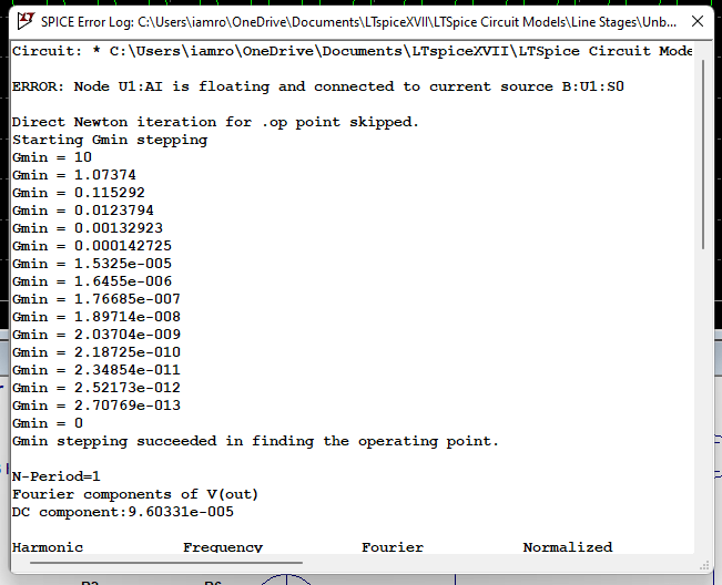

Hi Adrian,
I've been using your models quite happily. Thank you again for all the work you've put in on these, and for your generous contributions to the tube DIYer community.
I've run into a small problem using the 6N6P model as quoted above.
"ERROR: Node U1:A1 is floating and connected to current source B:U1:s0"
The sim runs successfully, at least as far as I can tell. I've attached the .asc. I wonder if there's something I'm missing in the spice directives that should be added. Thanks again.
  • 6N6P SRPP NFB Preamp_00.asc

Can you find inter-electrode capacitance of AL1? Here is the pentode model:
Code:
**** AL1_P ******************************************
* Created on 01/27/2023 08:45 using paint_kip.jar
* Plate Curves image file: AL1-P.png
.SUBCKT  AL1_P P G2 G K ; LTSpice tetrode.asy pinout
* .SUBCKT AL1_P P G K G2 ; Koren Pentode Pspice pinout
+ PARAMS: MU=8.24 KG1=4728.6 KP=90.91 KVB=164.51 VCT=1.56 EX=1.386 KG2=14484.19 KNEE=24.95 KVC=2.631
+ KLAM=1.562E-9 KLAMG=5.568E-4 KNEE2=31.53 KNEX=26.51  KNK=0.001563 KNG=7.097E-6 KNPL=47.5 KNSL=29.57 KNPR=47.5 KNSR=34.42
+ CCG=3P CGP=1.4P CCP=1.9P VGOFF=-0.6 IGA=0.001 IGB=0.3 IGC=8 IGEX=2
* Vp_MAX=550 Ip_MAX=80 Vg_step=4 Vg_start=0 Vg_count=15
* X_MIN=37 Y_MIN=29 X_SIZE=781 Y_SIZE=568 FSZ_X=1296 FSZ_Y=736 XYGrid=true
* Rp=1400 Vg_ac=20 P_max=9 Vg_qui=-28 Vp_qui=300
* UL=0.43 EG2=250 gridLevel2=y addKink=y isTanhKnee=y advSigmoid=n
RE21 21 0 1
RE23 G 0 1G
.ENDS
