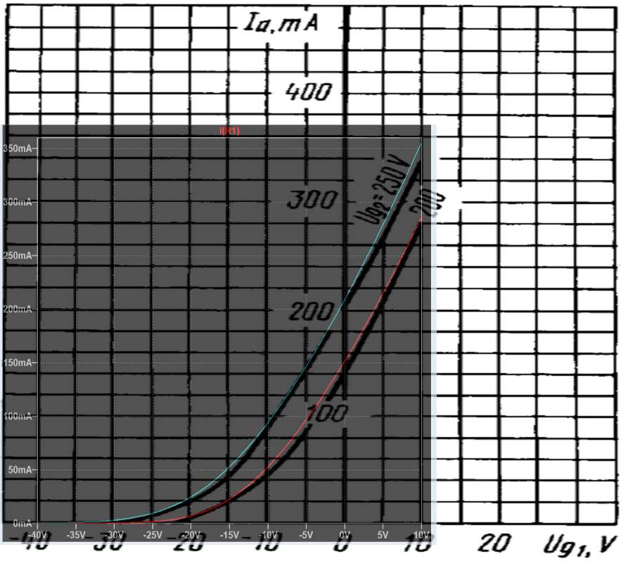

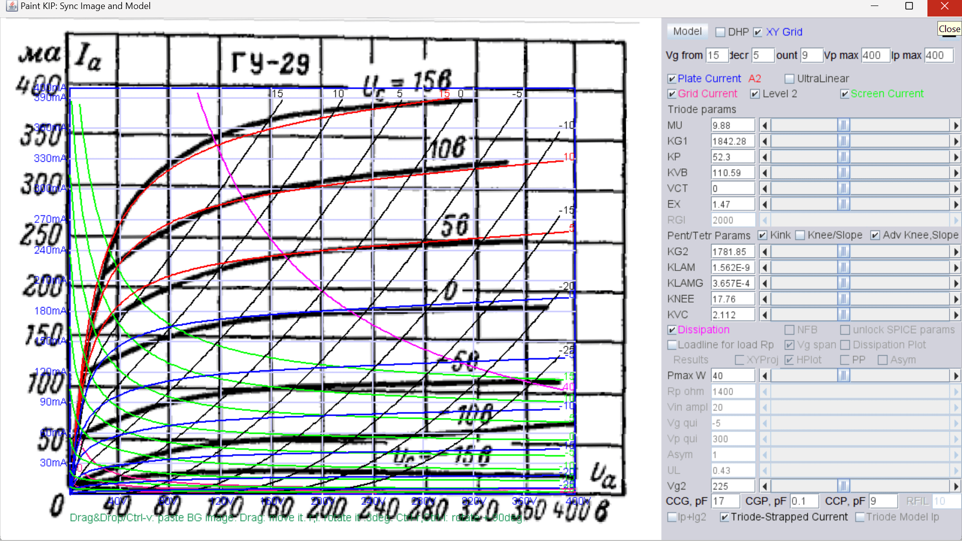

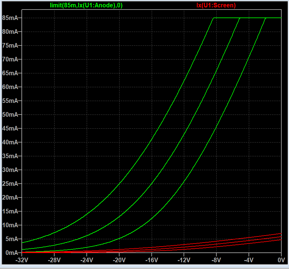

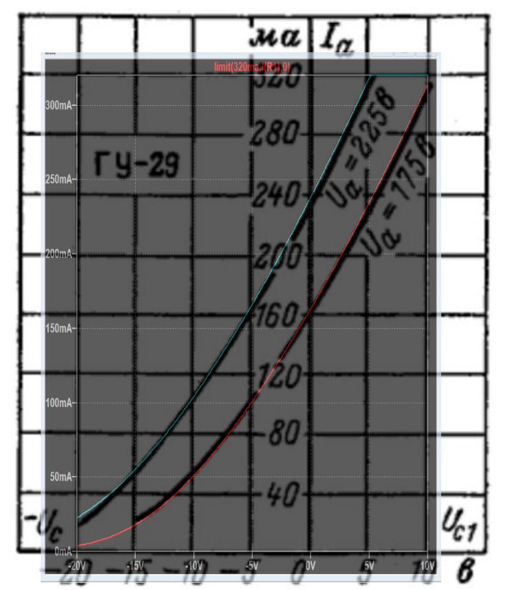

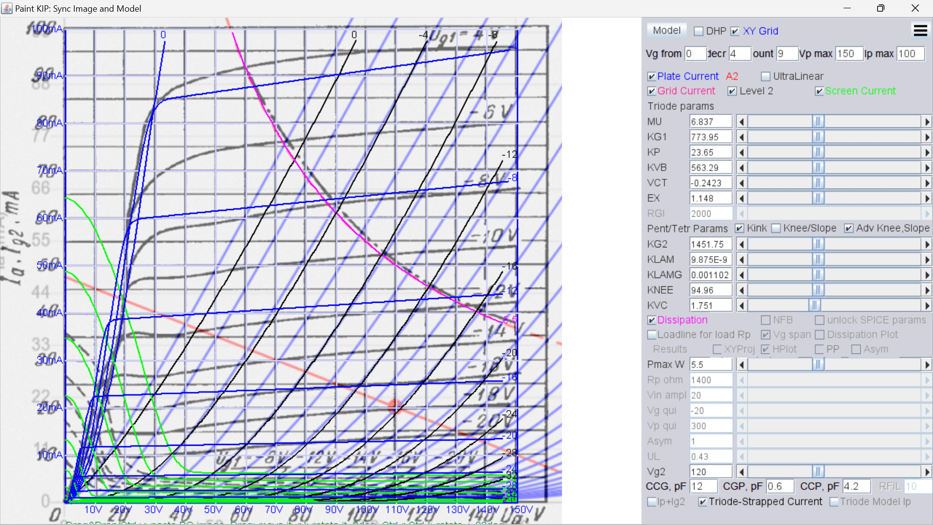

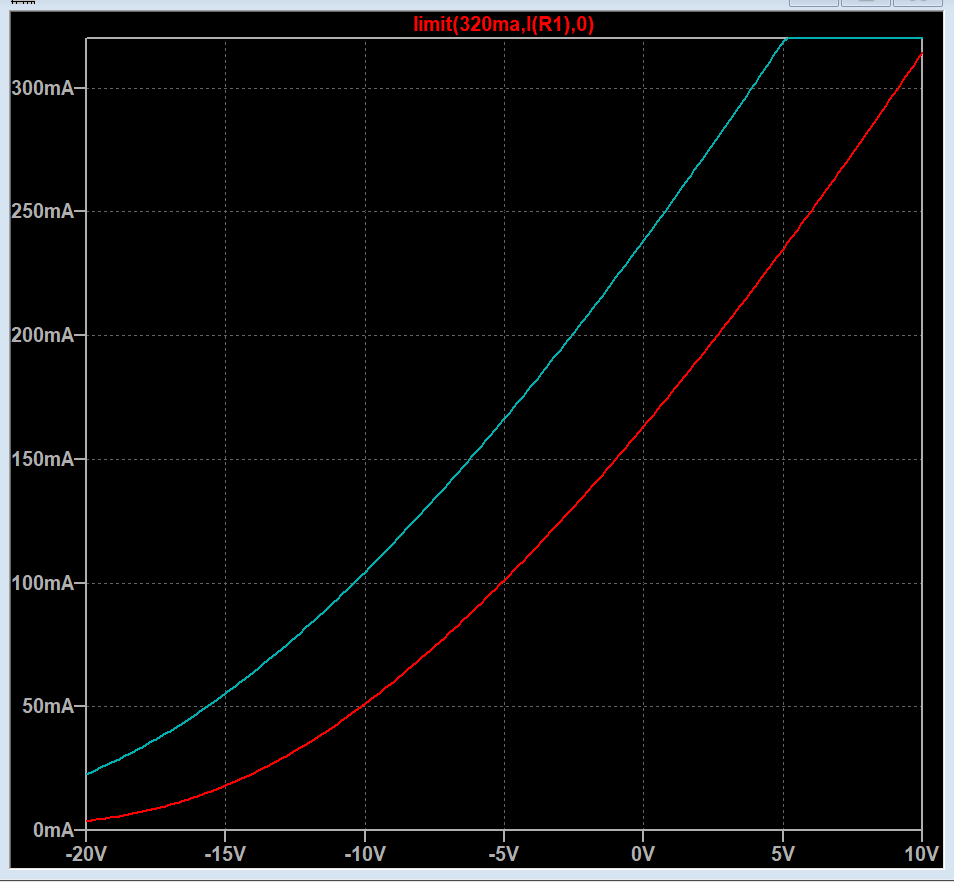

Here is GU-29 (ГУ-29) model:
Code:
**** GU_29 ******************************************
* Created on 10/24/2022 16:08 using paint_kip.jar
* www.dmitrynizh.com/tubeparams_image.htm
* Plate Curves image file: GU-29.png
* Data source link: <plate curves URL>
.SUBCKT GU_29 P G2 G K ; LTSpice tetrode.asy pinout
* .SUBCKT GU_29 P G K G2 ; Koren Pentode Pspice pinout
+ PARAMS: MU=9.88 KG1=1842.28 KP=52.3 KVB=110.59 VCT=0 EX=1.47 KG2=1781.85 KNEE=17.76 KVC=2.112
+ KLAM=1.562E-9 KLAMG=3.657E-4  KD=0.01004 KC=0.1544 KR1=172.5 KR2=11.6 KVBG=0.2775 KB1=0.3886 KB2=1.9 KB3=1.88 KB4=5.664 KVBGI=25.91 KNK=1.221E-5 KNG=0.00929 KNPL=8.898E-4 KNSL=0.02145 KNPR=51.53 KNSR=48.44
+ CCG=17P CGP=0.1P CCP=9P VGOFF=-0.6 IGA=0.001 IGB=0.3 IGC=8 IGEX=2
* Vp_MAX=400 Ip_MAX=400 Vg_step=5 Vg_start=15 Vg_count=9
* X_MIN=93 Y_MIN=94 X_SIZE=672 Y_SIZE=540 FSZ_X=1296 FSZ_Y=736 XYGrid=true
* Rp=1400 Vg_ac=20 P_max=40 Vg_qui=-5 Vp_qui=300
* showLoadLine=n showIp=y isDHP=n isPP=n isAsymPP=n isUL=n showDissipLimit=y
* showIg1=y isInputSnapped=y addLocalNFB=n
* XYProjections=n harmonicPlot=y dissipPlot=n
* UL=0.43 EG2=225 gridLevel2=y addKink=y isTanhKnee=n advSigmoid=y
RE1  7 0  1G    ; DUMMY SO NODE 7 HAS 2 CONNECTIONS
E1   7 0  VALUE=  ; E1 BREAKS UP LONG EQUATION FOR G1.
+{V(G2,K)/KP*LOG(1+EXP((1/MU+(VCT+V(G,K))/SQRT(KVB+V(G2,K)*V(G2,K)))*KP))}
RE2  6 0  1G    ; DUMMY SO NODE 6 HAS 2 CONNECTIONS
E2  6 0  VALUE={(PWR(V(7),EX)+PWRS(V(7),EX))} ; Kg1 times KIT current
E4   8 0  VALUE={V(P,K)/KNEE/(KVBGI+V(6)*KVBG)}
E5  81 0  VALUE={PWR(V(8),KB1)}
E6  82 0  VALUE={PWR(V(8),KB2)}
E7  83 0  VALUE={PWR(V(8),KB3)}
E8   9 0  VALUE={PWR(1-EXP(-V(81)*(KC+KR1*V(82))/(KD+KR2*V(83))),KB4)*1.5708}
RE4  8 0  1
RE5 81 0  1
RE6 82 0  1
RE7 83 0  1
RE8  9 0  1
RE21 21 0 1
E21  21 0 VALUE={V(6)/KG1*V(9)} ; Ip with knee but no slope and no kink
RE22 22 0 1 ; E22: kink curr deviation for plate
E22  22 0 VALUE={V(21)*LIMIT(KNK-V(G,K)*KNG,0,0.3)*(-ATAN((V(P,K)-KNPL)/KNSL)+ATAN((V(P,K)-KNPR)/KNSR))}
G1   P K  VALUE={V(21)*(1+KLAMG*V(P,K))+KLAM*V(P,K) + V(22)}
G2   G2 K  VALUE={V(6)/KG2*(KVC-V(9))/(1+KLAMG*V(P,K)) - V(22)}
RCP  P K  1G     ; FOR CONVERGENCE
C1   K G  {CCG}  ; CATHODE-GRID 1
C2   G P  {CGP}  ; GRID 1-PLATE
C3   K P  {CCP}  ; CATHODE-PLATE
RE23 G 0 1G
GG G K VALUE={(IGA+IGB/(IGC+V(P,K)))*(MU/KG1)*
+(PWR(V(G,K)-VGOFF,IGEX)+PWRS(V(G,K)-VGOFF,IGEX))}
.ENDS

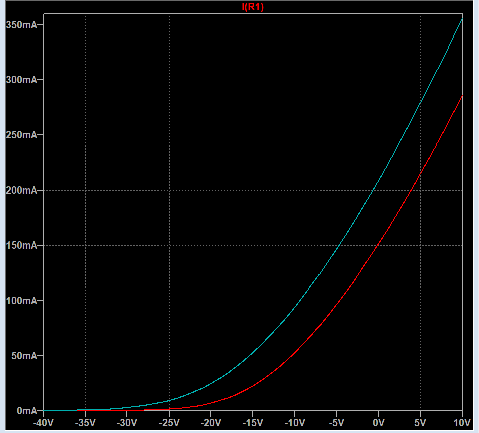

  • ГУ_29 Eng.pdf
  • ГУ_29.pdf

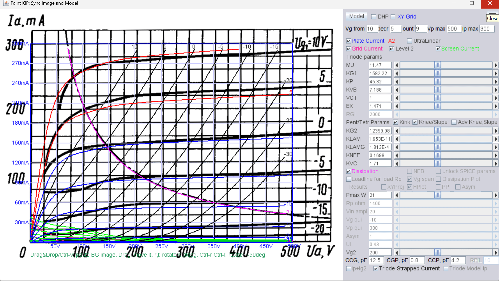

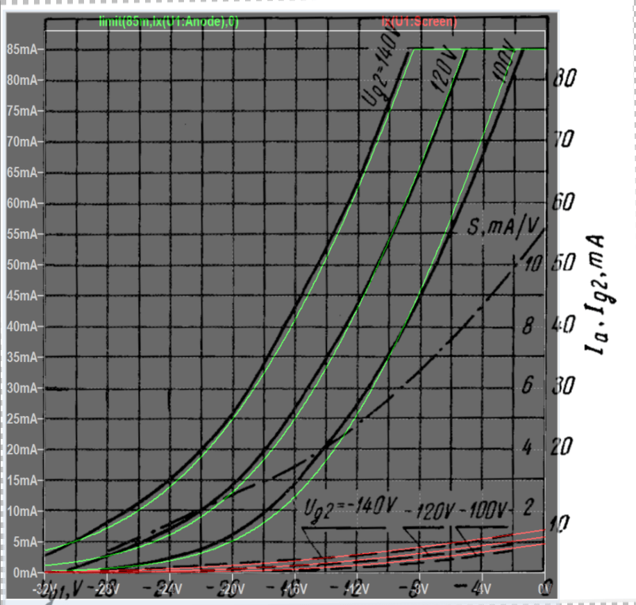

Here is GU-19 (ГУ-19) model:
Code:
**** GU_19 ******************************************
* Created on 10/24/2022 21:52 using paint_kip.jar
* Plate Curves image file: GU-19.png
*------------------------------------------------------------good1----------------------
.SUBCKT GU_19 P G2 G K ; LTSpice tetrode.asy pinout
* .SUBCKT GU_19 P G K G2 ; Koren Pentode Pspice pinout
+ PARAMS: MU=11.47 KG1=1582.22 KP=45.32 KVB=7.188 VCT=1 EX=1.471 KG2=12399.98 KNEE=0.1698 KVC=1.71
+ KLAM=1.953E-11 KLAMG=1.813E-4 KNEE2=39.46 KNEX=1137.6  KNK=0.03105 KNG=2.397E-4 KNPL=0.8299 KNSL=0.6589 KNPR=125.33 KNSR=40.45
+ CCG=12.5P CGP=0.8P CCP=4.2P VGOFF=-0.6 IGA=0.001 IGB=0.3 IGC=8 IGEX=2
* Vp_MAX=500 Ip_MAX=300 Vg_step=5 Vg_start=10 Vg_count=9
* X_MIN=78 Y_MIN=89 X_SIZE=672 Y_SIZE=509 FSZ_X=1296 FSZ_Y=736 XYGrid=true
* Rp=1400 Vg_ac=20 P_max=21 Vg_qui=-10 Vp_qui=300
* UL=0.43 EG2=200 gridLevel2=y addKink=y isTanhKnee=y advSigmoid=n
RE21 21 0 1
E21  21 0 VALUE={V(6)/KG1*ATAN((V(P,K)+KNEX)/KNEE)*TANH(V(P,K)/KNEE2)} ; Ip with knee but no slope and no kink
* Alexander Gurskii screen current, see audioXpress 2/2011, with slope and kink added
RE43 43 K 1G ; Dummy
E43  43 G2 VALUE={0} ; Dummy
G2   43 K  VALUE={V(6)/KG2*(KVC-ATAN((V(P,K)+KNEX)/KNEE)*TANH(V(P,K)/KNEE2))/(1+KLAMG*V(P,K))-V(22)}
RE23 G 0 1G
.ENDS

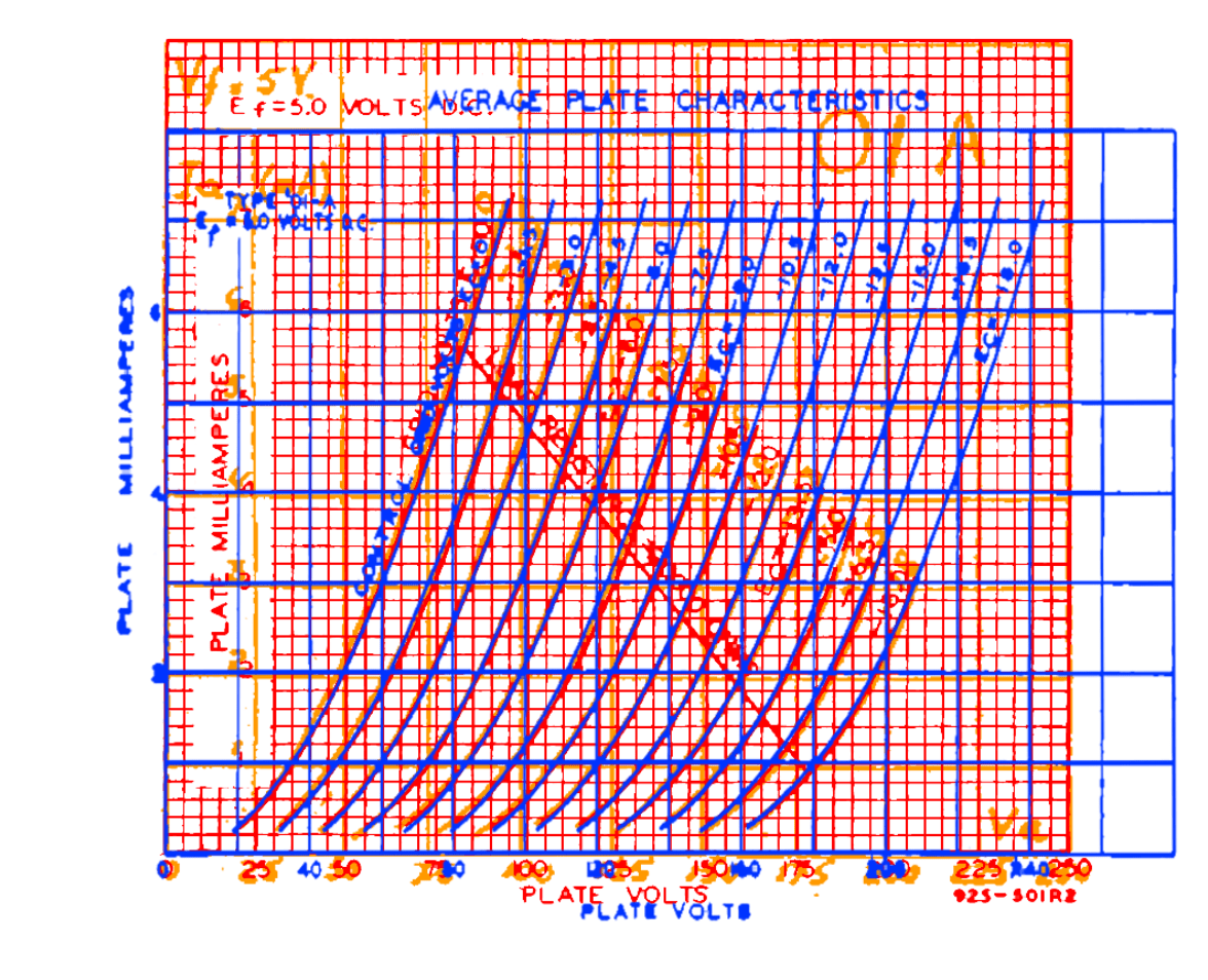

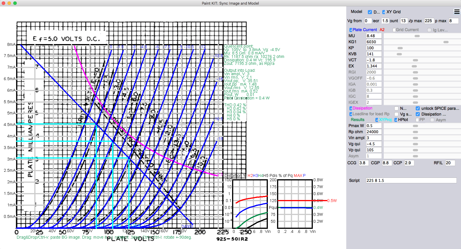

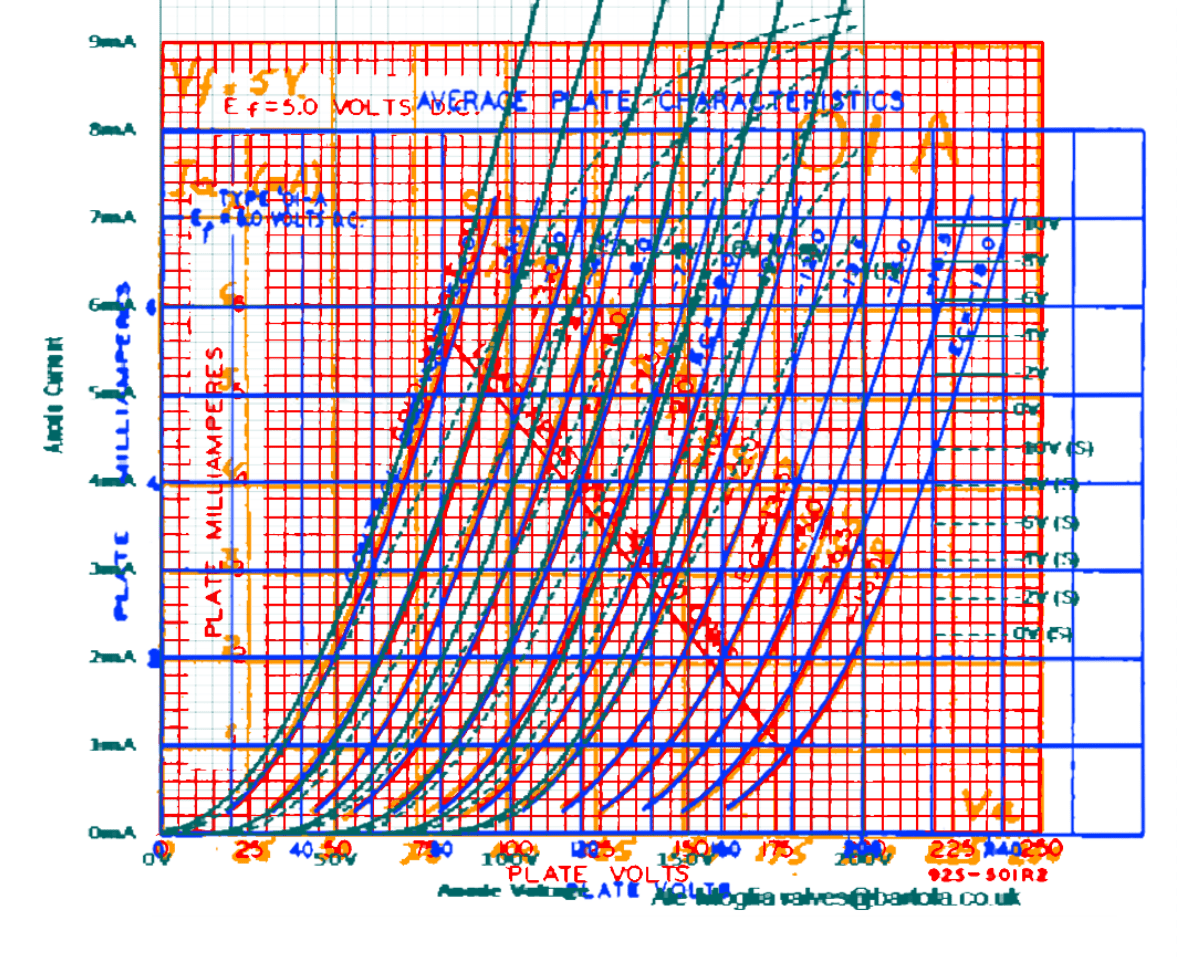

01A
all versions pspice model
I put together all anode curves from different manufacturers of the 01-A type small DH triode
And it seems that there are very little or no difference.
I add Bartola measured chrs for 301 type (note that 2V Ug step against the 1.5V step from other, that also fits very strongly.
sorry for the model TXT file missing some error occurred when closing java model extractor...
But the values of the parameters are visible
0.7pF added for each electrode for additional capacitance of the socket (Norman K. note)
cheers

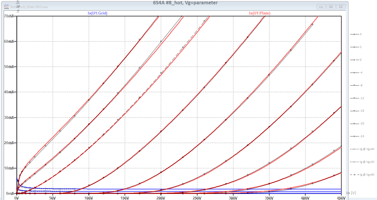

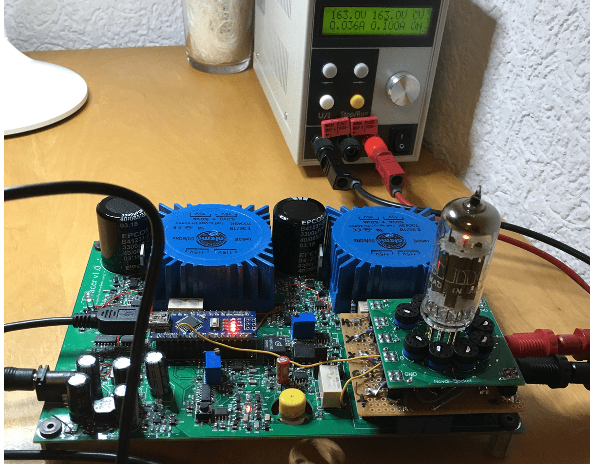

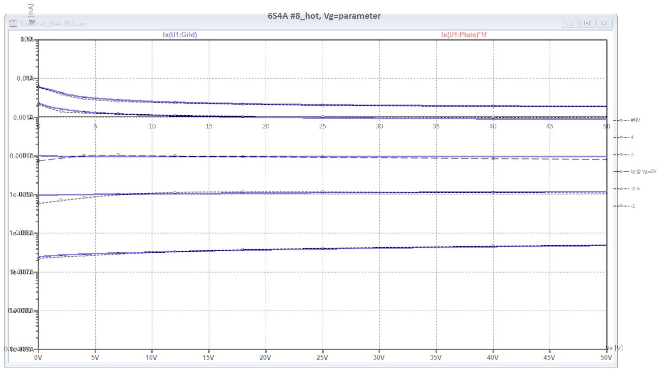

Hi all
Just note that I did an important enhancement to my iTracrer, to further improve my models accuracy. Like the famous uTracer, my iTracer applies pulses to the tube of interest, and measures the plate and grid currents during this pulses.
I got recently the hint, that this method has the drawback of a cold staying anode, while in practice, the anode is hot due to the losses. It depends on the tube construction whether this has any influence to the curves. The field is wide open, from "no influence" (=very good construction) to "20% different gm" (bad construction). Also, mu, Island effect and grid current can be influenced by the late losses.
I introduced now an enhancement with reed relays, switching the tube between iTracer (during the measurement pulses) and a DC power supply for a working point with about 70% of the maximum allowed plate losses. See picture!
A first tube I measured, the 6S4A, showed a gm redirection of 4% under hot plate conditions.
BR Adrian
Reactions: 1 user

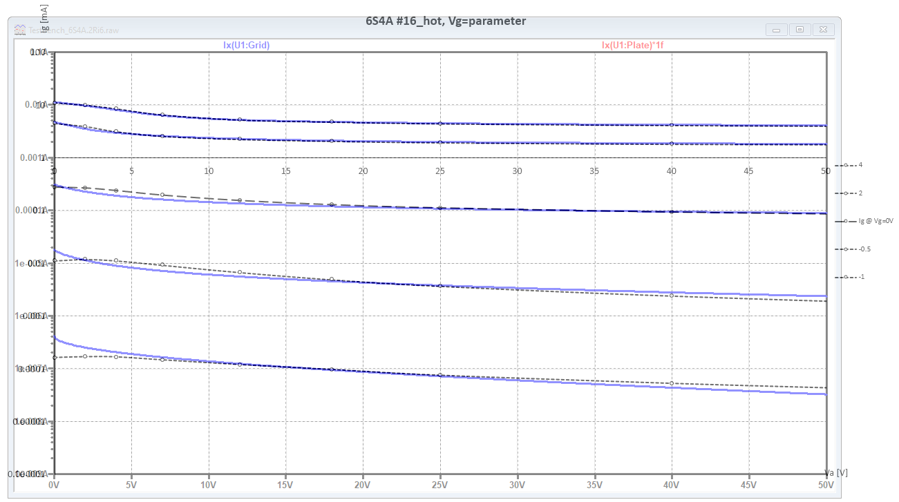

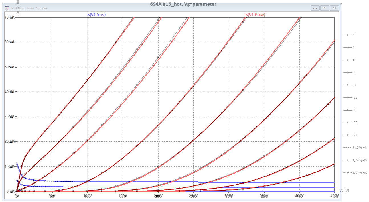

Hi all
Here it is, my first i6 spice model. The i6 version is actually an i5 version, but measured with hot plate. This way, it can be easily distinguished whether the tube was measured with cold or hot anode.
all the best,
Adrian

Disabled Account
Joined 2013
Sorry for delay, but finally here is 6p30b-r model:
Code:
**** 6P30B ******************************************
* Created on 11/10/2022 13:37 using paint_kip.jar
* Plate Curves image file: 6p30b.png
.SUBCKT 6P30B P G2 G K ; LTSpice tetrode.asy pinout
* .SUBCKT 6P30B P G K G2 ; Koren Pentode Pspice pinout
+ PARAMS: MU=6.837 KG1=773.95 KP=23.65 KVB=563.29 VCT=-0.2423 EX=1.148 KG2=1451.75 KNEE=94.96 KVC=1.751
+ KLAM=9.875E-9 KLAMG=0.001102  KD=3.623E-4 KC=94754.67 KR1=3153.92 KR2=0.025 KVBG=0.1002 KB1=7.012 KB2=0.00941 KB3=2.133 KB4=0.2661 KVBGI=0.1562 KNK=-151.04 KNG=0.01941 KNPL=1826.35 KNSL=245447.88 KNPR=1826.35 KNSR=12.71
+ CCG=12P CGP=0.6P CCP=4.2P VGOFF=-0.6 IGA=0.001 IGB=0.3 IGC=8 IGEX=1.64
* Vp_MAX=150 Ip_MAX=100 Vg_step=4 Vg_start=0 Vg_count=9
* X_MIN=90 Y_MIN=17 X_SIZE=620 Y_SIZE=649 FSZ_X=1296 FSZ_Y=736 XYGrid=true
* Rp=1400 Vg_ac=20 P_max=5.5 Vg_qui=-16 Vp_qui=300
* UL=0.43 EG2=120 gridLevel2=y addKink=y isTanhKnee=n advSigmoid=y
RE4  8 0  1
RE5 81 0  1
RE6 82 0  1
RE7 83 0  1
RE8  9 0  1
RE21 21 0 1
RE23 G 0 1G
.ENDS
Hi all
Here a further model of mine.
It is also 6S4A (as provided in #3445) but this time another construction, with 2 ribs (instead of 3) in the plate. This construction has in average a 13% larger gm, an 11% larger Mu and a more or less doubled grid current. Note that this version was quite stable regardless of plate losses, while the 3-ribs version showed a plateloss-dependent gm (-4% when hot). So, its worth to create different models for 6S4A, 2- and 3-ribs versions.
BR Adrian

*6S4A LTspice model based on the generic triode model from Adrian Immler, version i6
*A version log is at the end of this file
*100h BurnIn of 9 tubes, sample selection and measurements done in March 2022
*Params fitted to the measured values by Adrian Immler, November 2022
*This model is accurate for Vg up to 4V.
*The high fit quality is presented at adrianimmler.simplesite.com
*History's best of tube describing art (plus some new ideas) is merged to this new approach.
*@ neg. Vg, Ia accuracy is similar to Koren models, and unrivaled for remote cutoff triodes
*@ small neg. Vg, the "Anlauf" current is considered.
*@ pos. Vg, Ig and Ia accuracy is on an unrivaled level (including neg. Va range!)
*This offers new simulation possibilities like grid resistor bias, backward plate modulated stages,
*Audion radio circuits, low voltage amps, guitar distortion stages or pulsed stages.
*            2R = plate version with 2 ribs (there is also one with 3 ribs, with different curves)
*            | i6 version is identical to the i5, but measurements done with HOT anode for highest accuracy
