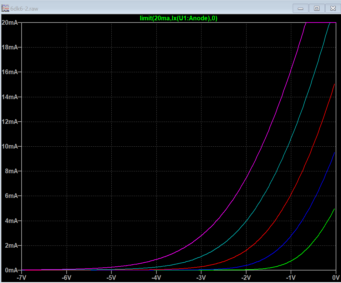

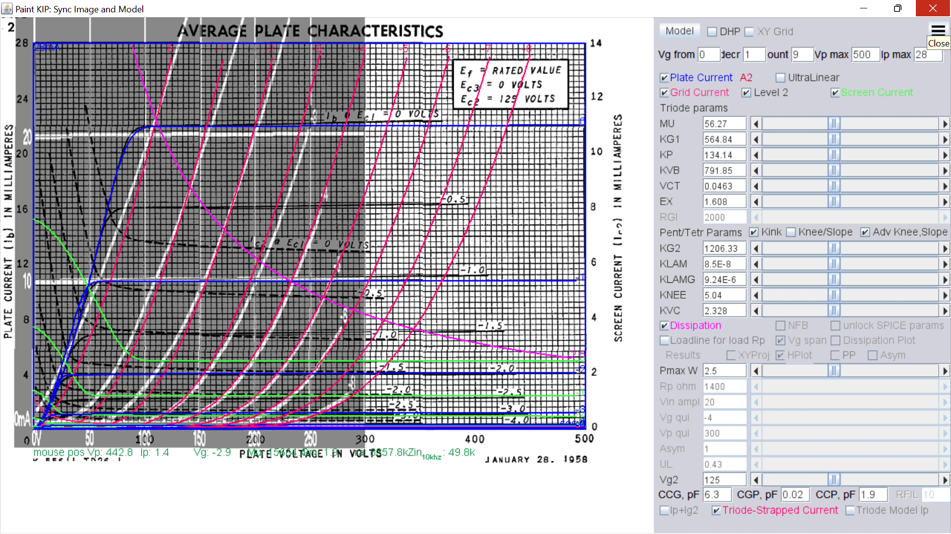

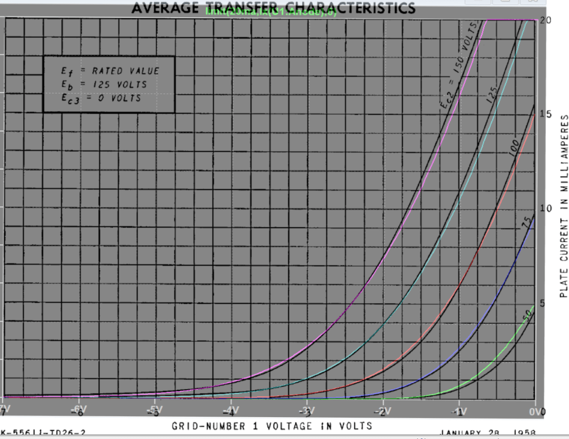

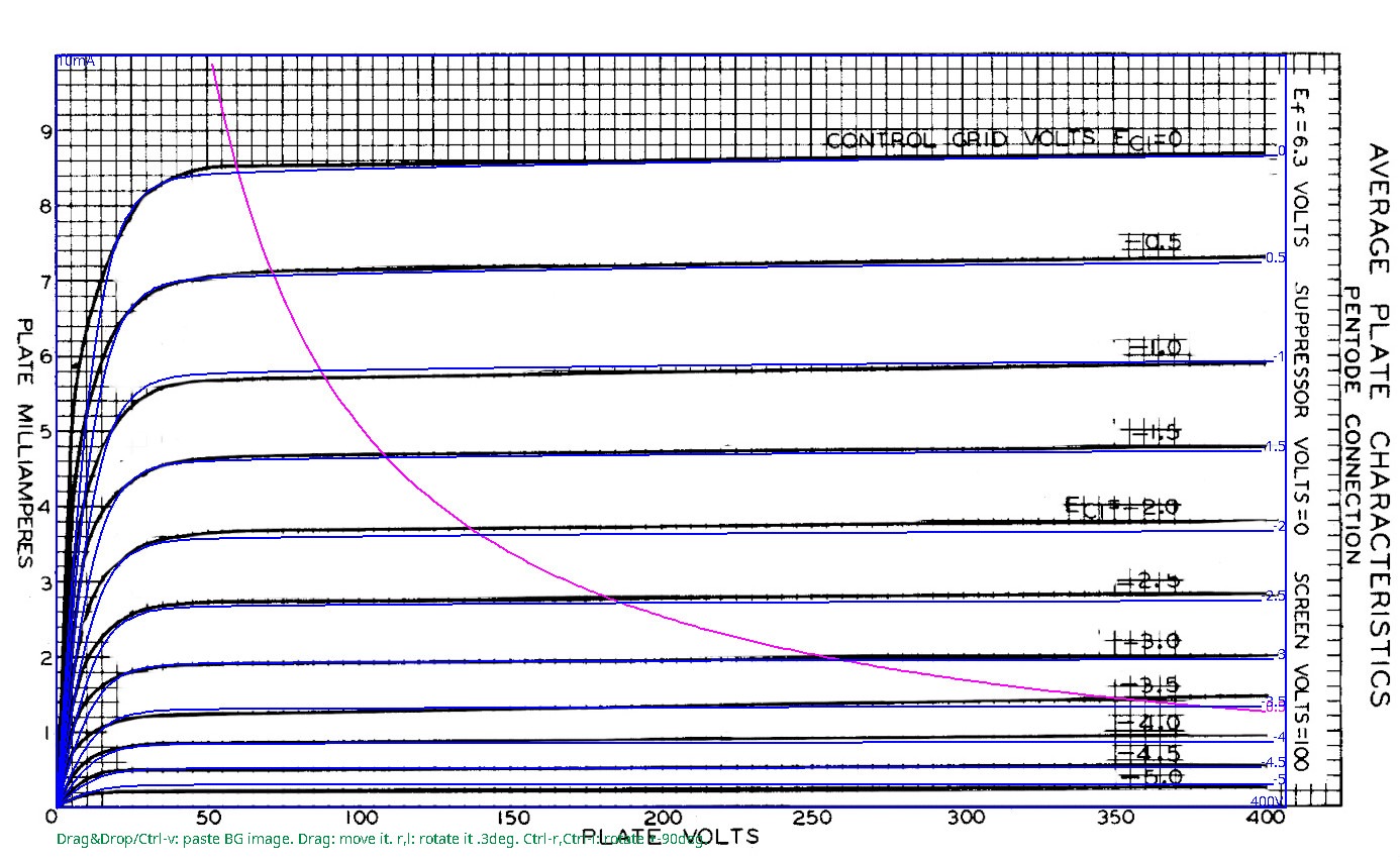

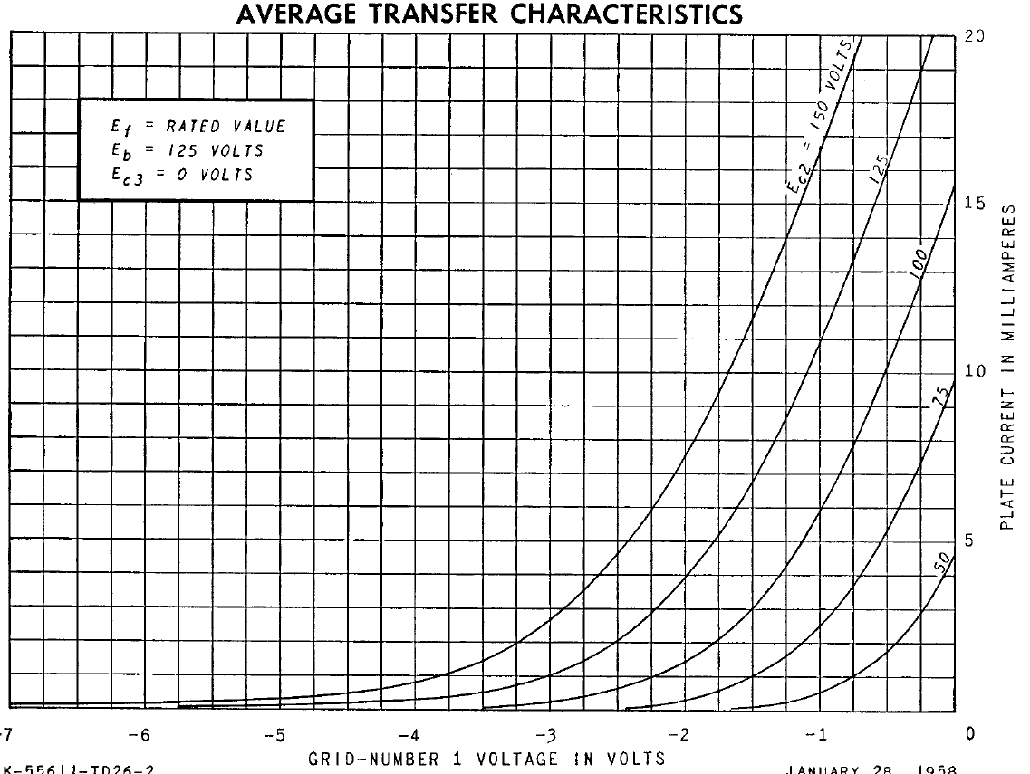

Here is GE 6DK6 (not typo for 6KD6) model:
Code:
**** 6DK6 ******************************************
* Created on 09/24/2022 17:22 using paint_kip.jar
* www.dmitrynizh.com/tubeparams_image.htm
* Plate Curves image file: 6dk6p.png
* Data source link: <plate curves URL>
*--------------------------------------------------------------posted--------------------
.SUBCKT 6DK6 P G2 G K ; LTSpice tetrode.asy pinout
* .SUBCKT 6DK6P P G K G2 ; Koren Pentode Pspice pinout
+ PARAMS: MU=56.27 KG1=564.84 KP=134.14 KVB=791.85 VCT=0.0463 EX=1.608 KG2=1206.33 KNEE=5.04 KVC=2.328
+ KLAM=8.5E-8 KLAMG=9.24E-6  KD=0.987 KC=4.318 KR1=0.01036 KR2=0.2806 KVBG=2.133 KB1=6.931 KB2=1.84 KB3=2 KB4=0.2279 KVBGI=2.512 KNK=-0.05576 KNG=0.04411 KNPL=0.3093 KNSL=0.001389 KNPR=9.6 KNSR=42.59
+ CCG=6.3P CGP=0.02P CCP=1.9P VGOFF=-0.6 IGA=0.001 IGB=0.3 IGC=8 IGEX=2
* Vp_MAX=500 Ip_MAX=28 Vg_step=1 Vg_start=0 Vg_count=9
* X_MIN=45 Y_MIN=35 X_SIZE=743 Y_SIZE=520 FSZ_X=1296 FSZ_Y=736 XYGrid=false
* Rp=1400 Vg_ac=20 P_max=2.5 Vg_qui=-4 Vp_qui=300
* showLoadLine=n showIp=y isDHP=n isPP=n isAsymPP=n isUL=n showDissipLimit=y
* showIg1=y isInputSnapped=y addLocalNFB=n
* XYProjections=n harmonicPlot=y dissipPlot=n
* UL=0.43 EG2=125 gridLevel2=y addKink=y isTanhKnee=n advSigmoid=y
RE1  7 0  1G    ; DUMMY SO NODE 7 HAS 2 CONNECTIONS
E1   7 0  VALUE=  ; E1 BREAKS UP LONG EQUATION FOR G1.
+{V(G2,K)/KP*LOG(1+EXP((1/MU+(VCT+V(G,K))/SQRT(KVB+V(G2,K)*V(G2,K)))*KP))}
RE2  6 0  1G    ; DUMMY SO NODE 6 HAS 2 CONNECTIONS
E2  6 0  VALUE={(PWR(V(7),EX)+PWRS(V(7),EX))} ; Kg1 times KIT current
E4   8 0  VALUE={V(P,K)/KNEE/(KVBGI+V(6)*KVBG)}
E5  81 0  VALUE={PWR(V(8),KB1)}
E6  82 0  VALUE={PWR(V(8),KB2)}
E7  83 0  VALUE={PWR(V(8),KB3)}
E8   9 0  VALUE={PWR(1-EXP(-V(81)*(KC+KR1*V(82))/(KD+KR2*V(83))),KB4)*1.5708}
RE4  8 0  1
RE5 81 0  1
RE6 82 0  1
RE7 83 0  1
RE8  9 0  1
RE21 21 0 1
E21  21 0 VALUE={V(6)/KG1*V(9)} ; Ip with knee but no slope and no kink
RE22 22 0 1 ; E22: kink curr deviation for plate
E22  22 0 VALUE={V(21)*LIMIT(KNK-V(G,K)*KNG,0,0.3)*(-ATAN((V(P,K)-KNPL)/KNSL)+ATAN((V(P,K)-KNPR)/KNSR))}
G1   P K  VALUE={V(21)*(1+KLAMG*V(P,K))+KLAM*V(P,K) + V(22)}
G2   G2 K  VALUE={V(6)/KG2*(KVC-V(9))/(1+KLAMG*V(P,K)) - V(22)}
RCP  P K  1G     ; FOR CONVERGENCE
C1   K G  {CCG}  ; CATHODE-GRID 1
C2   G P  {CGP}  ; GRID 1-PLATE
C3   K P  {CCP}  ; CATHODE-PLATE
RE23 G 0 1G
GG G K VALUE={(IGA+IGB/(IGC+V(P,K)))*(MU/KG1)*
+(PWR(V(G,K)-VGOFF,IGEX)+PWRS(V(G,K)-VGOFF,IGEX))}
.ENDS
  • 6dk6 hp.asc
Reactions: 1 user

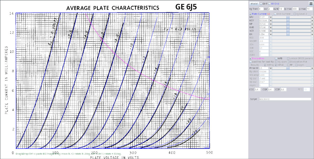

GE 6J5 triode
** 6J5 ****************************************
.SUBCKT TRIODE_6J5 1 2 3 ; Plate Grid Cathode
  • PARAMS: CCG=3.4P CGP=3.4P CCP=3.6P RGI=2000
  • MU=21.27 KG1=1513.04 KP=157.42 KVB=572.06 VCT=0.1698 EX=1.354
  • Vp_MAX=500 Ip_MAX=14 Vg_step=2 Vg_start=0 Vg_count=13
  • Rp=156288 Vg_ac=3.065 P_max=2.5 Vg_qui=-7.446 Vp_qui=214.7
  • X_MIN=95 Y_MIN=76 X_SIZE=1184 Y_SIZE=831 FSZ_X=1918 FSZ_Y=996 XYGrid=false
  • showLoadLine=n showIp=y isDHT=n isPP=n isAsymPP=n showDissipLimit=y
  • showIg1=n gridLevel2=n isInputSnapped=n
  • XYProjections=y harmonicPlot=y dissipPlot=n
E1 7 0 VALUE={V(1,3)/KP*LOG(1+EXP(KP*(1/MU+(VCT+V(2,3))/SQRT(KVB+V(1,3)*V(1,3)))))}
RE1 7 0 1G ; TO AVOID FLOATING NODES
G1 1 3 VALUE={(PWR(V(7),EX)+PWRS(V(7),EX))/KG1}
RCP 1 3 1G ; TO AVOID FLOATING NODES
C1 2 3 {CCG} ; CATHODE-GRID
C2 2 1 {CGP} ; GRID=PLATE
C3 1 3 {CCP} ; CATHODE-PLATE
D3 5 3 DX ; POSITIVE GRID CURRENT
R1 2 5 {RGI} ; POSITIVE GRID CURRENT
.MODEL DX D(IS=1N RS=1 CJO=10PF TT=1N)
.ENDS

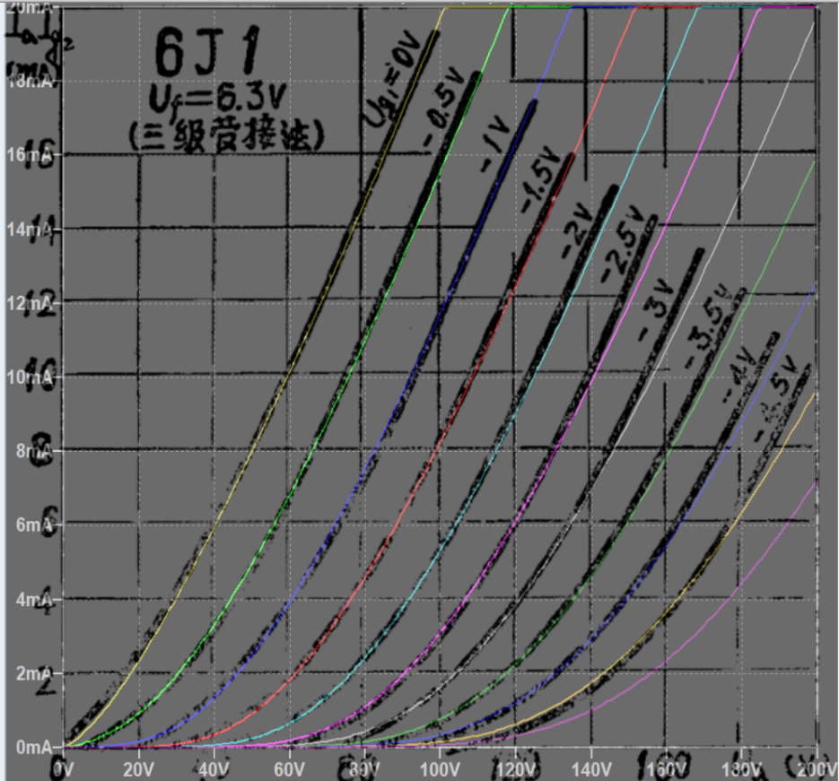

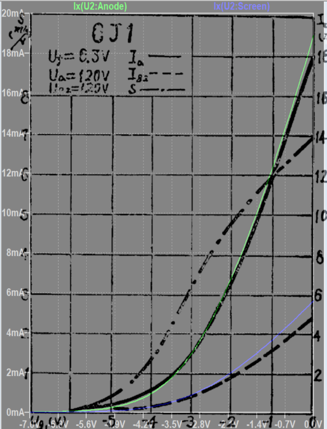

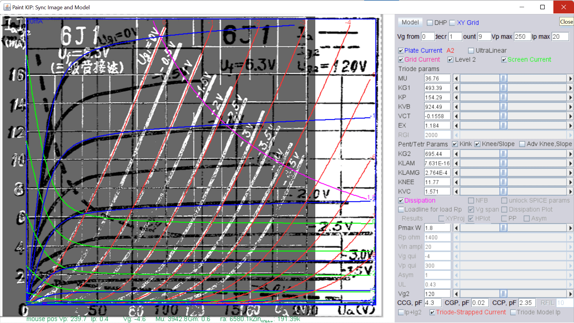

6J1 pentode model:
Code:
*** 6J1_P *********************************good2*********
* Created on 10/07/2022 22:25 using paint_kip.jar
* Plate Curves image file: 6j1-p.png
.SUBCKT 6J1_P P G2 G K ; LTSpice tetrode.asy pinout
* .SUBCKT 6J1_P P G K G2 ; Koren Pentode Pspice pinout
+ PARAMS: MU=36.76 KG1=493.39 KP=154.29 KVB=924.49 VCT=-0.1558 EX=1.184 KG2=695.44 KNEE=11.77 KVC=1.571
+ KLAM=7.631E-16 KLAMG=2.764E-4 KNEE2=14.95 KNEX=22.06  KNK=0.7192 KNG=0.07263 KNPL=0.2412 KNSL=572.38 KNPR=456.84 KNSR=629.57
+ CCG=4.3P CGP=0.02P CCP=2.35P VGOFF=-0.2475 IGA=6.2E-4 IGB=0.195 IGC=7.6 IGEX=2
* Vp_MAX=250 Ip_MAX=20 Vg_step=1 Vg_start=0 Vg_count=9
* X_MIN=59 Y_MIN=11 X_SIZE=779 Y_SIZE=637 FSZ_X=1296 FSZ_Y=736 XYGrid=false
* Rp=1400 Vg_ac=20 P_max=1.8 Vg_qui=-4 Vp_qui=300
* UL=0.43 EG2=120 gridLevel2=y addKink=y isTanhKnee=y advSigmoid=n
RE21 21 0 1
E21  21 0 VALUE={V(6)/KG1*ATAN((V(P,K)+KNEX)/KNEE)*TANH(V(P,K)/KNEE2)} ; Ip with knee but no slope and no kink
* Alexander Gurskii screen current, see audioXpress 2/2011, with slope and kink added
RE43 43 K 1G ; Dummy
E43  43 G2 VALUE={0} ; Dummy
G2   43 K  VALUE={V(6)/KG2*(KVC-ATAN((V(P,K)+KNEX)/KNEE)*TANH(V(P,K)/KNEE2))/(1+KLAMG*V(P,K))-V(22)}
RE23 G 0 1G
.ENDS

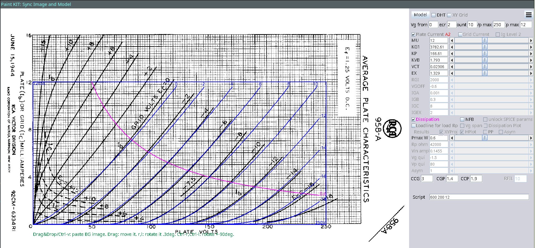

RCA 958A, a DHT acorn.
** 958A ****************************************
.SUBCKT TRIODE_958A 1 2 3 ; Plate Grid Cathode
  • PARAMS: CCG=3P CGP=1.4P CCP=1.9P RGI=2000
  • MU=12 KG1=3782.61 KP=166.61 KVB=1.793 VCT=0.02306 EX=1.329
  • Vp_MAX=250 Ip_MAX=12 Vg_step=2 Vg_start=0 Vg_count=10
  • Rp=31500 Vg_ac=0.0927 P_max=0.6 Vg_qui=-1.62 Vp_qui=83.11
  • X_MIN=104 Y_MIN=235 X_SIZE=940 Y_SIZE=457 FSZ_X=1918 FSZ_Y=863 XYGrid=false
.ENDS

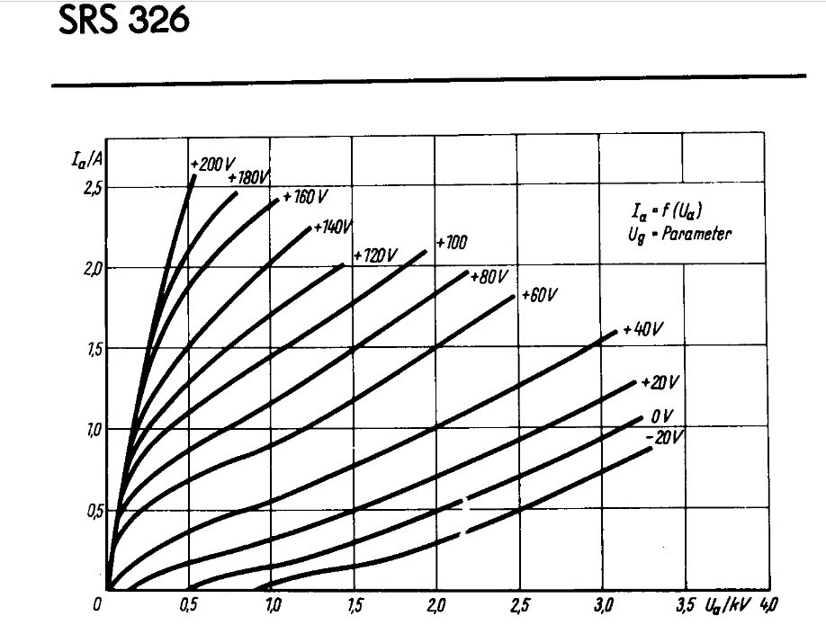

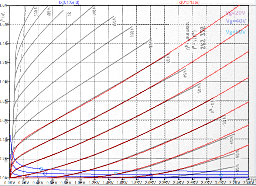

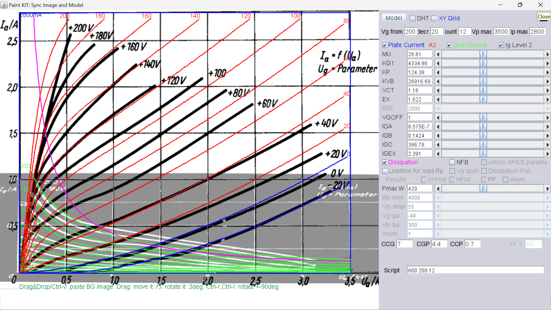

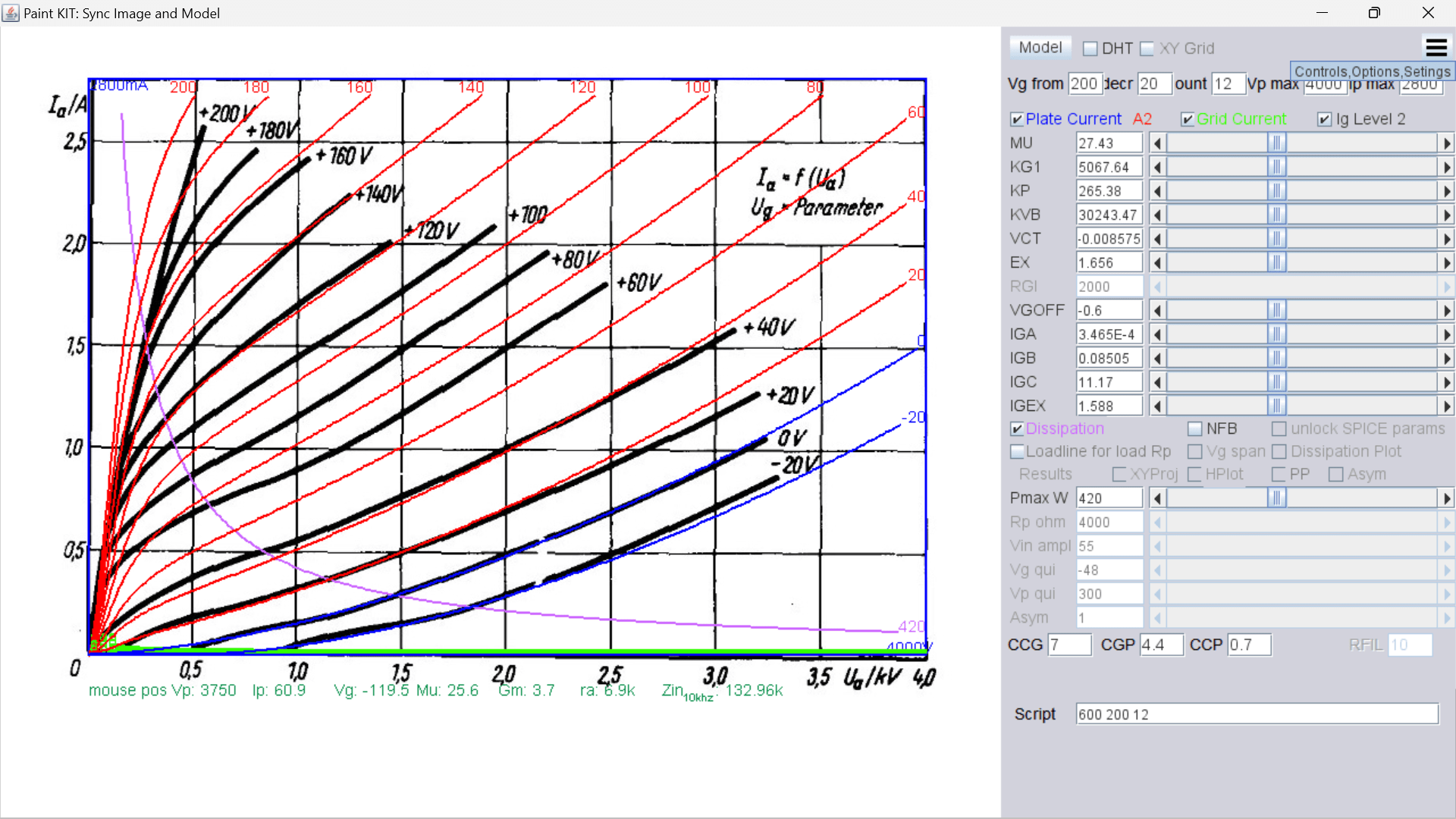

Try this SRS326 model:
Code:
**** SRS326 ** Advanced Grid Current ********************8**************
* Created on 10/14/2022 11:05 using paint_kit.jar 3.1
* Plate Curves image file: SRS326.jpg
* Data source link:
.SUBCKT SRS326 1 2 3 ; Plate Grid Cathode
+ PARAMS: CCG=7P  CGP=4.4P CCP=0.7P
+ MU=27.43 KG1=5067.64 KP=265.38 KVB=30243.47 VCT=-0.008575 EX=1.656
+ VGOFF=-0.6 IGA=3.465E-4 IGB=0.08505 IGC=11.17 IGEX=1.588
* Vp_MAX=4000 Ip_MAX=2800 Vg_step=20 Vg_start=200 Vg_count=12
* Rp=4000 Vg_ac=55 P_max=420 Vg_qui=-48 Vp_qui=300

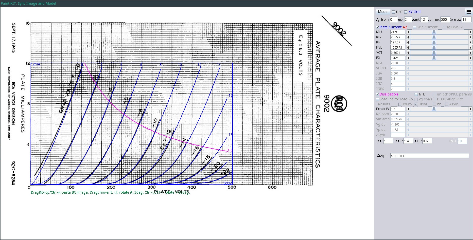

An alternate model for the 9002/955. Ayumi's version acted odd for me which may have been at this end. The SUBCKT name is 9002_rdf to separate it from earlier posts.

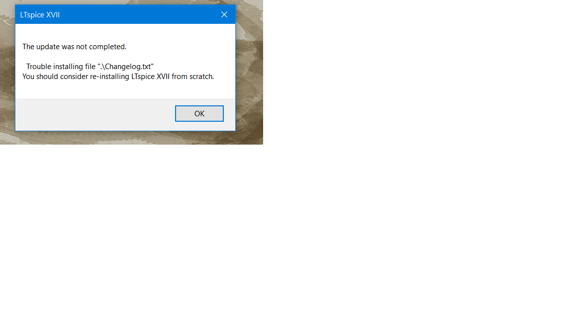

My Win10 hiccups when I run the latest LTspice program. Tried copying the tube directory to no avail. Win banner keeps arriving at a files load point "cannot update. abort and re-update". What am I doing incorrct ? I cannot count the number of times I´ve been though this process.
Anyone give any tips ?
ric
I think by default, LTspice tries to create the \lib\ folder in \Program Files X86\. However, that is a protected folder, and you may have trouble writing to it. What I do is, during installation, tell LTspice to create the \lib\ folder in \Documents\. I also put my \LTspice Projects\ folder under \Documents\. That way there's no trouble with permissions to write to those folders. I hope that helps.
On my system LTspice XVII also created that same directory structure under the My Documents folder so that there would be so privileges issues. A clean install did not create any folders under Program File X86. However, it did duplicate the directory structure in the 64-bit Program Files folder since I installed the 64-bit version.
I had a similar problem similar to Rich once, and I fixed it by uninstalling and reinstalling, with deleting the contents of the files under the My Documents directory structure before reinstalling. I suspect that there were some corrupted files and the updater was not able to overwrite them, but this is just a guess.
I have a "User" folder under \lib\sub and \lib\sym for my user-installed models and symbols respectively so I was able to delete everything else without throwing away my own models and symbols. But if you have your own files stored in the same directories as the built-in files you will probably not be able to do this. Just a caution.
Thanks for all replies; I will attack this by completely opening a new folder in c: program files but firstly have to make sure and delete any previous Spice file clones involving Onedrive, which for me has been a creator of other issues.. I also wondered if any tube models also simulate B9A pentode strapped as triode analysis, as this is one of my favourites.

Well, tried most of the recommendations and this is the log jam I continually get. see pic
Although I´m running Win10 Home Ed 21H2 on an Acer Aspire, I´ve had loads of issues with Windows 10, refreshed it countless times and continues to be unreliable. The annoyance of having to reload that Spice version takes a good 1/4 hr on copper, even though I prioritize the uploads to another time.

Best bet is to try another simulation program from another vendor that is less demanding for Win10, but there must be loads out there running Spice quite successfully. I can´t believe it´s the upload speed that creates problem issues.
rich
Disabled Account
Joined 2013
To update LTSpice just click on "Tools->Sync release", so you do that as many times as quickly as you can. I update just now only a few mins, below is Changelog.txt Maybe you can tell where are the incomplete modules and do further investigations.
PS just share that CPU usage is something to watch out, of course it's not the cause to your problem.
I got a problem before when writing to maybe corrupted Pen drive for sim files which becomes Write Protected by the system. I reformat the pen drive it can now write files to it.
