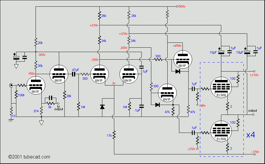

Hi Alastair E, some time ago I read on Tube CAD website about EL509 OTL version but with different driver tubes...I saved a picture of tubecad design of EL509 driven by 6N1P - maybe helps to try out...
Max
