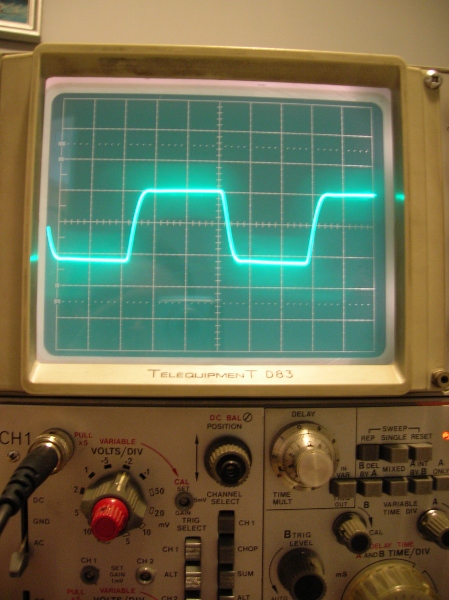

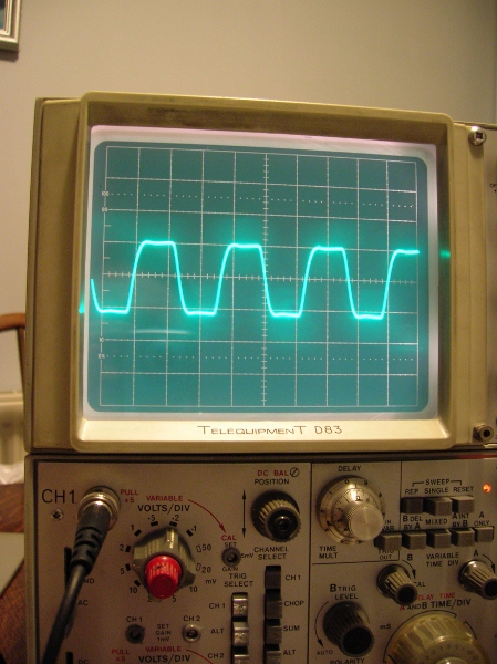

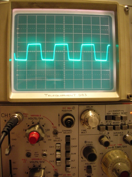

10khz..square wave.

Well, Thats all pretty interesting!
I really should get my scope out and do some tests too. It would be interesting to see where the onset of distortion is actually happening above 8W, whether in the driver or the O/P stage...
--Have to open the FB loop to do that though, and alter I/P level accordingly...
To sharpen up the square-waves, it may be worth dropping the value of the PI grid-coupling resistor to 100K, (or just link it out) in view of what a previous poster mentioned concerning the Miller capacitance of that stage....
Worth trying anyway, see if it makes a difference...

Hi Alastair , in previous post I talked about input capacitance only , because the phase spliter didn't make any amplification , its a unity gain and therefore it haven't any Miller capacitances .

Dimitris AR,
Just asking because of your previous post...
Looking at the square wave do you think the 470K on the phase splitter/driver is responsible for the slight slope?
Or coupling capacitor issue?
Regards
M. Gregg

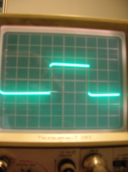

Yes of course , because this resistance reducing the high frequency response of the amp , and this is visible in the 10 Khz square wave . The shape of the square 10Khz and 20khz tell as a lot about the frequency response , it must looking as good as a square .
